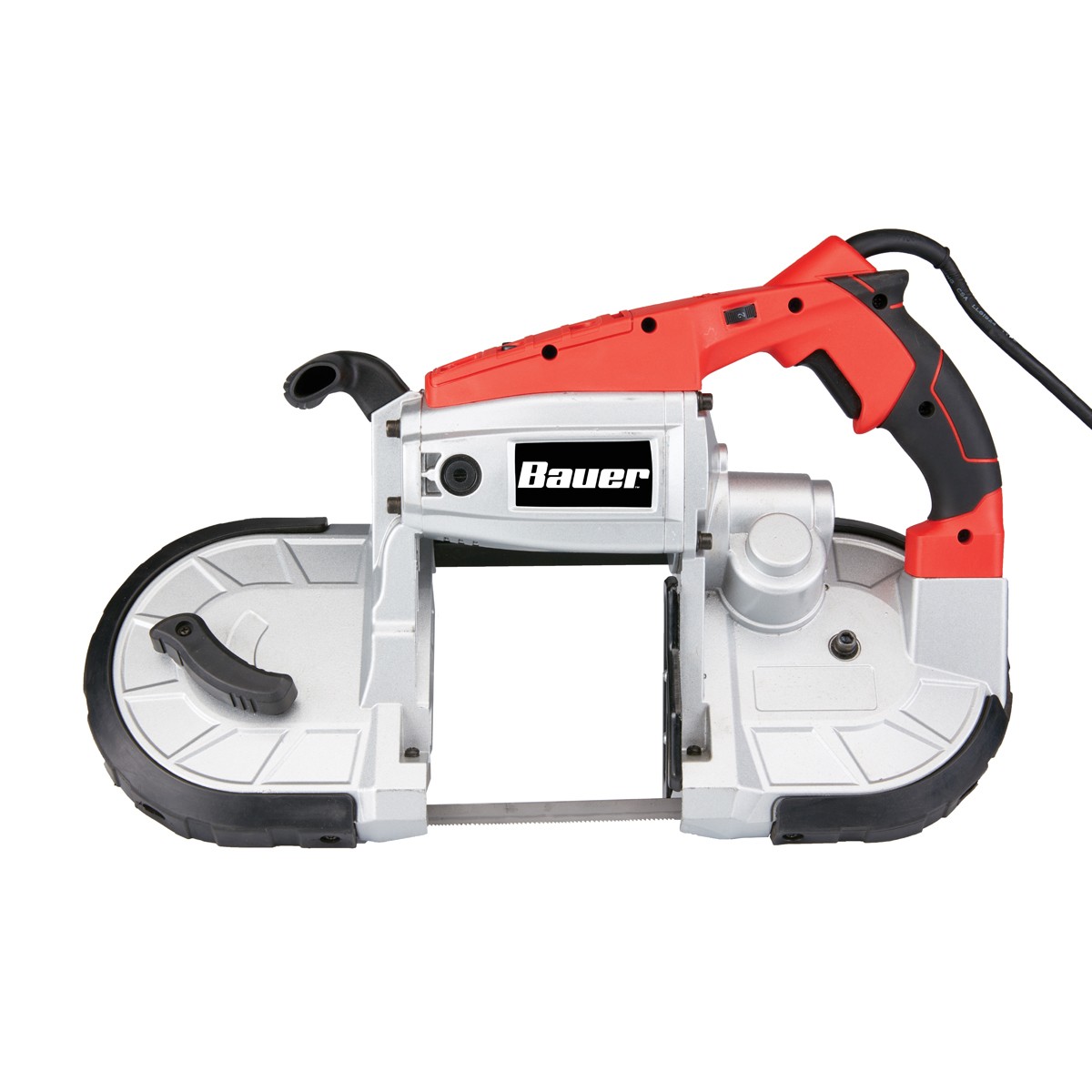

Just picked up one of these today.. For $99 after coupon, I figured I couldn't go too wrong..
1 Amp Deep Cut Variable Speed Band Saw Kit

What is that used for?
Excellent for cutting steel in the field or in a non specialized workshop. Can be attached to a small bench to make a precision metal band saw. Very useful for cutting pipe which is what they were developed to do.

Now you need to make a table for it like swag offroad sells. My portaband with the table is one of my most used metal fabricating toola.
Or, he can just buy one of the Swag tables. I have one for my Milwaukee portaband and it, with a miter gauge, is a very useful addition. Not quite the same as what you'd find in a dedicated metalworking shop but WAY more useful than just a hacksaw or chopsaw. SWAG Portaband Tables
You can make your own for under $30.
If you have precision bending, cutting and drilling tools. I'm sure a simple version could be put together but fabricating a precision table with miter gauge slot is not an afternoon project. I think the simple SWAG table that clamps into a vise only costs about $50 and the versions that include legs and the miter gauge slot go for about $130 or so. Still pretty cheap money compared to what a real metal bandsaw costs. SWAG does a nice job with CAD designed and laser or water metal cutting systems. They seem to specialize in upgrades to HF products too so anyone who does metal working with HF tools should be aware of SWAGoffroad.com.
