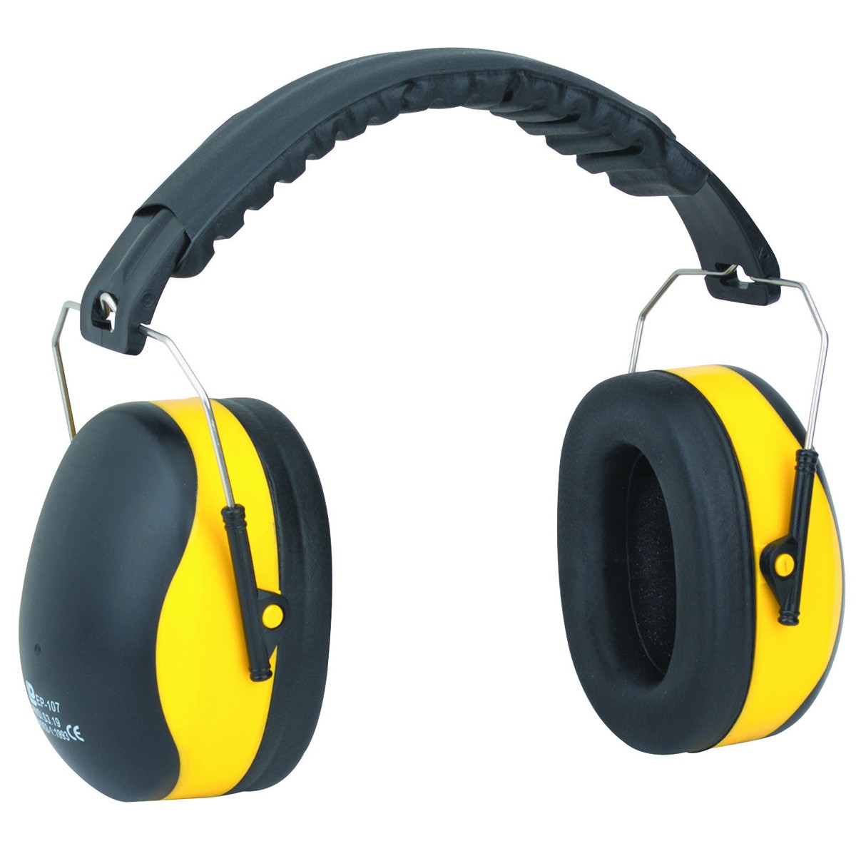

These: Hearing Protector
They have a NRR [Noise Reduction Rating] of 25 dB, which I believe is accurate in comparison with other ear protection I have used.
They work great at the range, chop saw, splitter, etc- and where/which ever I am going to be working on, my nearest pair is nowhere to be found.

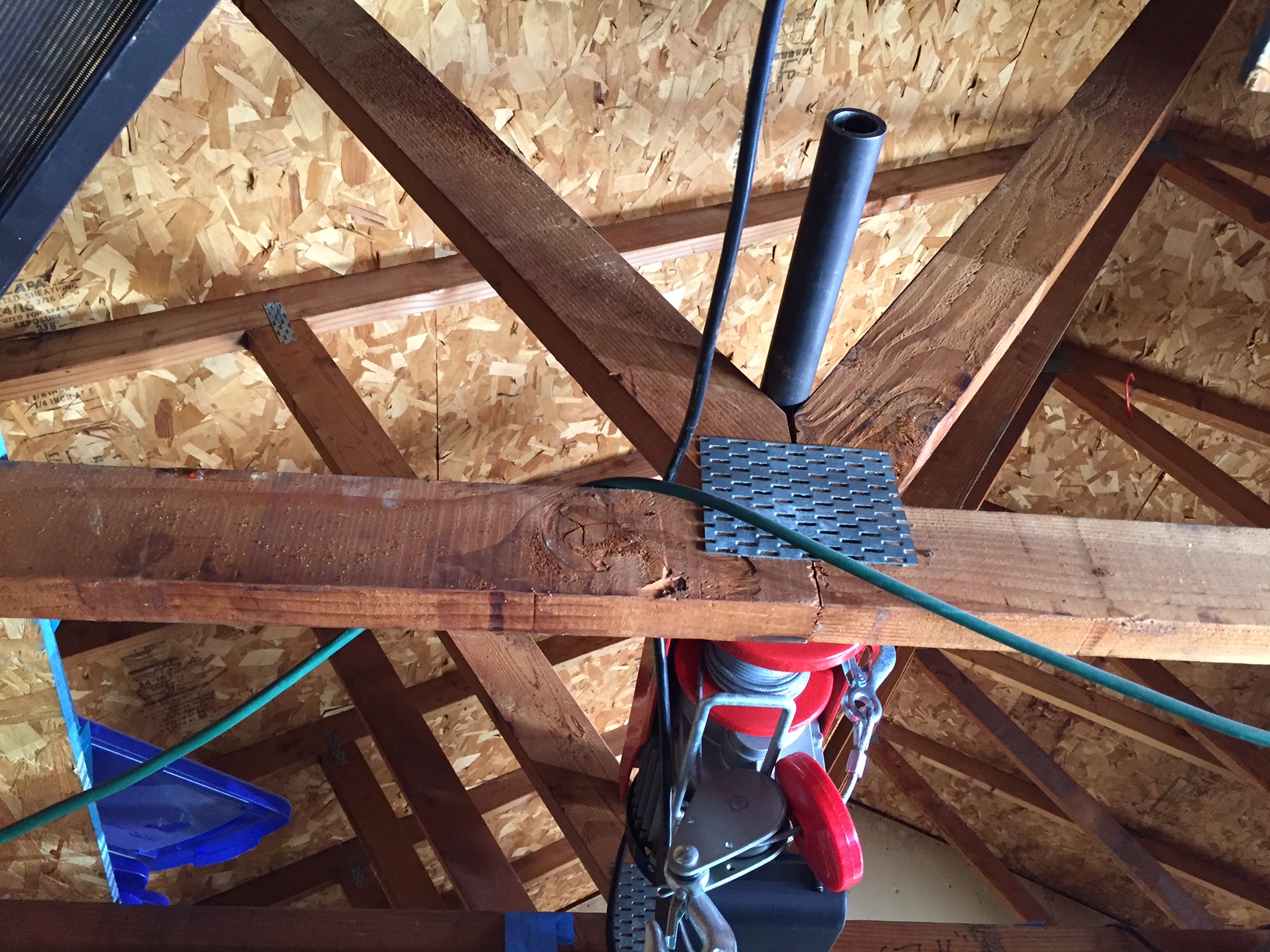

If you don't mind my asking: How do you have that mounted overhead?
I have thought about getting an I-beam mounted to use one of those on a trolley, but I can see a lot of times when a stationary vertical lift would be all I needed.
I'm just always concerned about vertical loading on the horizontal struts which are after all only suspended by those perforated metal panels at the ends and joints, and I'm not engineering savvy enough to calculate what the maximum safe load would be...
I mounted mine in a pole barn that has trusses on 8' centers. I added 2 2x6 that were 12' long resting, on edge, across 2 bottom chords. I think they are about 2' apart. I then added 2 short 2x6's about 2' apart that tie the 2 12'ers together and form a 2'x2' box. I use that box to house my winch up high and out of the way. A simple bar/uni/2x2 or whatever the winch calls for is all that is needed, resting that on top of that 2x6 box, to hang the winch in there. It works great for me. (on edit, I might have used 2x8's instead of 2x6's for that frame)

I put a piece of steel tube in the web angle of two trusses, and hung the hoist on that. So the lift is directly supported by elements of two trusses. I figure if full size carpenters can walk out on the chord during construction, this should be ok for moderate concentrated loads. The heaviest I have lifted was 250 lbs. A 5/8" drywall ceiling pulls downwards on those bottom chords and pulls straight down on those steel plates, they are pretty strong.
