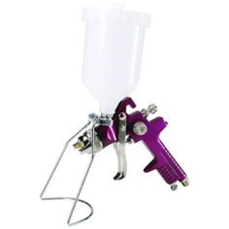

Here are the paint cups and wire stand. These are a must so get two packs of cups. Don't use the screw-in adaptor. Mine leaked so just screw the paint cup onto gun.
5 Piece Air Spray Gun Disposable Paint Cups
The paint gun stand I like looks like this below but I can't find on the net right now. It's in the store.
You also could use some HF paint filters, especially if you store partial cans. I have but don't use very often. You'll need a metric hex wrench to put the stand on and remove for cleaning and a toothbrush. You should also have a water trap on your compressor. Set your gun pressure with the trigger pulled and air flowing on a cleaned gun.

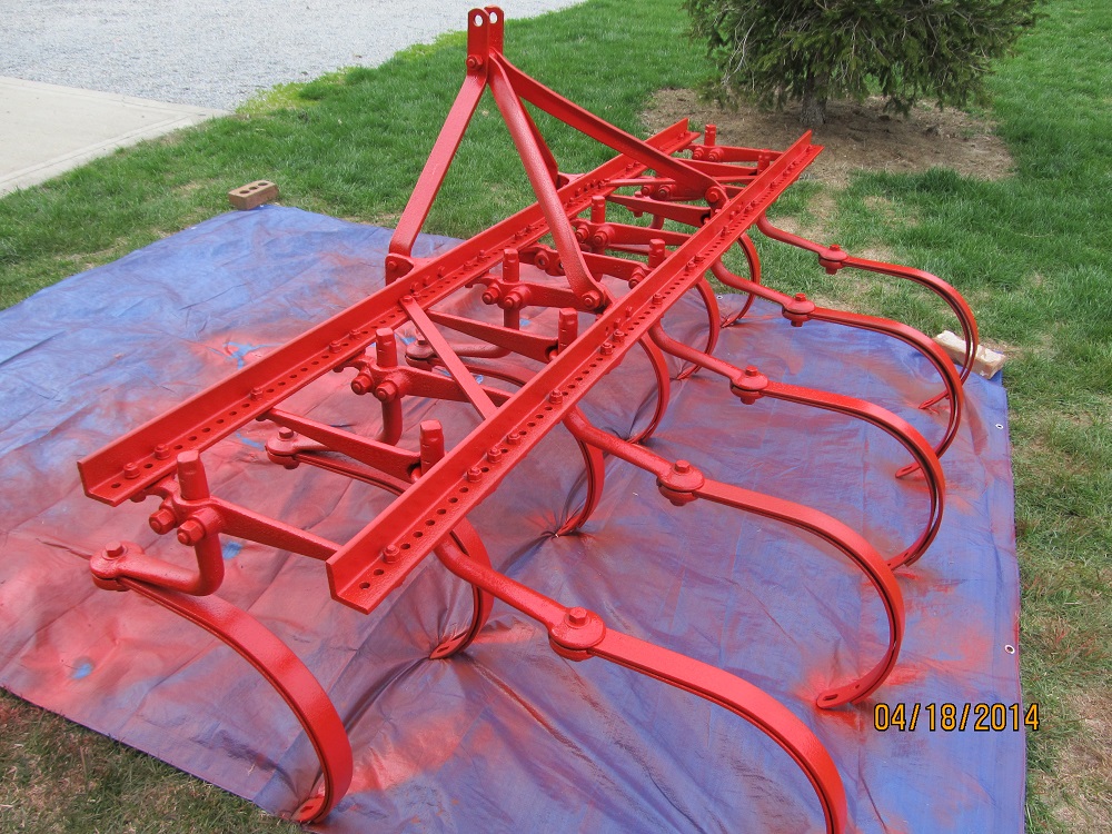

Here is a lo-buck Harbor Freight paint gun job with OEM acrylic enamel paint.
How's that for "pop"? Here's the thread.
http://www.tractorbynet.com/forums/attachments/312434-1950s-dearborn-cultivator-find-rebuild.html
There are a number of threads I have done like this. Search for more if you care.
Anyway, have fun and post pictures. I've done this for decades and the HF HVLP paint gun is among the best there is, especially for the price. It's a fine reward to restore something to a respectable facsimile of it's original state.
