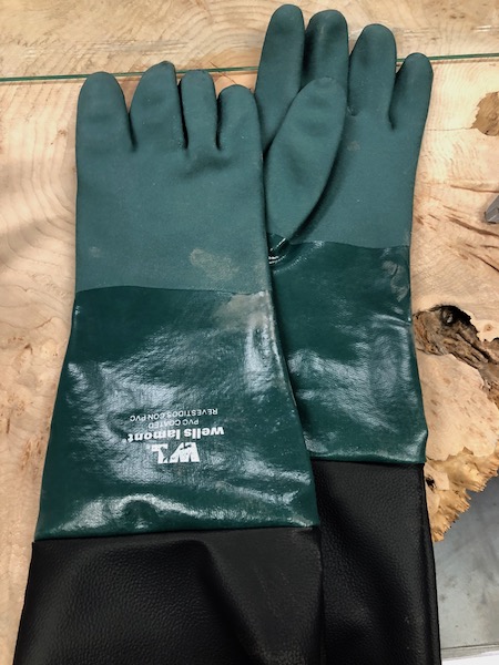

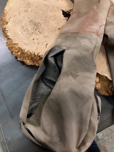

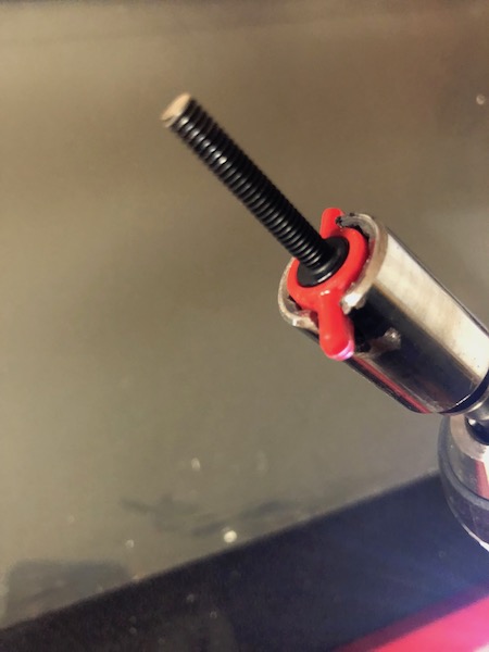

I have heavily modded my cabinet but one of the items that didn't get an upgrade until now were the gloves. They do suck! They split pretty early in the use cycle and I have been using duct tape with not great luck to hold them together. Replaced the originals with new ones from the Tacoma Company. Highly recommend them if you want to turn your HF cabinet into a first class machine.
View attachment 545924 View attachment 545927

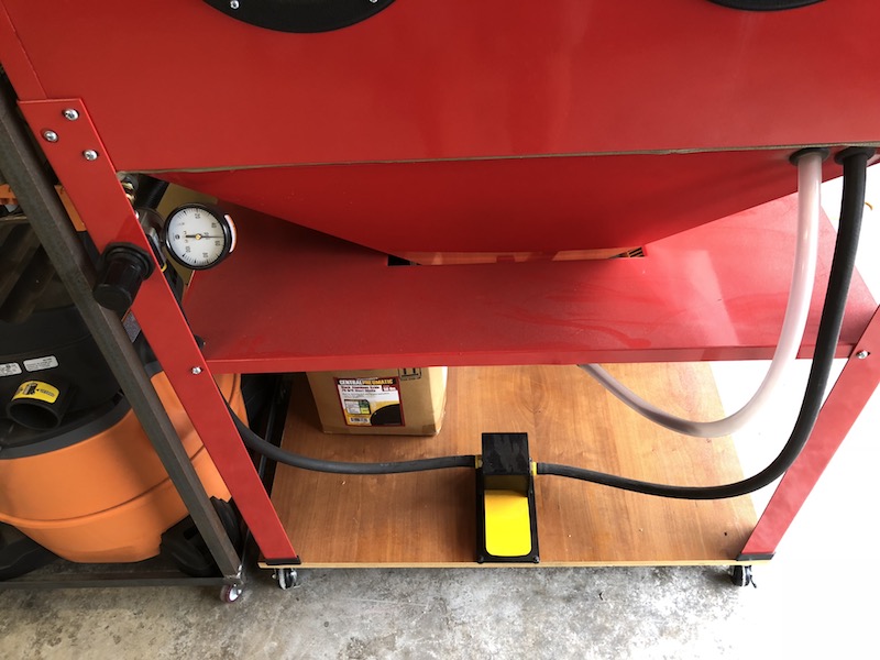

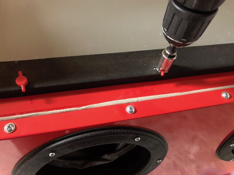

As I said, lots of mods but I learned pretty quick that it is nice to have quick access to the whole insides of the cabinet so I got so I modified a socket... View attachment 545926 View attachment 545925

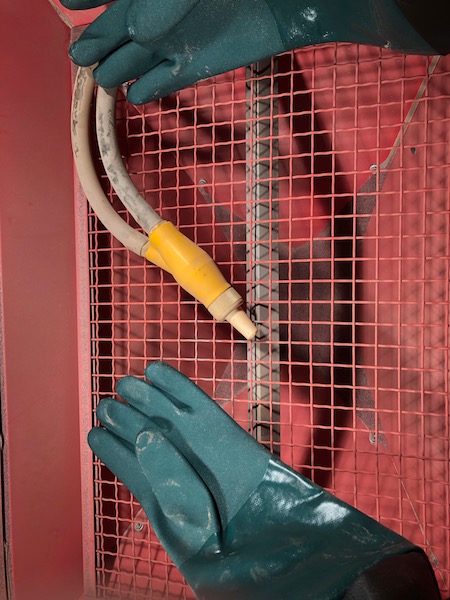

New gloves installed and a peek at some other sweet upgrades from Tacoma Company...
View attachment 545928 View attachment 545929

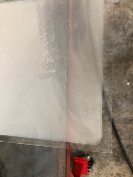

Thought I had another spare pane of glass. But I guess not. :smiley_aafz: So another trip to HD before I button this up.
To extend the life of the glass try black window bug screen spaced about 1/4" from the glass. The media will bounce off of the screen but you still have a decent view of your work and it will save the glass.
   / Harbor Freight Tools that don't suck #8,802
Thanks for the tip! I go through single weight glass far more than I had hoped.
