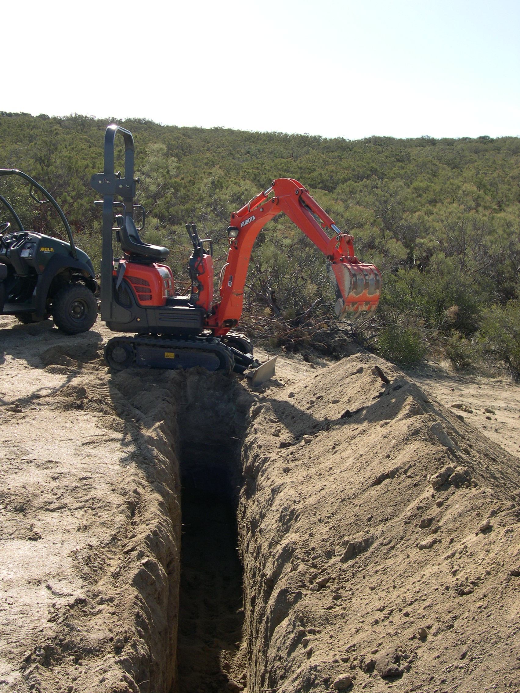

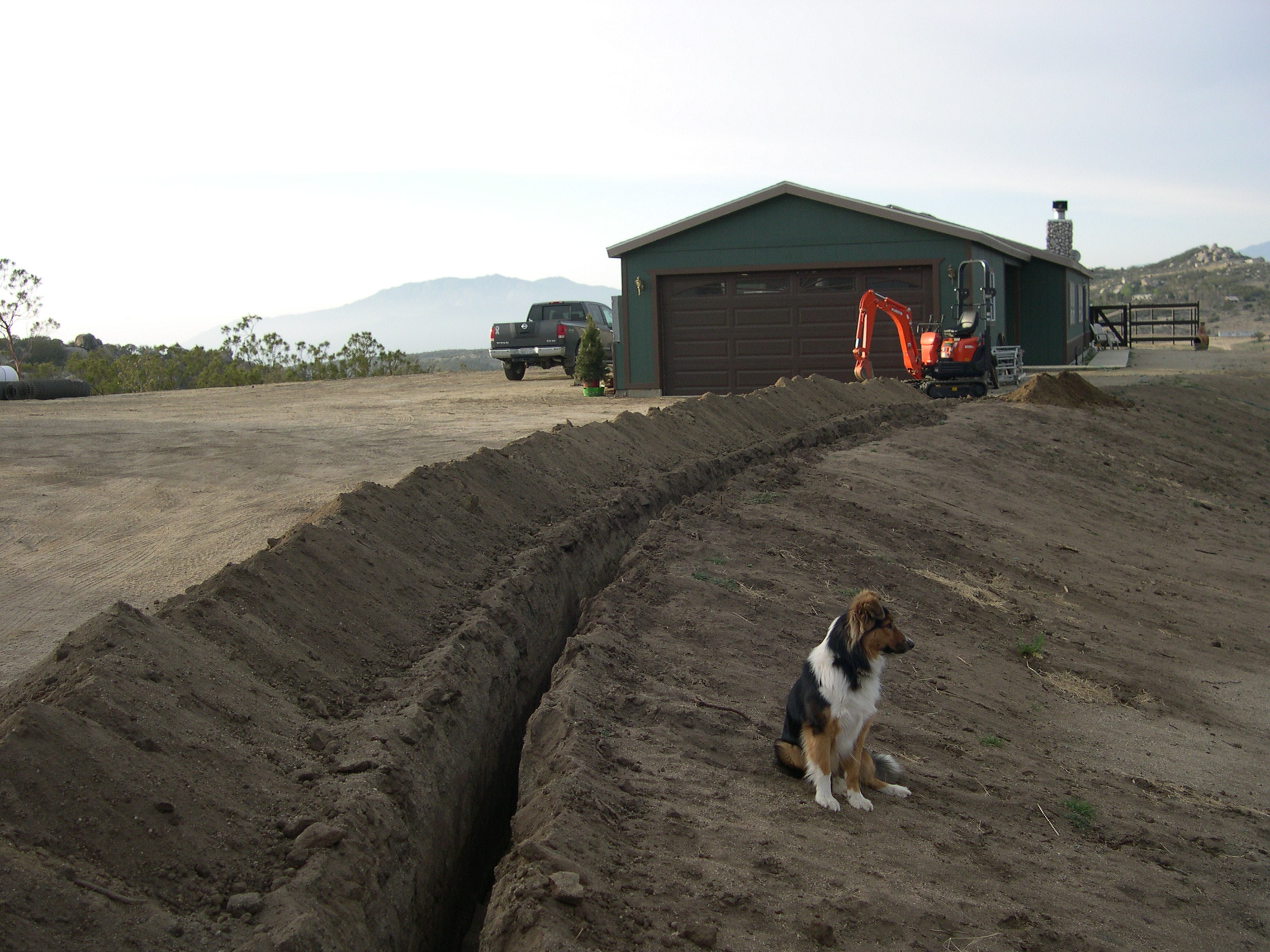

I don't think you will be able to get much done with it. I have the smallest of Kubota excavators, the K008-3. I have dug about 950 feet of trenches with it and it does a great job. It is also great for digging holes for planting trees. It is a bit more expensive than the harbor frieght hoe but well worth it. Here are a few picture of trenches I have dug with it.

I have the smallest of Kubota excavators, the K008-3. [and some great photos.]
I WANT ONE!!! If I could justify the cost, that or the next larger one would be perfect for my application.

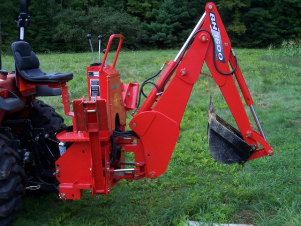

I've got the larger of the two and it is excellent.
   / Harbor Freight's little Towable Backhoe #10
I'll attach a picture.
