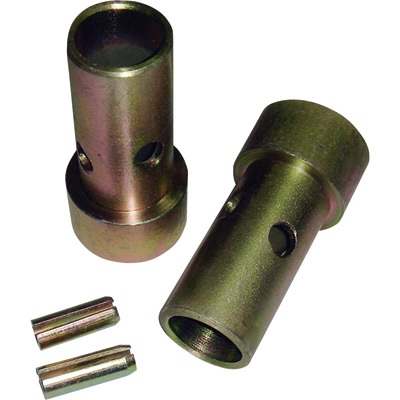

Northern tool has the best price on the lower pin adapters $13. TSC is like $32

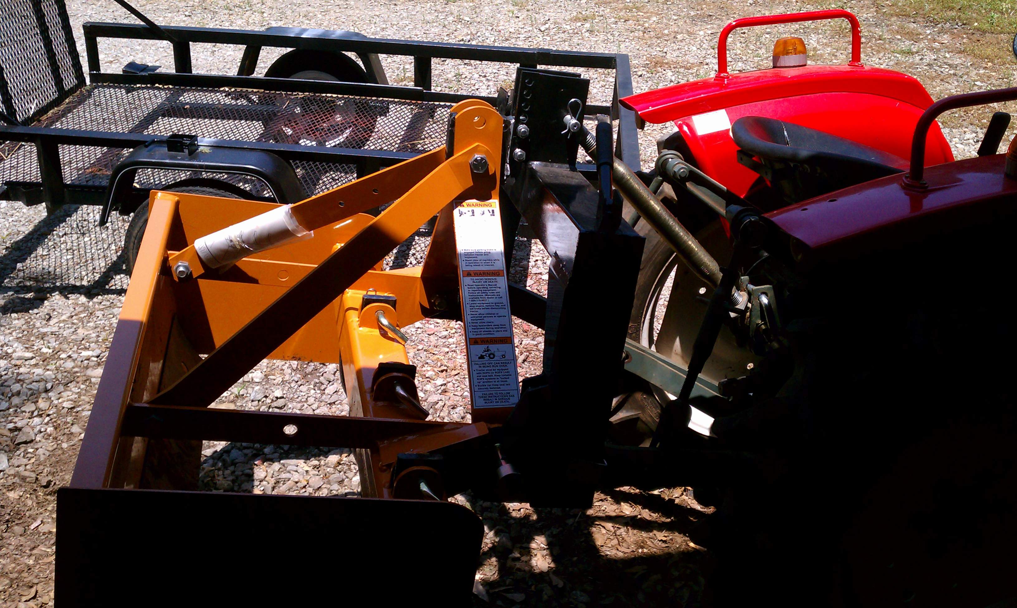

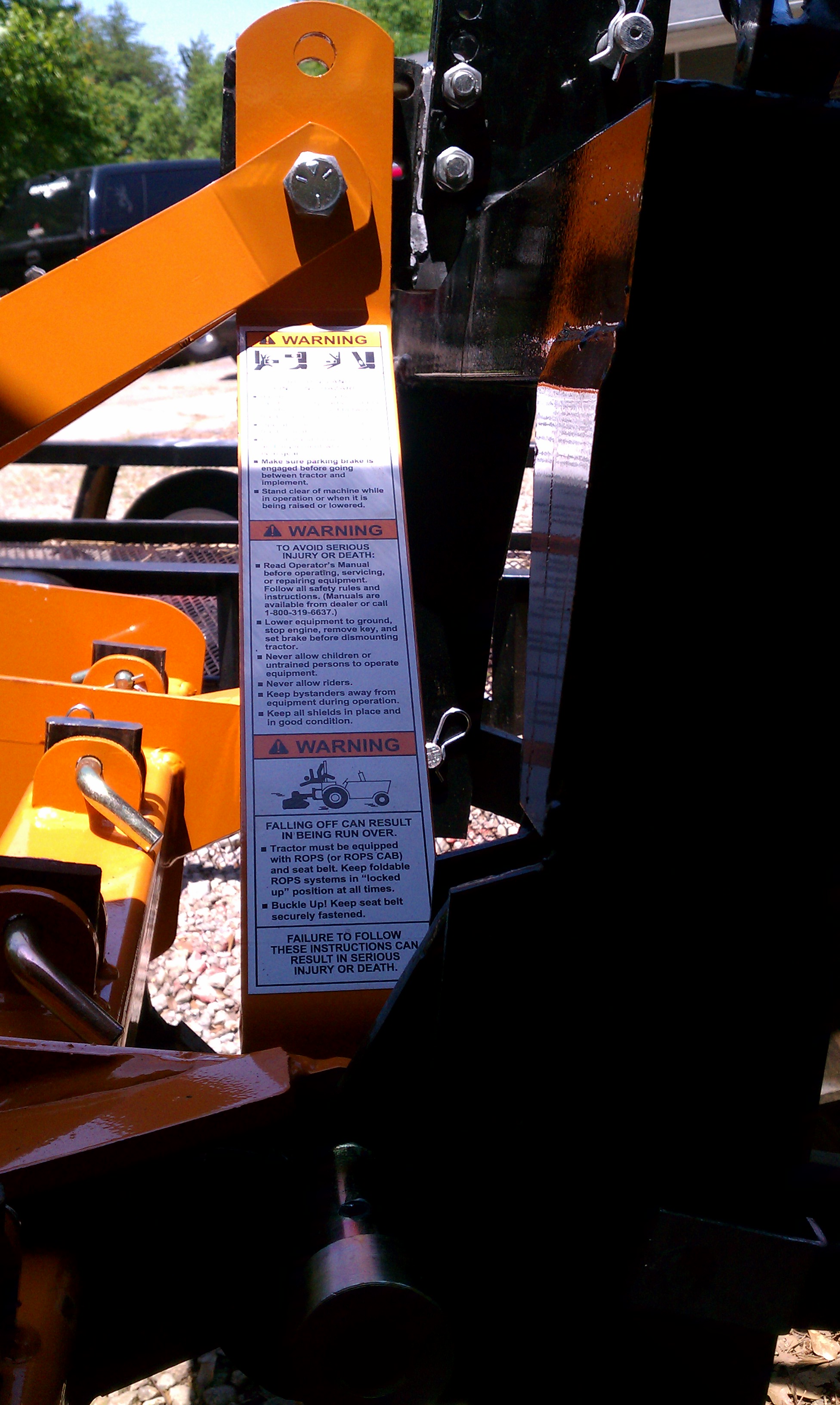

My son fixed mine by welding a 1"bar stock to the back of the hook and drilling two holes in it. He also cut some off the bottom of the hook and made the hook opening a little larger. I am not at home but can send a better picture next week of the hook.
