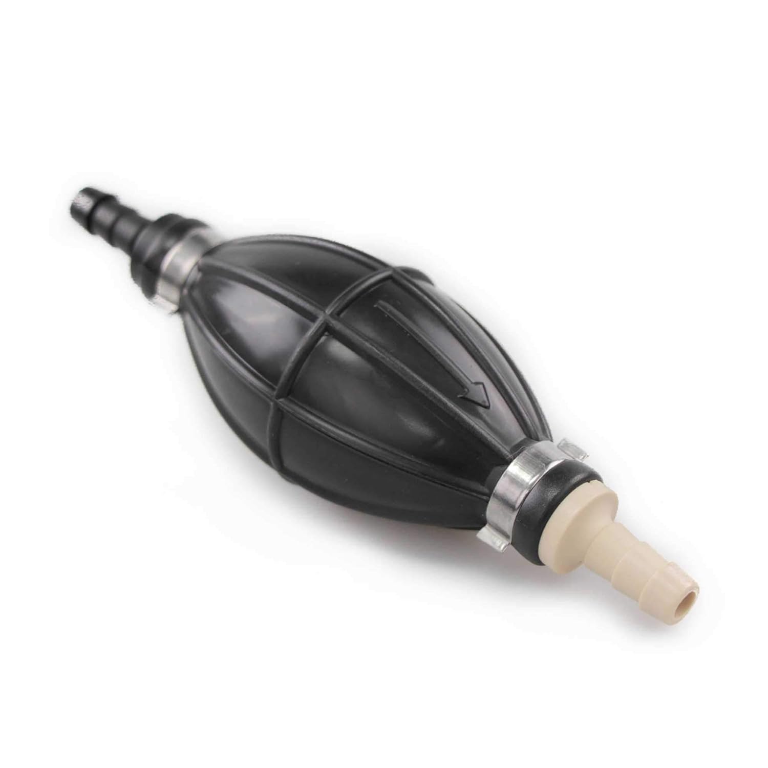

Another thing with the fuel line....the 1/4" line penetrates the top of the plastic tank with a feeder tube going down in the tank. The the fuel line goes up then back down & across the frame to where you see it come out in the engine compartment.
The gas line needs to hold a vacuum of about 10" coming up & out of the tank? Looks crazy to me and probably why we have such hard starting trying to get fuel to the carb. I'm putting in a pump squezzy thingie to prime the carb. 2-years being pissed about the hard start has come to an end.
Link to the primer bulb thing I was describing...
fuel primer bulb at DuckDuckGo

I like the primer bulb idea. :thumbsup:
Although it would be easy to flood it, if it's too big.
