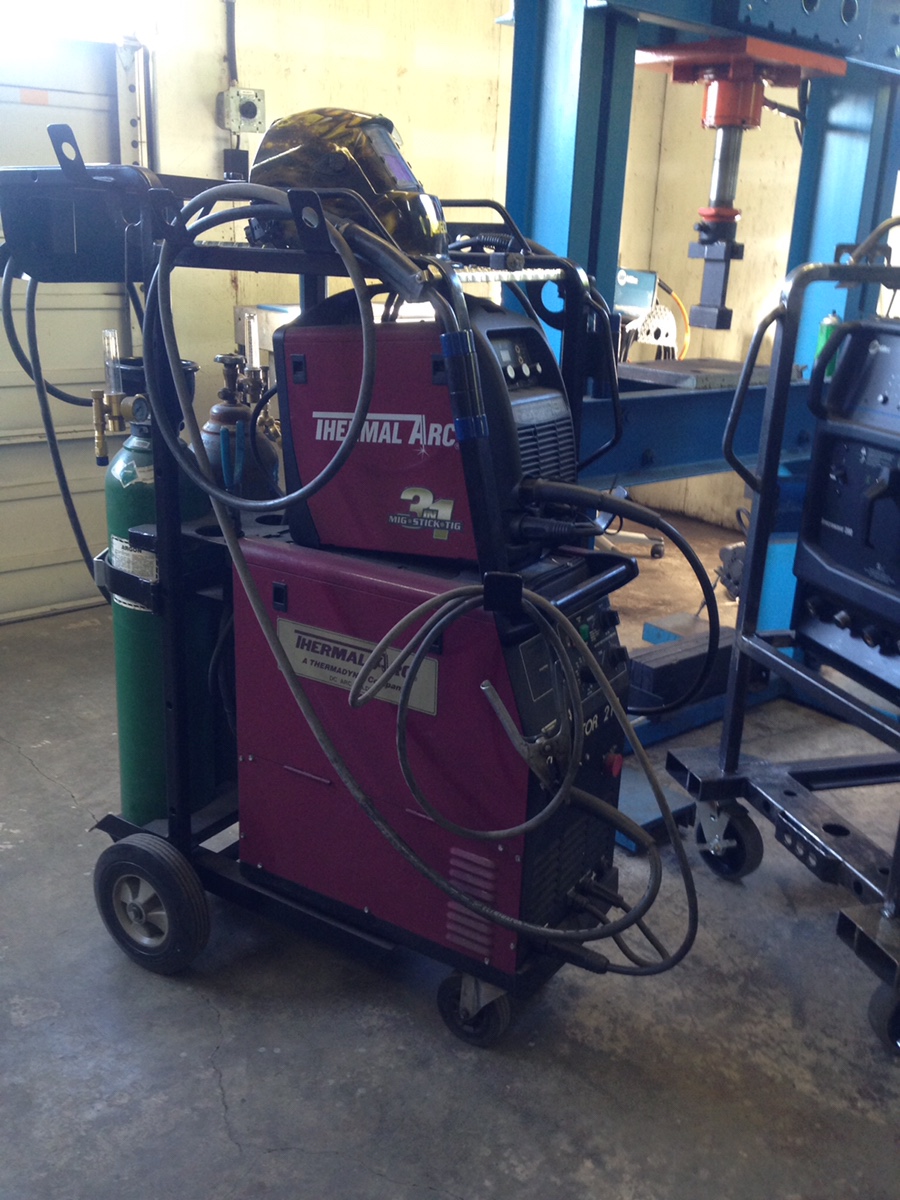

I use .023 and 035 solid wire with gas in the shop in these two Thermal Arcs.
Dual shield for big jobs inside or out. Stick for the fun of it and (or) small jobs outside.
