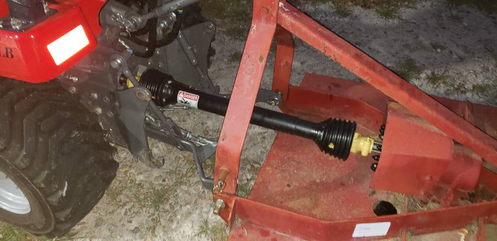

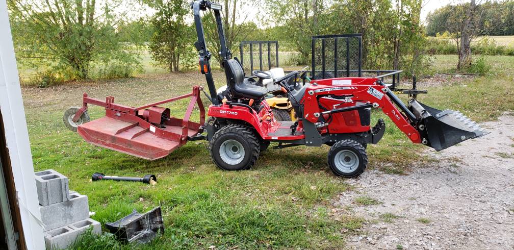

Seems like it works great. Tractor had no problem at all.

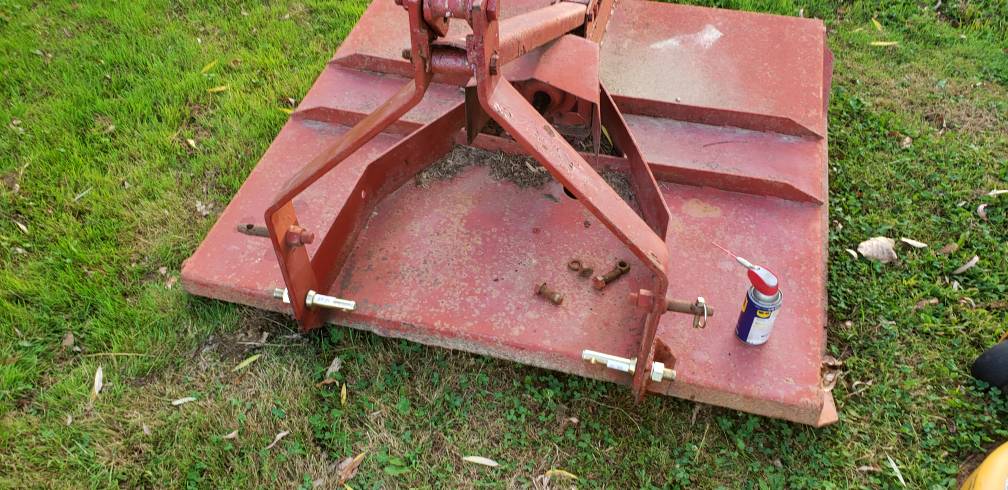

I mounted new pins on the lower level after enlarging the holes to fit. I bought a new drive shaft and cut it down. Added a slip clutch as well.
All I have left to do is fix the rear wheel and maybe figure out if I want to use chain to maintain the cutter angle. I also need to add some spare small chain to keep the PTO protective casing from spinning.

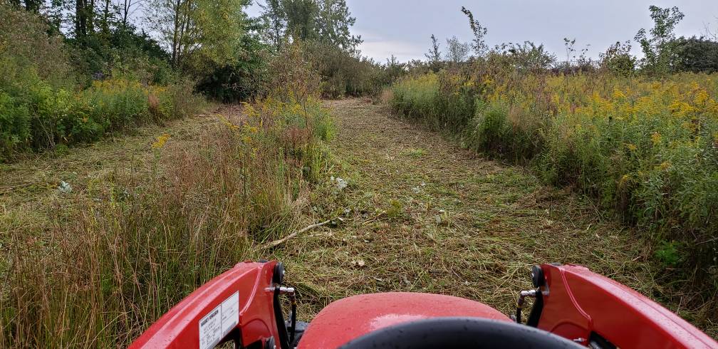

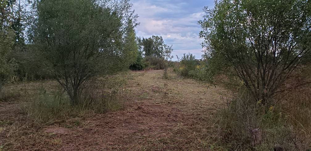

Second day and first real test of this setup. Seems to handle the cutter great and isn't short on power.
Only issue is that I managed to stall the tractor when the cutter bared down and dug into a hump of clay or ant hill or something. I'll probably need to adjust the clutch a little more. 20190925_182952.jpg20190925_184643.jpg20190925_190828.jpg

You should be fine on PTO HP for that unit. Moving the pins down probably helped your lifting geometry a ton. I uses a full 5' JD Gyramor 205 on my smaller GC1710 with absolutely no issues. Glad it's working out!
PS: clean it up and put a fresh coat of Massey Red on that thing, will ya? Lol
