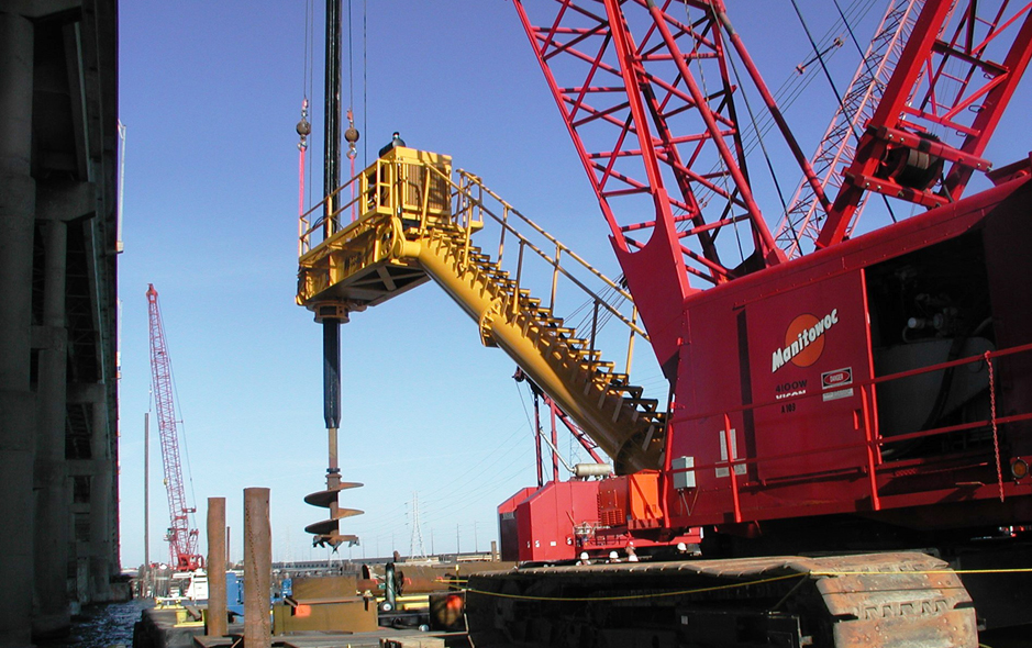

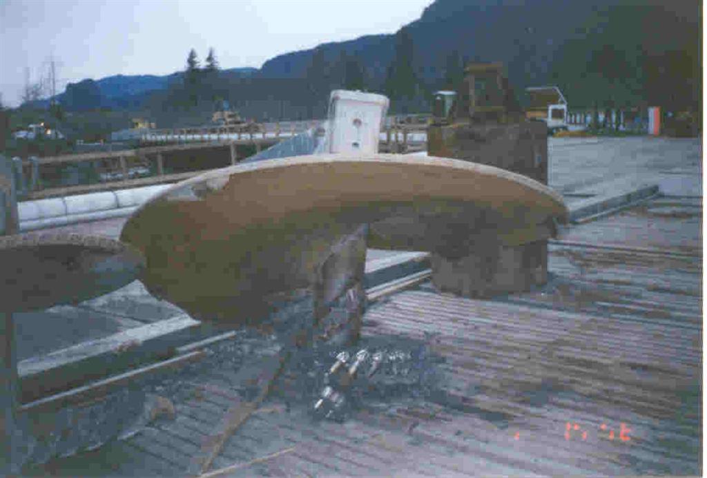

Over the years I've had good luck with Stoody 31 hard facing. I use to get a steady diet of hard facing these things.
