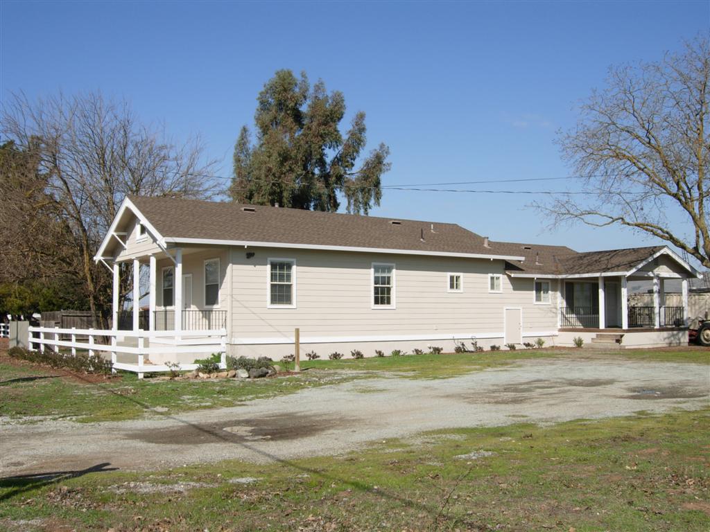

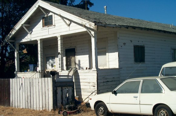

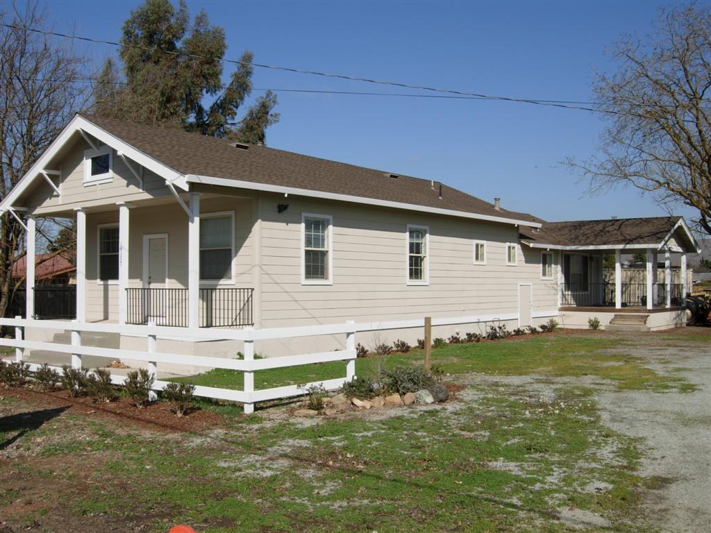

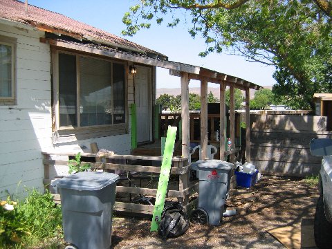

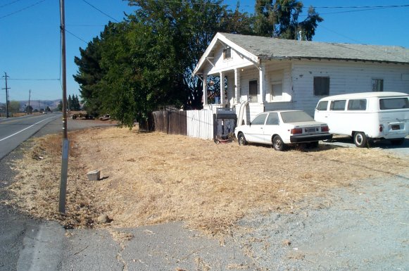

Sigarms
Here is a rental that I did a complete remodel on using Hardi Plank horizontal siding, all the work was done by me and my step-son.
Before and after pics.

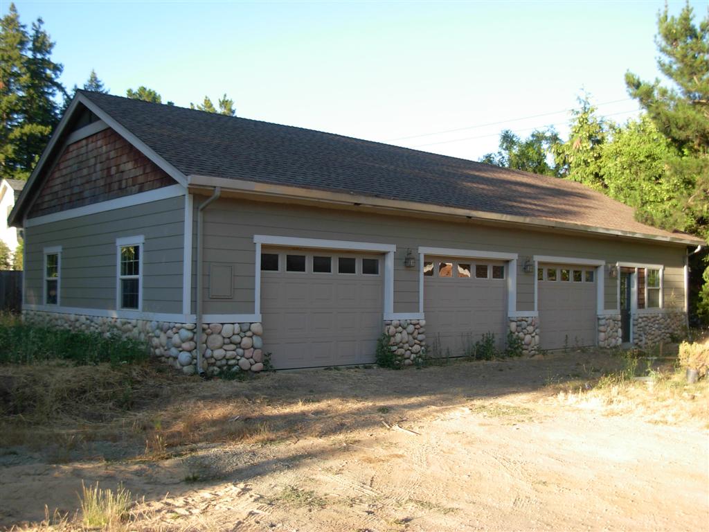

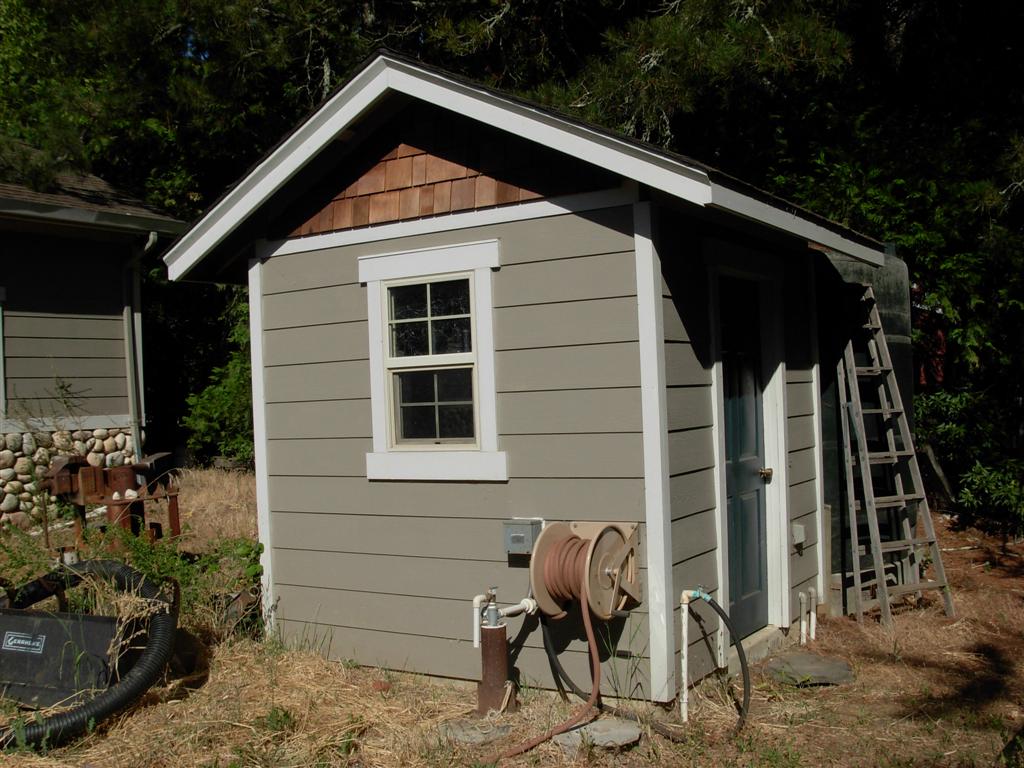

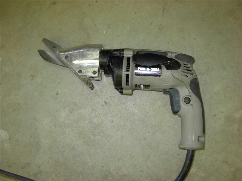

My garage and pump shed, Hardi plank of course. Also a picture of the sheers for cutting HP. The sheers are the only way to go, except for fine detail cuts which you would use a saber saw.
On the installation I used flashing at all the joints in addition to calking. It’s not really any extra effort, but well worth it as far as I’m concerned.

did you use the HP on the fascia of the buildings? if so, did you use the shears to cut them down to the right width?
heehaw
   / Hardi plank, horizontal or vertical? #29
heehaw
No only the pure “siding” is HP. All trim/fascia is standard width 1x or 2x I didn’t rip anything. The only place I made horizontal cuts in the HP was to fit under or over windows. I did use the shears for that.
The first place I used the HP was on the garage and that was before I had the shears. For that job I used a saw, I’ll never do that again. Cutting HP with a saw kicks up a cloud of dust that is very bad to breathe.
One thing I should mention is there are places on my garage were the wood looks in need of painting but the paint on the HP still looks like new. I’m very pleased with my decision to use HP. At this point until something better comes along, it’s the only thing I’ll use.
