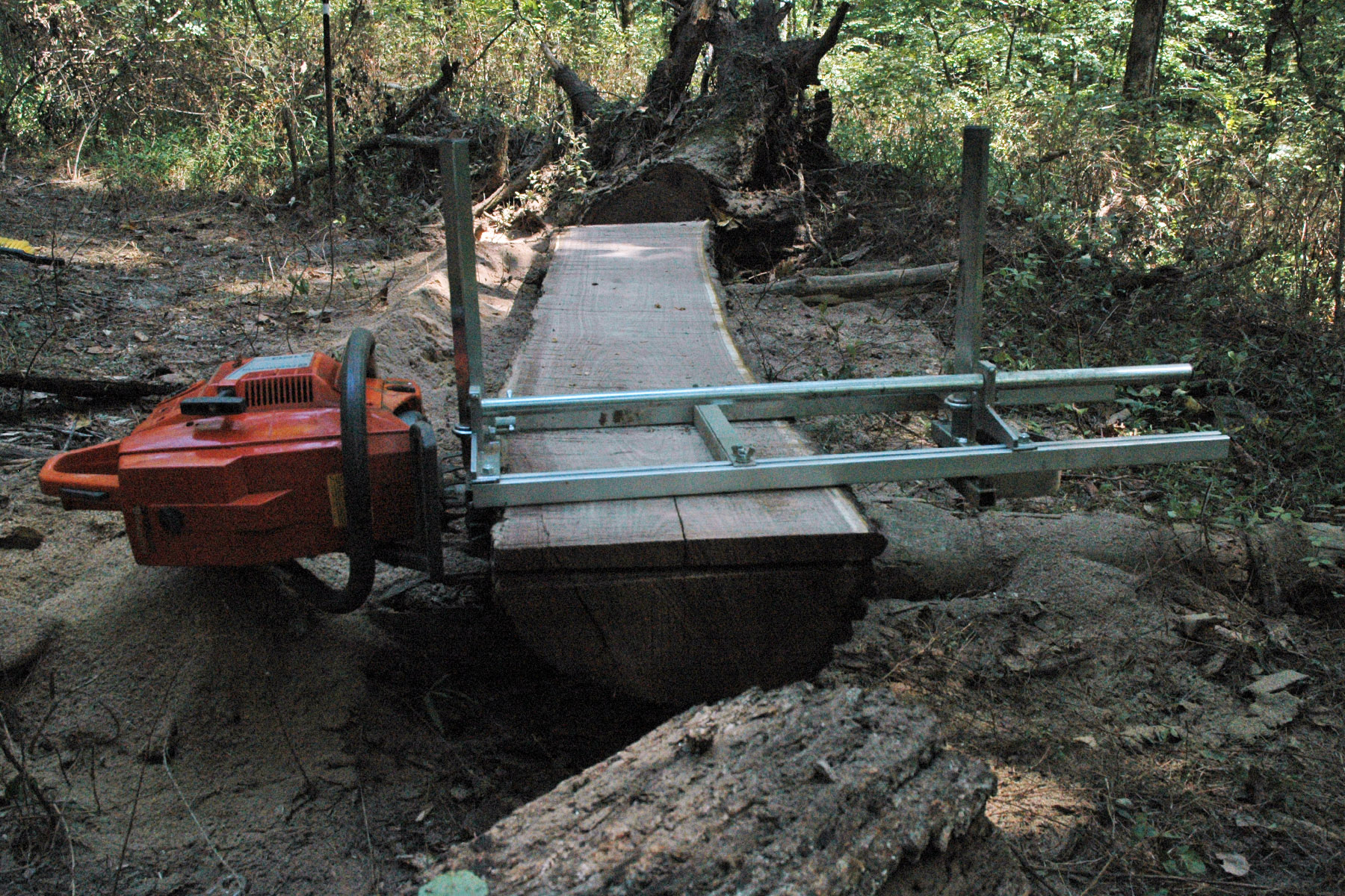

You sawdust is way too "fine", you should be throwing much larger chips which is slowing you down some...although on the plus side it produces a smoother cut. What degree are you filing and how often are you sharpening?? Most go between zero and 10 degrees, re-sharpen after a few slabs. I need to find my Woodbug video on rip chain sharpening for you. He does things a little different(25 degree top angle and 15 degree down angle) and files into the cutter...not away like most of us were taught. The hard chrome coating on the cutting tooth is what does the cutting. Filing away makes little jagged edges of the coating hang off the cutter which soon get broken off leaving a tiny divit on the cutting edge(dull). Filing into the cutter smooths that hard chrome and blends it into the steel of the tooth so there is nothing to break off and the edge stays sharper longer. Filing both ways the chain is equally sharp to begin with, but I found that filing "in" made the my chains go much longer between sharpening's. Give it a try...I only file "in" now on all my saws, besides how did Dad teach us to sharpen a knife....."in" right?
Rick,
You have a good eye. :applause: Truth be told, I was unable to find my rip chains (I believe I have three) for this project, perhap because they were neatly "organized" deep beneath the clutter in my workshop. :eek: So with my TBN commitment to produce lumber, I decided to "wing it" and use a sharpened standard chain with a ~25 deg top angle--thus the "fine" saw dust you observed. I found cutting to be a slower than what I'd expected but very consistent from board to board. I ripped both logs (13 boards) without any intermediate sharpening. I thought this surprisingly good performance may have been because I was cutting walnut (?).
Also, you know a lot about the art of filing rip chains. I believe I follow your points about filing into and away from the cutter. Unfortunately, my filing skills have never matured, and I have chosen the path of ease and mediocrity--the Oregon bench grinder.
How to Sharpen Chain Saw Chains, Oregon Chainsaw Sharpening Guide - YouTube
Because the grinder motor spins in only one direction, grinding occurs into the cutter on one side of the chain and away from the cutter on the other side. The results are, however, generally adequate and require little skill. Clearly a compromise :(.

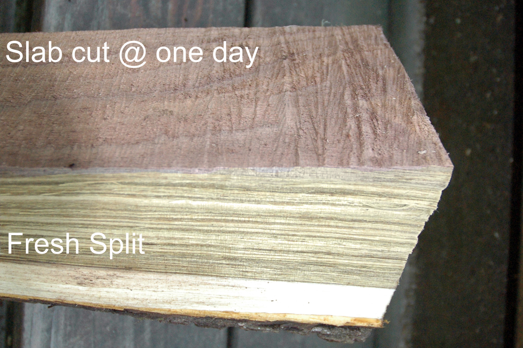

And I know on TBN that without pictures, it didn't happen. So I thought I'd show an example of the color change that accompanies one day of drying/curing of black walnut.
The first picture shows two pieces of "green" black walnut firewood slit one day apart. The second picture shows two edges of a single piece of waste slab wood that was split one day after cutting. In both cases the color change is dramatic. The lesson here may be, "Don't judge a log (or a tractor, for that matter) by its color alone."
