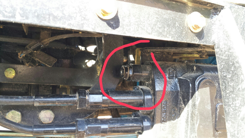

Where is this adjustment on an R4041? Looking at my manual and not quite sure where it is. Thanks.
   / Has anyone adjusted the Loader Relief valves, or the system PSI ??? #55
I'm not certain on the 4041, but I'd be willing to bet its the same. The relief valve is located on the loader valve, under the right floorboard. The valve is at the top. Loosen the jam nut, (19mm) and turn the center (allen wrench) abaout a quarter turn at a time (a quarter was all I needed), then tighten jam nut.

rwork,
Great pic, thanks alot! Did you do the John Madden X and O and your cell phone?

I have the G3033 and I have a valve with a set screw below the fel lever and a set screw on the valve below the right floor board on that valve. Which one do you adjust for the loader bucket?

Have you checked your pressure to see if it is low? If so, loosen the lock nut, turn adjustment screw about 1/4 turn, check pressure.

Without the risk of sounding stupid, I assume you turn it clockwise ?
