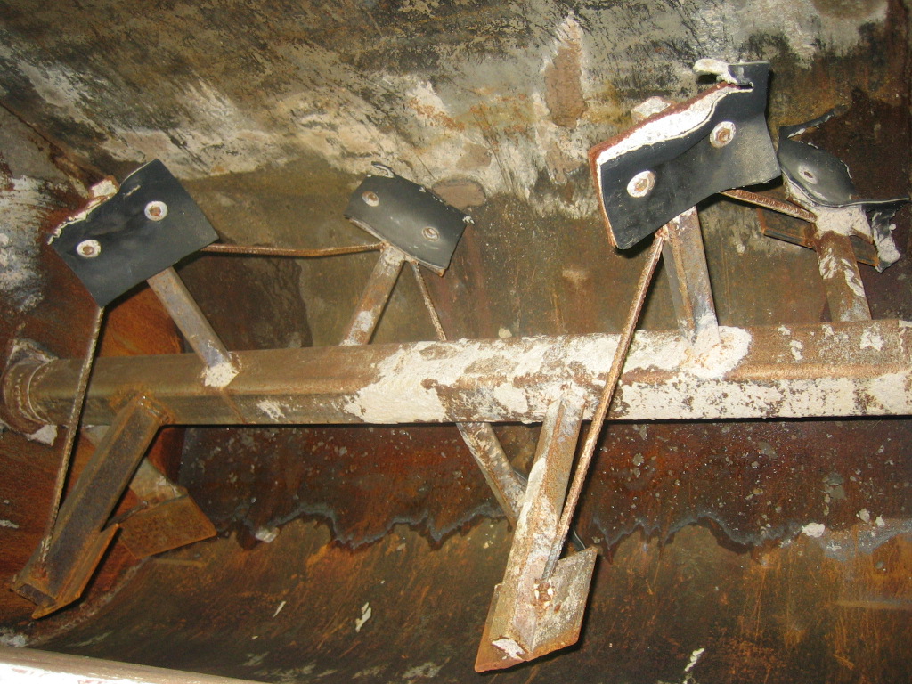

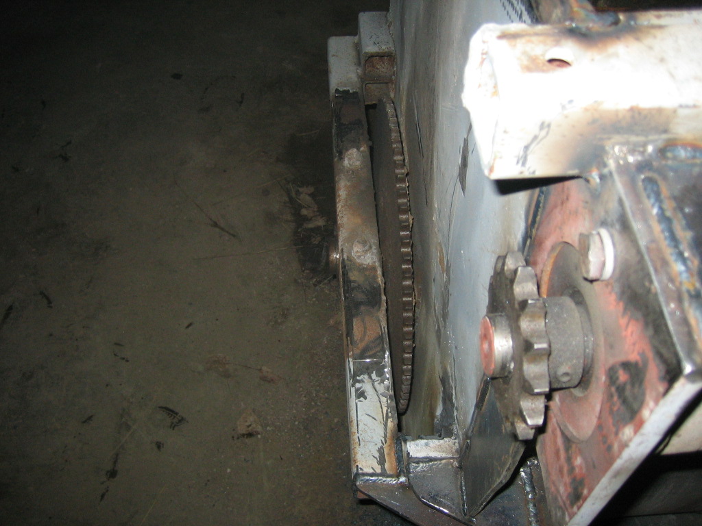

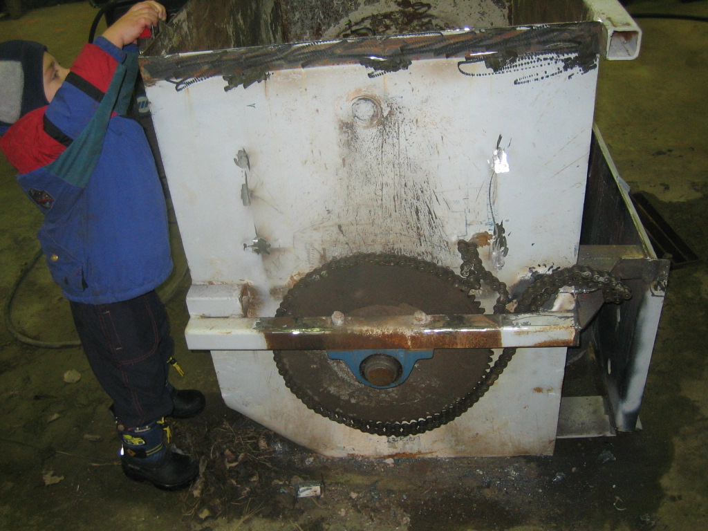

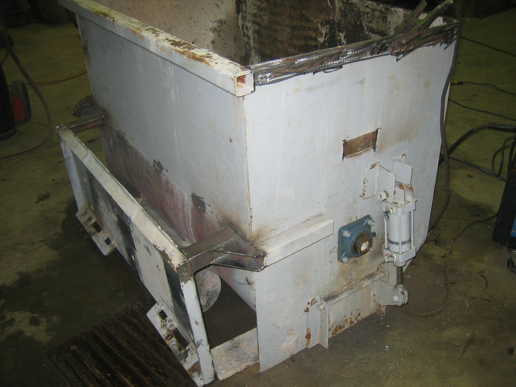

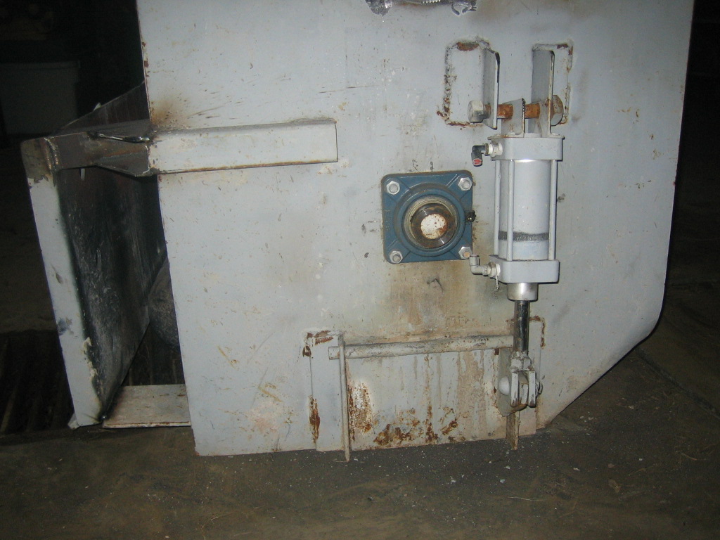

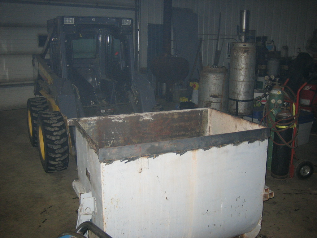

I purchased this home built unit last spring. It somewhat like the monolithic mixer. Hyd drive with roller chain reduction. Has a air operated side door for small volume discharges.
However unlike theirs it was not made to scoop its own agregate. So we changed the angle of the quick attach plate so it could scoop and dump out of the front. Moved the hyd motor from the left side to the rear so it would not get into the gravel pile when scooping material. I would like to replace the air cylinder on the side discharge with a electric splitter valve and a hydraulic cylinder sometime to so it would not need to be hooked to a compressor every 15 dumps or so. Unfortunately I did not get a chance to try it out in its old configuration, but it was covered in concrete so it must work.
The main thing i would like it to find some sort of seal for the mixer shaft to keep the concrete out of the flange bearing on the rh side and off the sprockets on the left side.
Any idea what they use in the monolithic mixers for seals?
