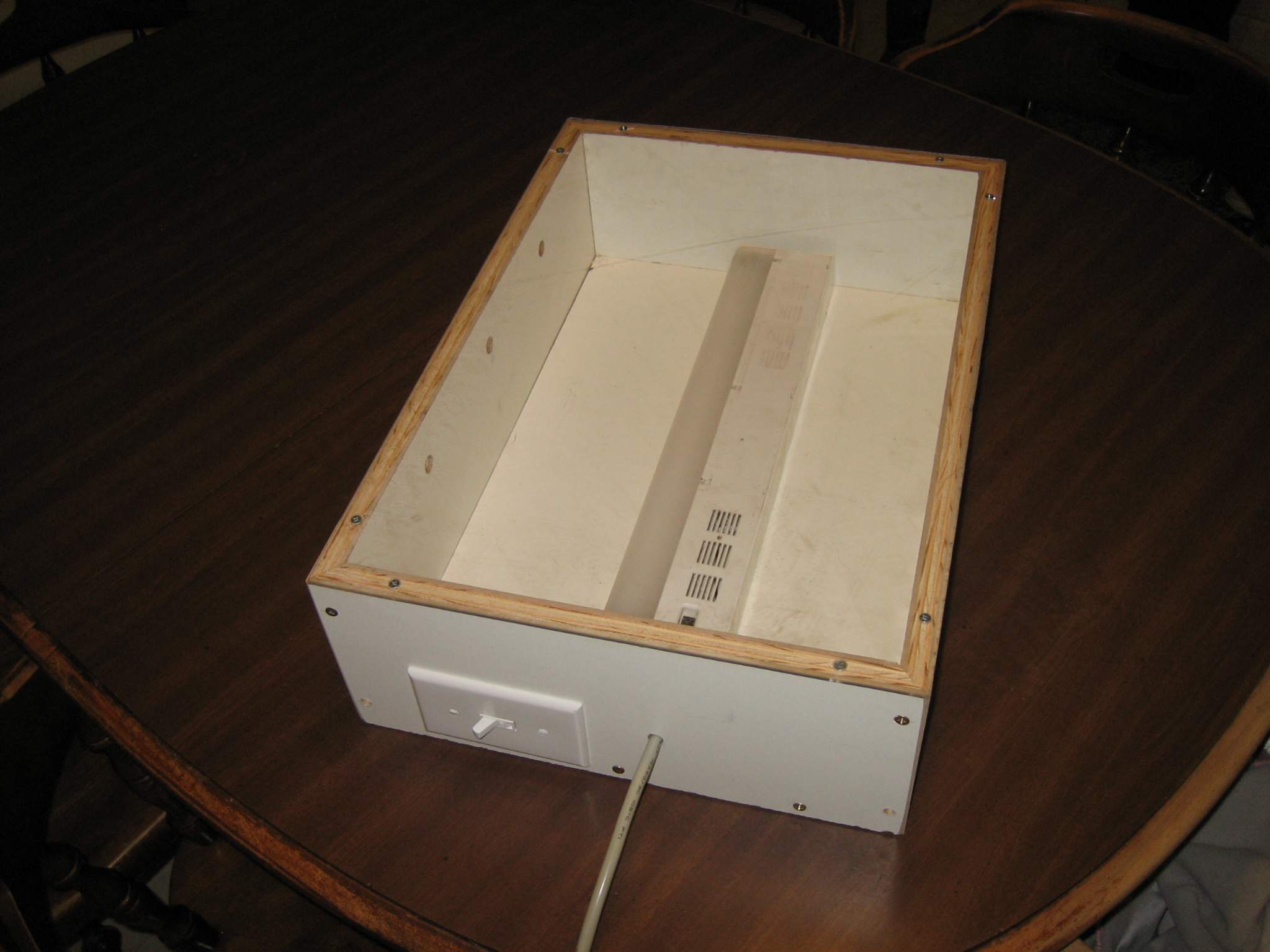

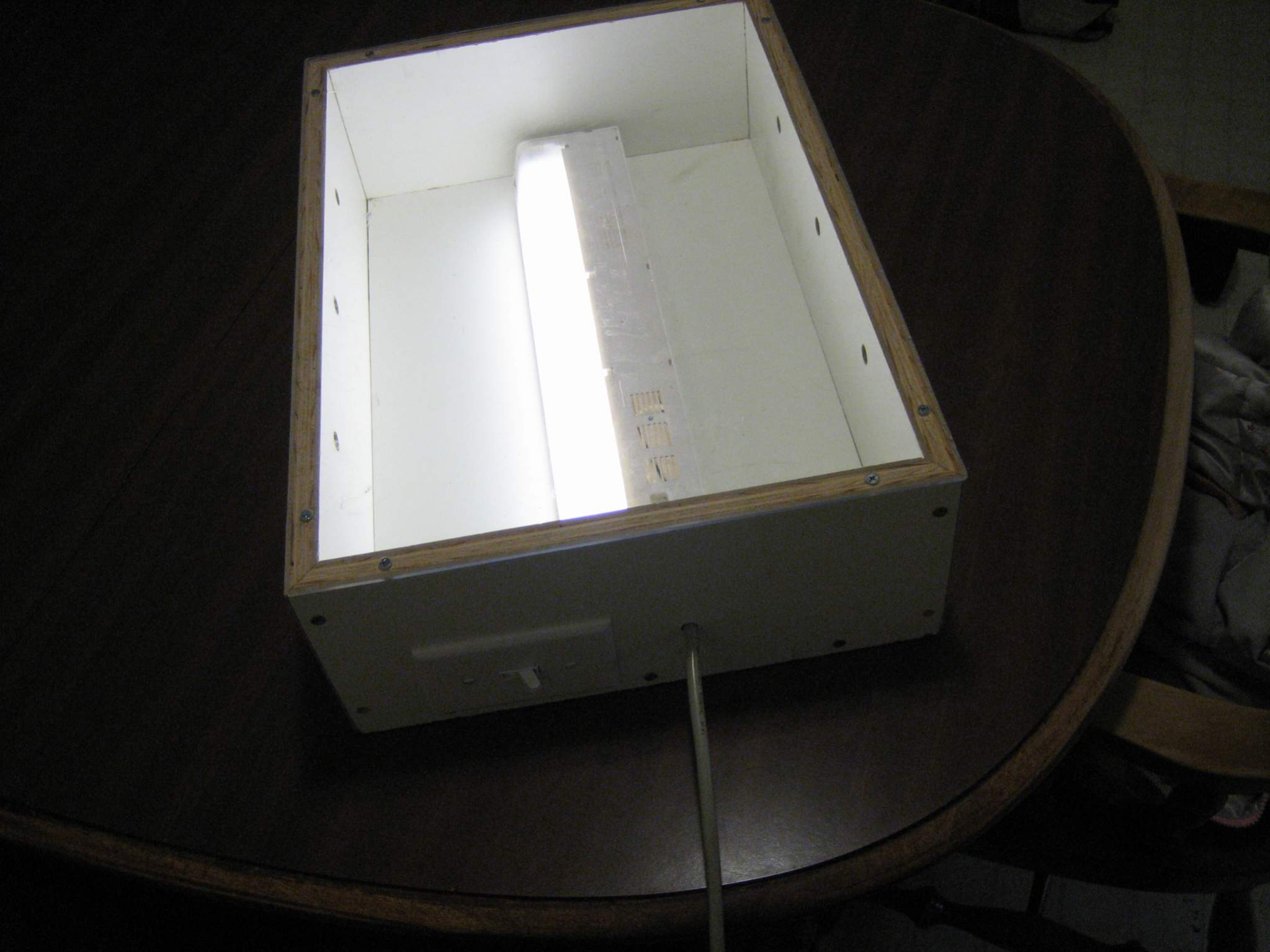

#29
Here's the finished product. I decided to leave the glass clear and see if it works.
I tried to center the light in the middle of the box, but it looks like that may not have been the best bet. This particular light casts the light directionally and leaves one half of the box darker than the other.

   / Has Anyone Built a Light Box? #30
No problem, just move it to the rear and claim the extra hole was for venting purposes. Admit to nuttin!
I believe you'll find you'll need to make the plexiglas opaque.
