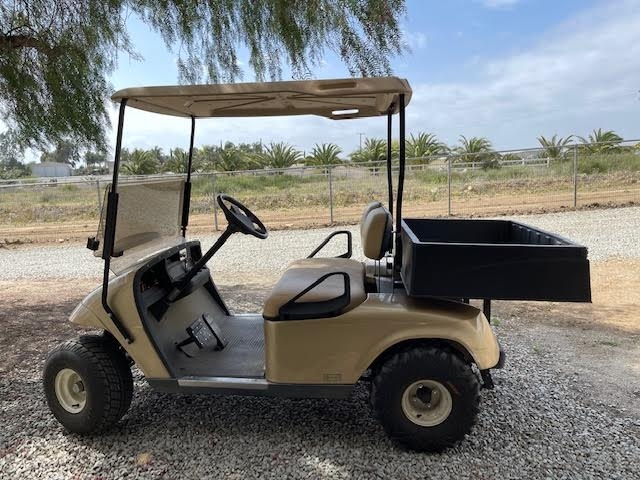

I have used the NE 16gal sprayer for years. The 12v broadcast sprayer covers about 8-10 ft depending and the included wand sprays up to 25 ft depending upon the pattern. Not as high as the OP wanted but its a great sprayer for general use. I put it in the back of a golf cart. Easy peasy.
