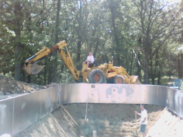

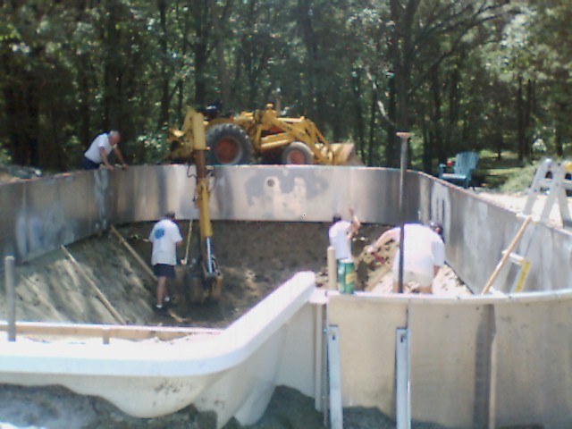

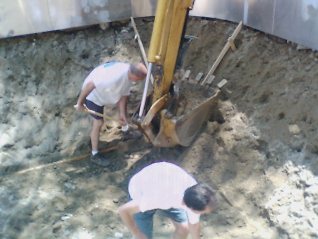

When someone tells you to go pound sand, this is what they're talking about. You shape the sides and bottom with masons sand and pound it into place with a tamper. Are we having fun yet?

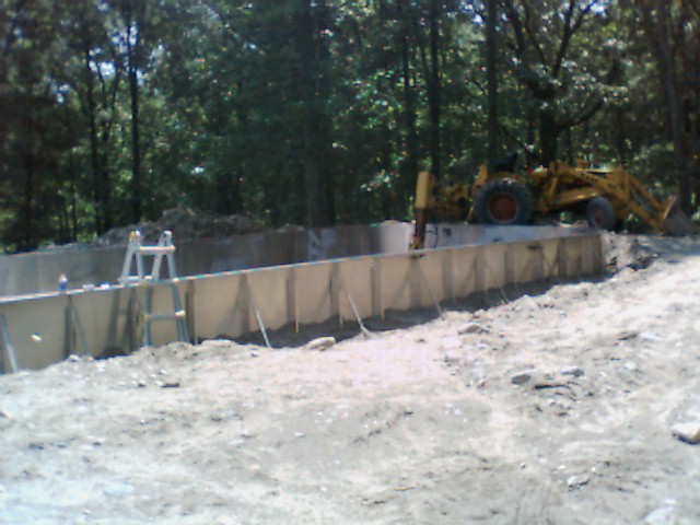

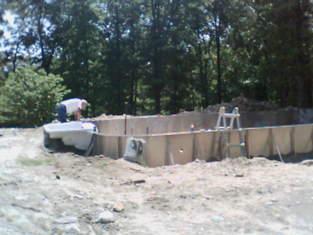

   / Has Anyone Built A Swimming Pool #23
Here you may be able to see the concrete "bond beam" around the bottom of the walls. Essentially, once you have the walls in place, plumb, level, square, etc, you pour a cement footing around the base of the walls to hold everything in place. That's all for now. I'm happy to answer any questions you might have (if i can).
