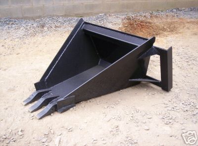

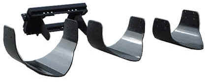

You can use any one of your ideas, which ever is easier for you to make. On flat plate, you can lay it between two pieces of wood and drive over it. If you have a shop press, you can bend it, or take it to a steel mill and they will bend it or form it for you. You can also cut the pieces out and weld things together. Below are some pictures for examples.The last or forth tree spade was built by MrJimi who passed away six months ago. It is made out of 3/8 steel. Did an excellent job.

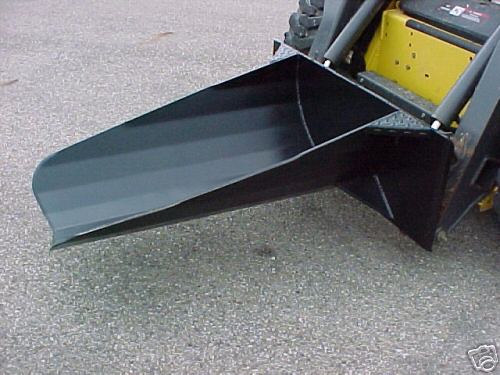

Here are some more pictures, and maybe ideas.
If your tractor has the skidsteer hookup, they sell a blank attachment plate that all you have to do is bend the steel and weld to the plate, not a whole lot of work involved.

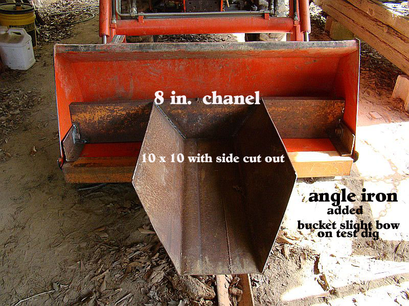

Ok, here is what I ended up with.
Took the section of 10x10 3/16 thick walled steel, cut one side out.
Tried several methods of bending, ended up at shop with a BIG press.
Got it close to my desired shape. Wanted 45 degree sides.
Had the 8 inch channel and the angle iron laying around for a long time.
Pack ratting pays off sometime. :D
Cut the channel to length, split the cutoff to make end brackets.
Bore holes to match holes used for tooth bar (removed)
Since it is "too wet to plough" I have only tried a couple of digs.
Noticed the bucket with a slight bow so will try with the added angle when
it dries out.
I looks like it is going to do the task that is asked.
I'll let you know. If anyone is interested. :)
