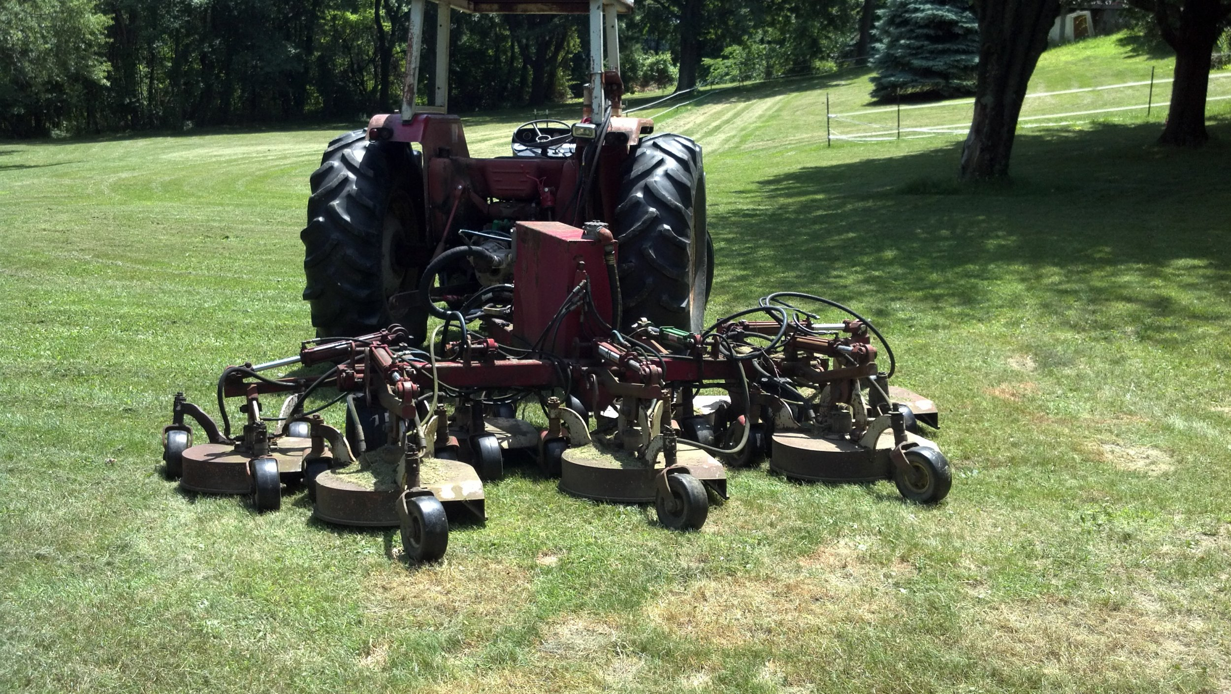

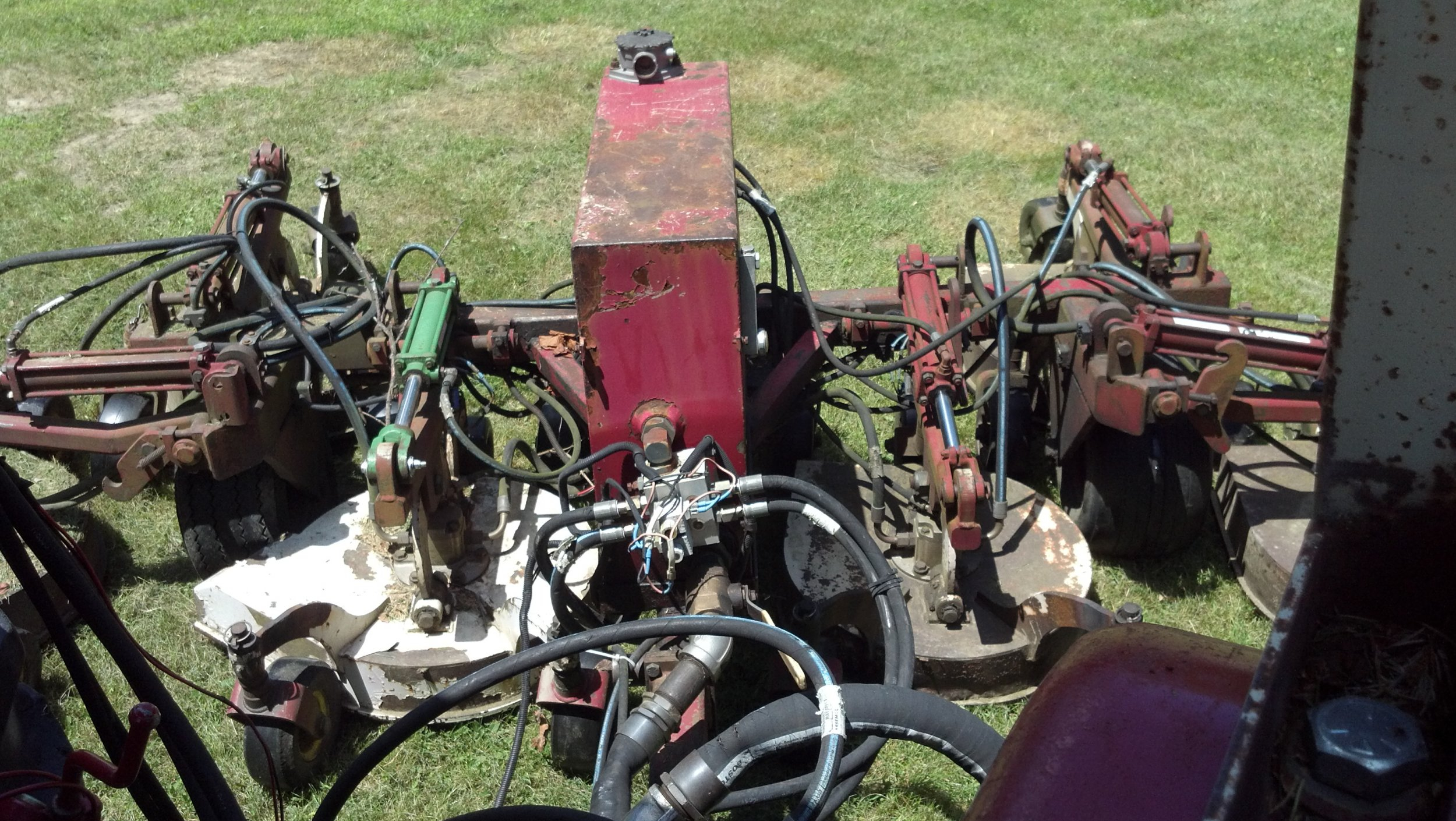

This is what I used to use for mowing my lawn,
tractor mounted hydraulic pump that powered 7 individual hydraulic motored decks and 7 cylinders to raise each deck.
It took longer to do the tight spots and edging with a 44" Deere then to mow 80% of the yard.
Too many danged trees.
This mowers pump is what broke my pto stub shaft,
at the time it broke I didn't have the time needed to pull the top transmission cover off and work on it,
plus it needed a new parking brake and the main service brakes worked on.
Ended up with new master cylinders (2), new brake disc (2) machine work on the brake pistons to use newer
brake discs ( mine is a very early 574) and then I told them while it was apart to add a second set of hydraulic remotes to her,
So no time of mine to say, the shop was about 12 miles away so just drove her there and $5000 later she was back in running shape
with a working pto. I had a motor on one of the decks go out just before the pto mishap so it's been parked for awhile.
