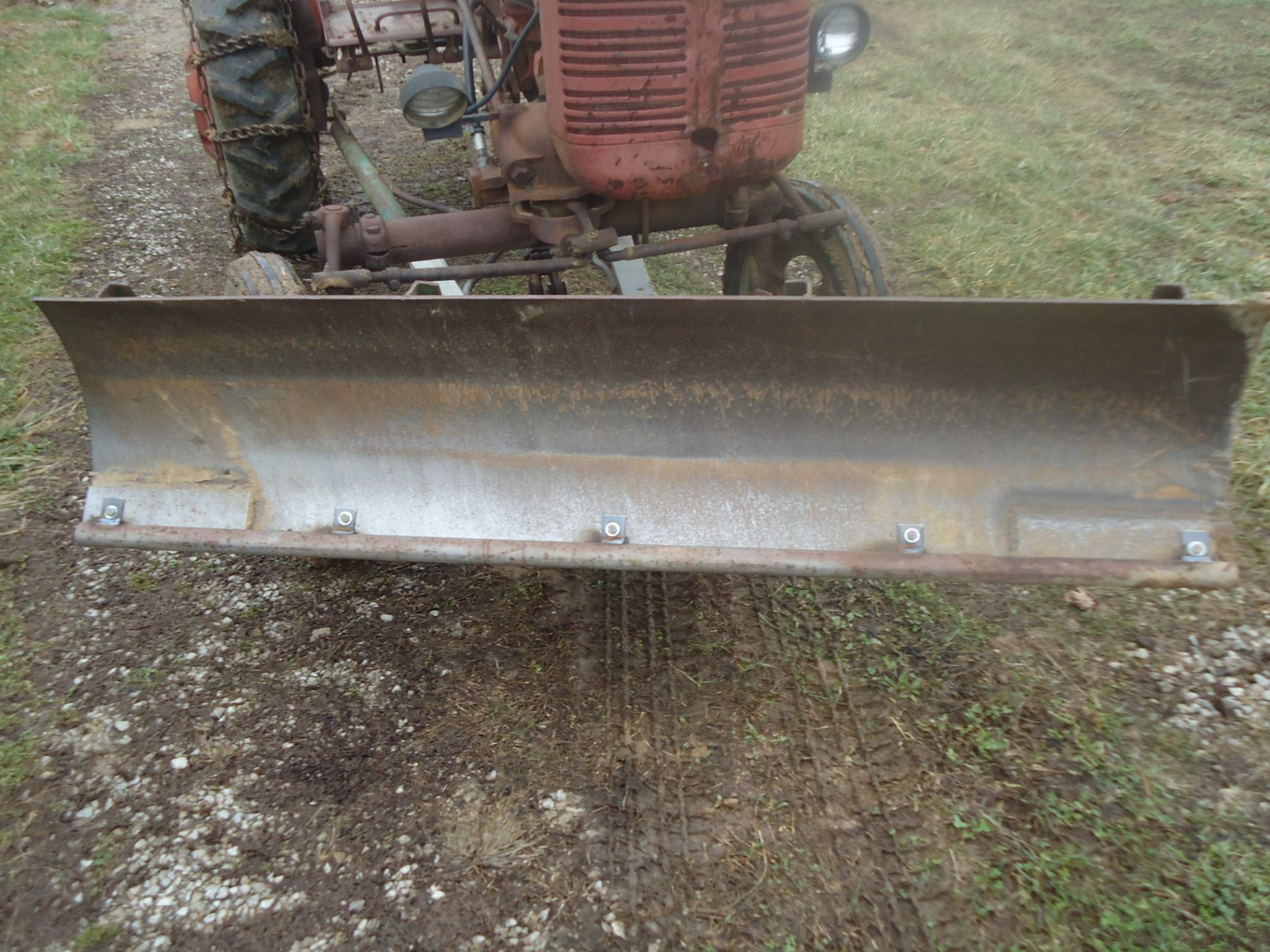

I put a pipe on the 6' front blade for my Farmall A, similar to Yoopers approx. 15 years ago. Except I put the tabs on each end, then two more spaced evenly towards the center. I have tabs both front, and on the backside. I welded the back tabs on first, drilled though existing holes in the moldboard, then welded on the front tabs. Drilled that tabs hole through from the backside. I also cut mine with a plasma cutter. I used a piece of 1" angle iron as a straight edge, laying it so both edges were on the pipe, with the corner up. It aligns itself perfectly with the pipe, clamped it on using a pair of Vise-Grips on each end.
Did find some pics in my picture archives here.

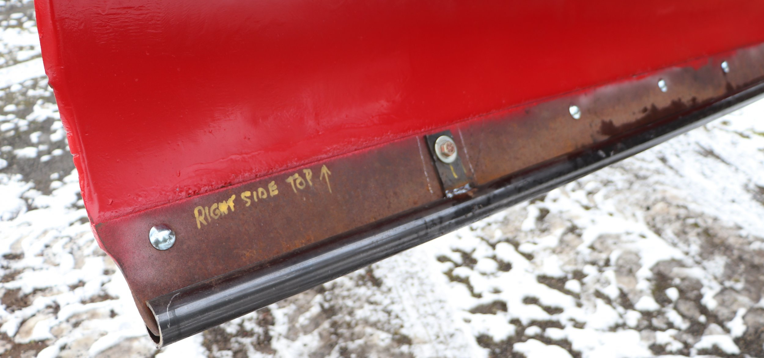

I have edge tamers as well. The only issue I have with them is that I need to take them off to back blade with the bucket. I use them when the ground is still soft and then take them off when it freezes hard and trust my bucket level indicator when I need to push/dig and I try to keep it off the ground. Looking back at the suggestions I like the bar/angle iron idea better the the pipe idea. Something straight and flat across the entire edge.
   / Has anyone Ever Made A Pipe Blade Edge So Their Bucket Doesn't Dig In For Plowing #19
I adore my edge tamers. Have had them for about 5 years. I rarely take them off even in the summer. Tractor gets most of its use in the summer mowing and moving manure. So the edge tamers are good for that too. In winter moving manure and snow. Edge tamers are great for that.
They are a snap to take off too if you need the cutting edge.
There are "knock offs" on amazon now too, but I cannot speak to their quality.
