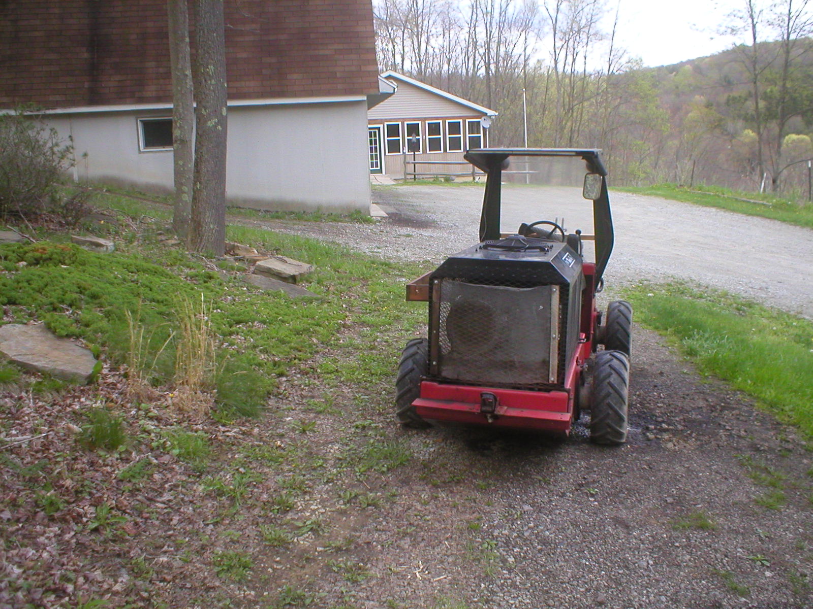

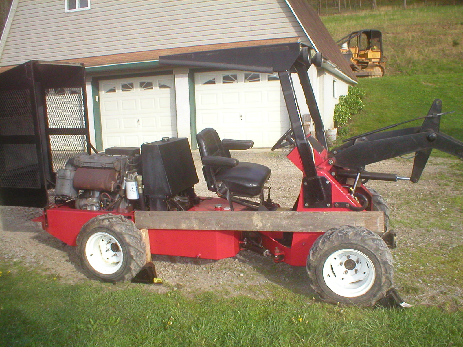

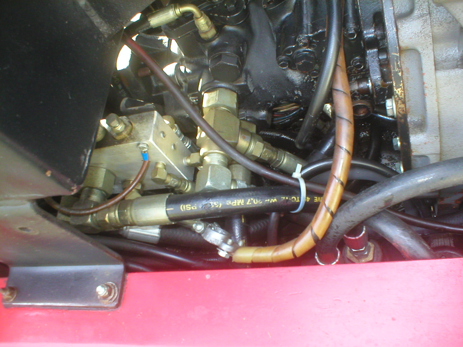

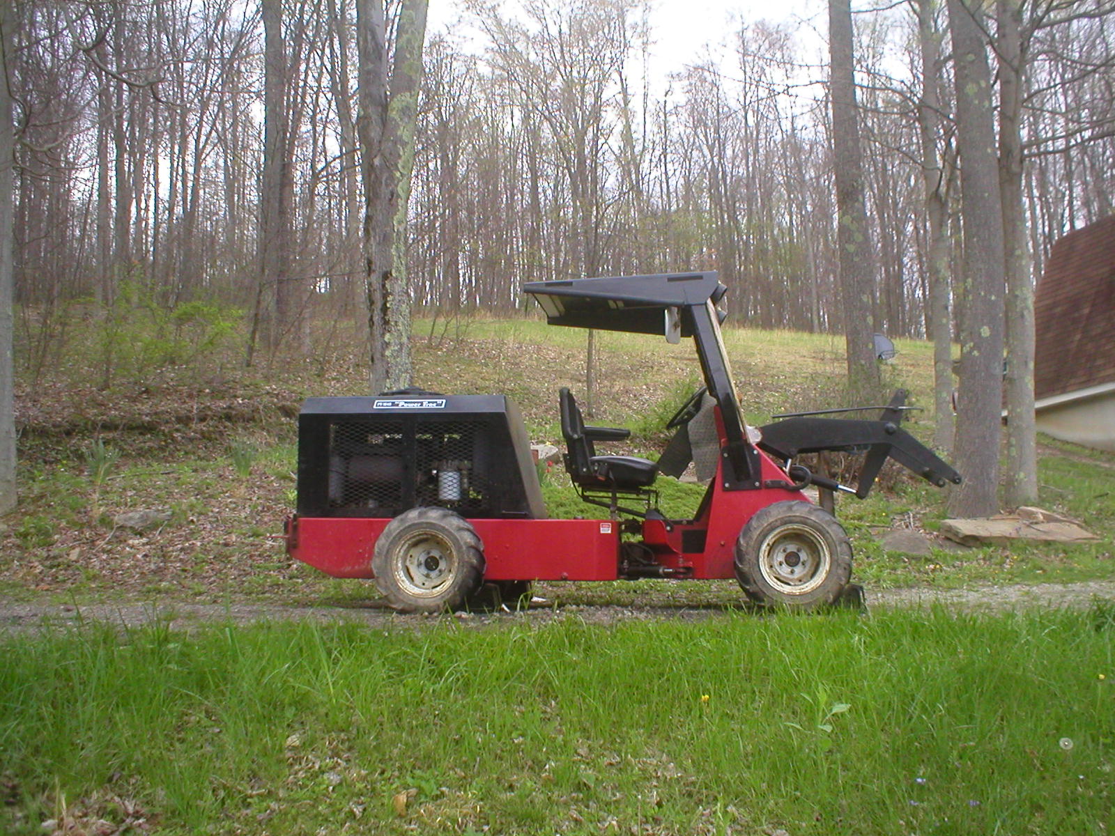

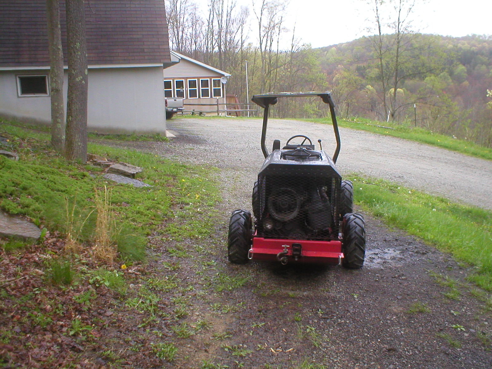

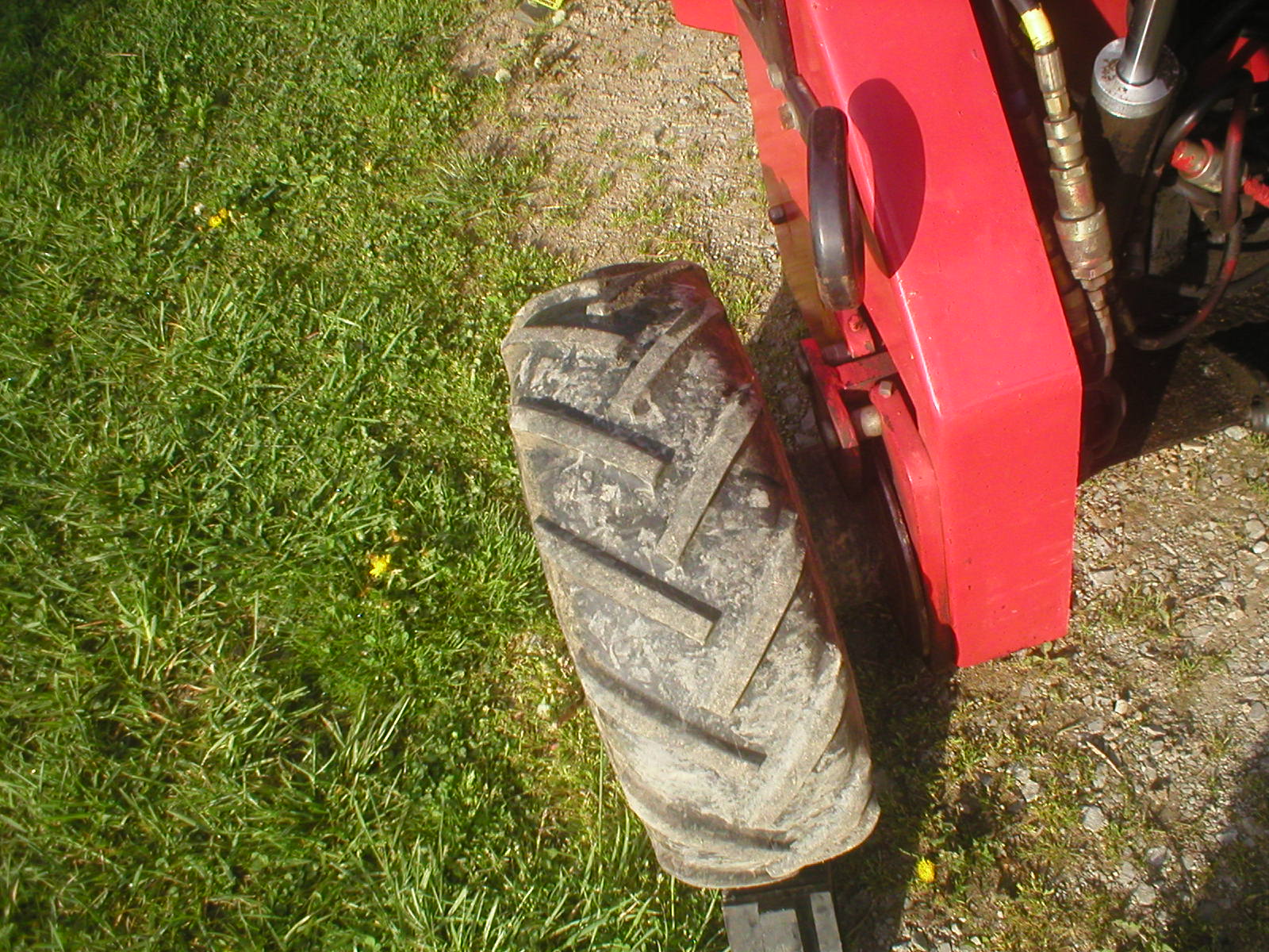

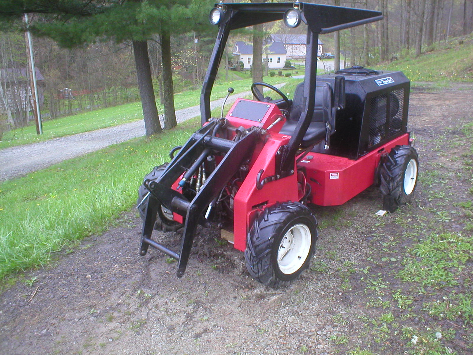

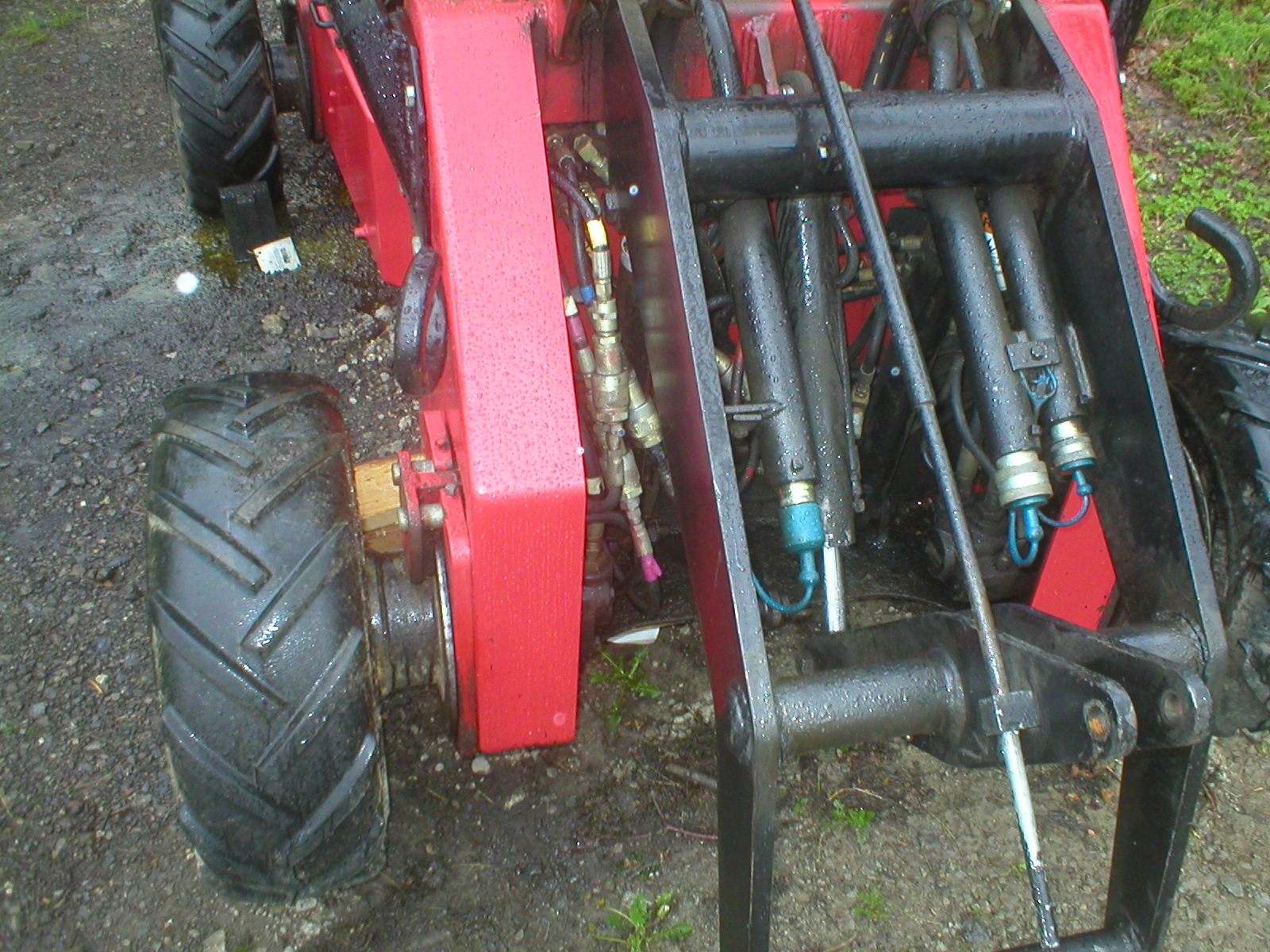

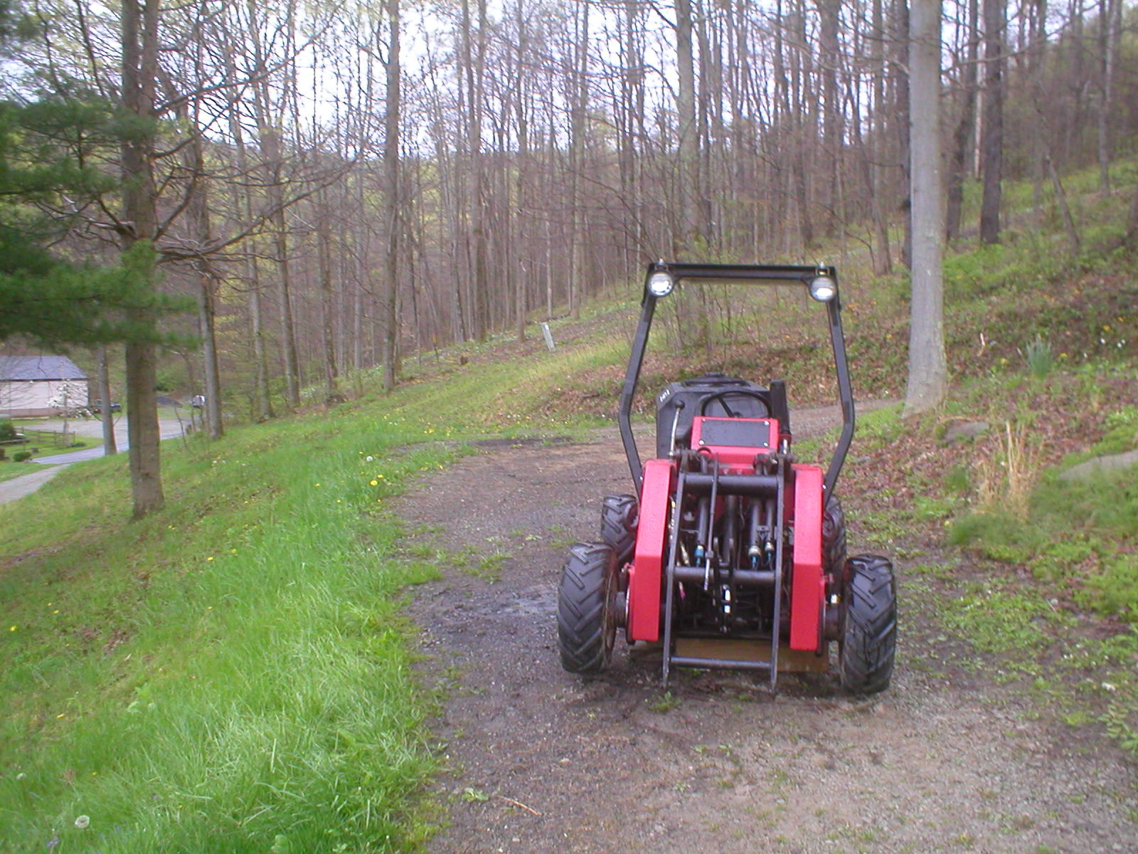

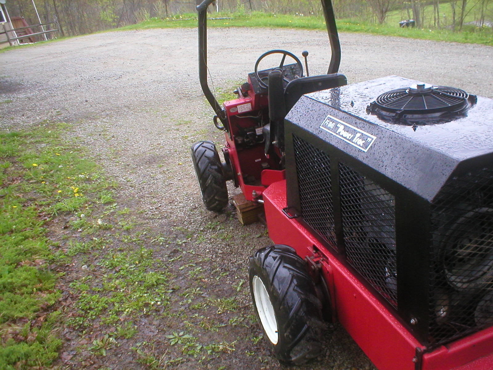

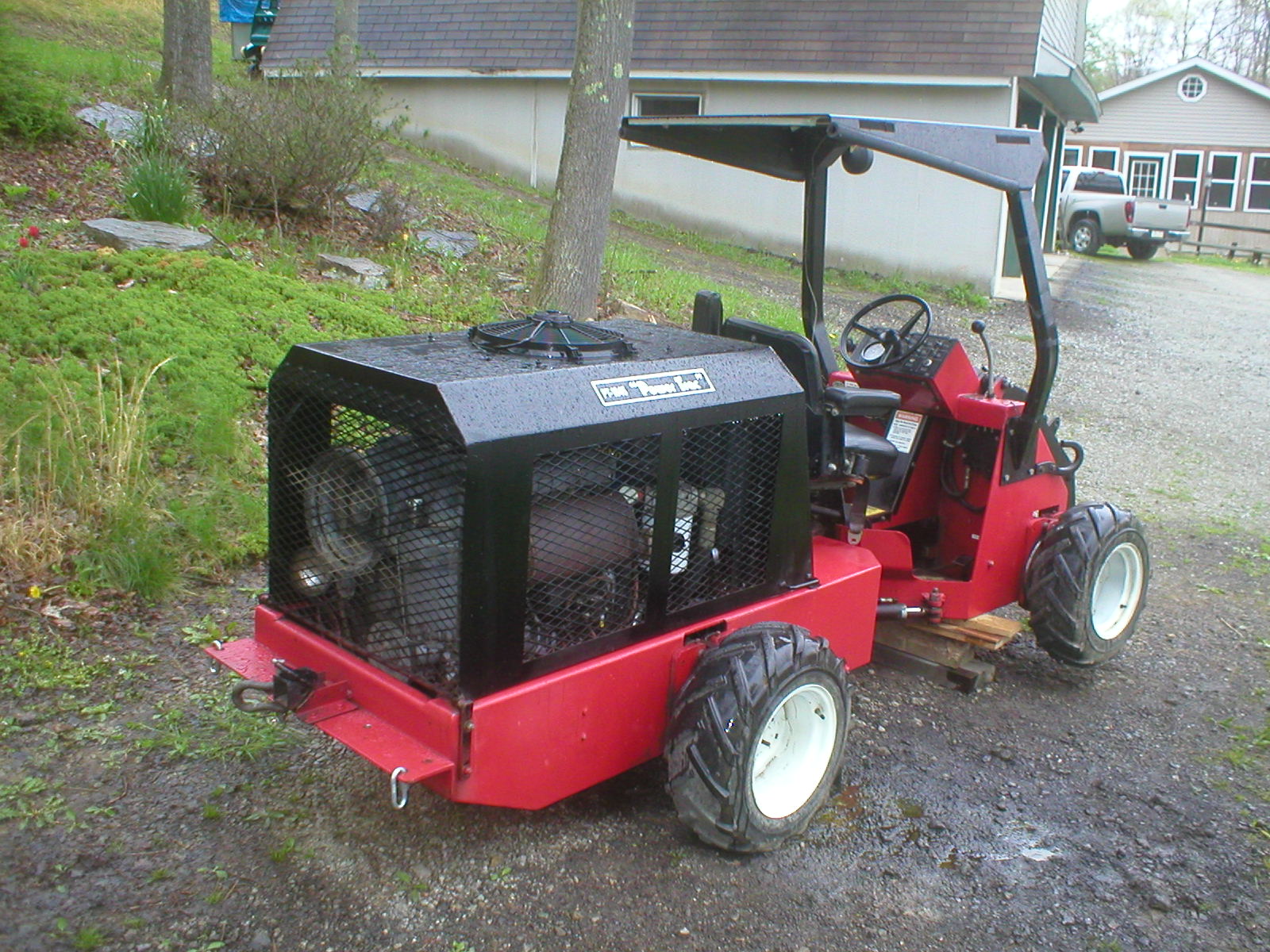

P4260005.JPGP4260004.JPGP4260006.JPGP4220004.JPGP4260004.JPGThanks for the input guys. I want to have the whole tractor gone over by power trac because my tub is a mess, wiring looks bad, hydraulic hoses need replaced, brakes or wheel motors leaking, plus several other things and I really do not want to try myself, old age is creeping up fast on me and my grandson will probably be doing a lot of my mowing he just loves the 1845, not so much the 422. Most of my mowing is hillside and I want him to be safe.. MR"s idea of the straps might work except that the hubs need to turn they are part of the brake system. I was thinking of strapping a plank onto each side of the tub and extending past the front of the front half and strapping it there also, do you think that would work?
Pictures attached.

Sorry- is this where the PT is broken down, or are they old photos? If this is where it is, I would use the pickup or a tow truck to get it out. (We've used tow trucks for some pretty amazing off road tows- you just need an access point.
Your 1845 has the BrakeTender, right? Or do the brakes come on/off automatically with a solenoid? If it is the former, then I'm with MR that the only circuit that is pressurized would be the FEL/Steering/Aux. If the latter, you have a brake circuit that may have some pressure due to leakage.
Oil mist injuries are very very dangerous, as in potentially lethal, so you don't want to be trying to look into the cage to find the leak while the engine is running. Can you slip a hand into the tunnel at the front and the back to feel the underside of the hoses to feel for damage? (engine off of course!)

It has a brake tender which can be released by pumping a handle at the brake tender pressure gauge. It is currently where most of the pictures show it picture #3. Tuesday we tried to load it on a trailer , we could get it up to the top of the ramps then it would jack knife and we could not get it straight. The trucker did not have a winch. From where it is located my driveway is a good down hill grade no problem to get it moving just controlling the steering issue and stopping it.The hoses are hard to get to and I cannot get them to move in any direction to see or feel under them. I think the hydraulic system is almost empty by now the way it has been leaking

To me oil gushing out is incompatible with the brake tender and more likely the front wheel drive hoses.
