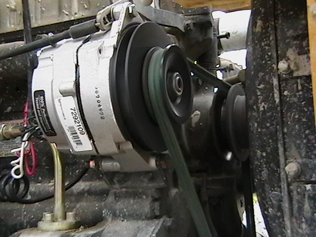

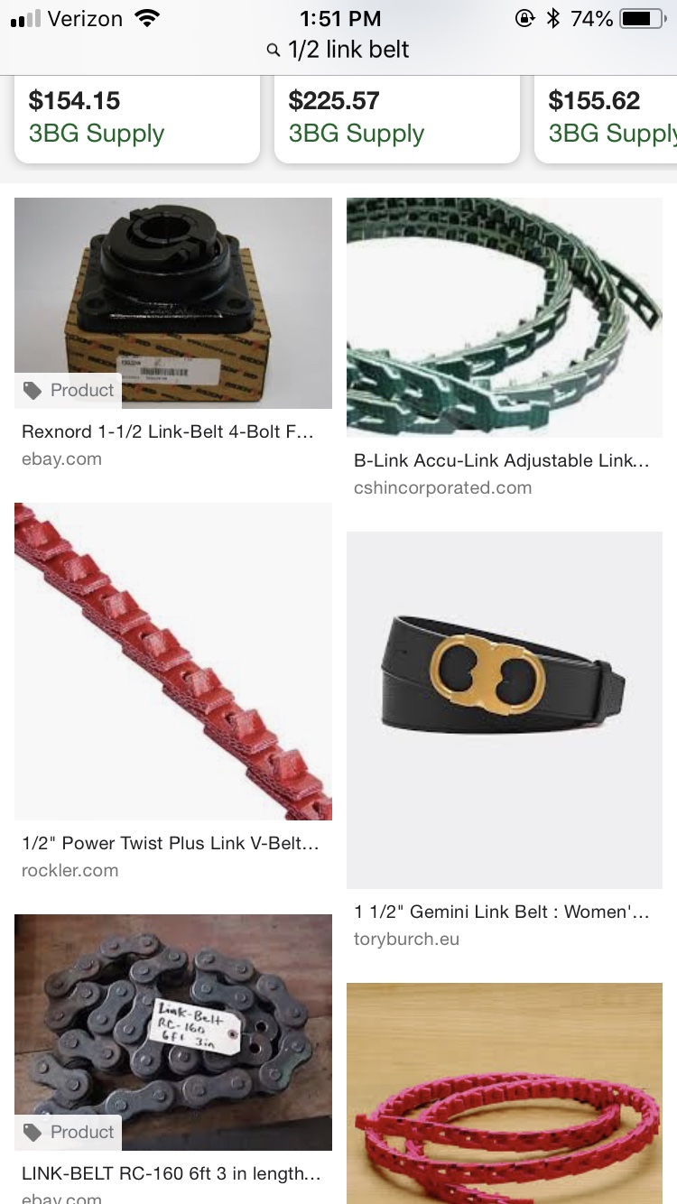

My dads B7100 broke the fan belt and replacing it with a regular belt will require pulling the hood, radiator, whatever else is in the way and likely hauling 70 miles home since there aren稚 many tools on site. A link belt could be put together after its snaked through and avoid all that. Anyone seen a problem?View attachment 570322
It should work as long as you get the right belt size and install it in the right direction.
Link Belting for Power Transmission | Fenner Drives
