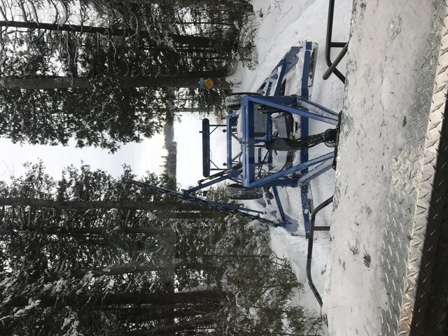

I know this is an old thread. But i use an old lightweight skid to "groom" our trails for walking and sleds on our property. I pull it with my arctic cat 400 4x4 atv.
