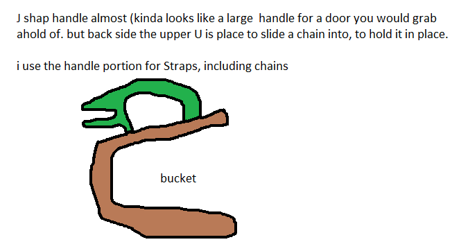

on the ford 555c TLB i have. the bucket hooks look something like below image.
with bucket fully curled downwards, the chain hook in the back works nicely, and if i have something in the bucket (carrying something some place) i have the D are of the handle to wrap chains or straps into.)

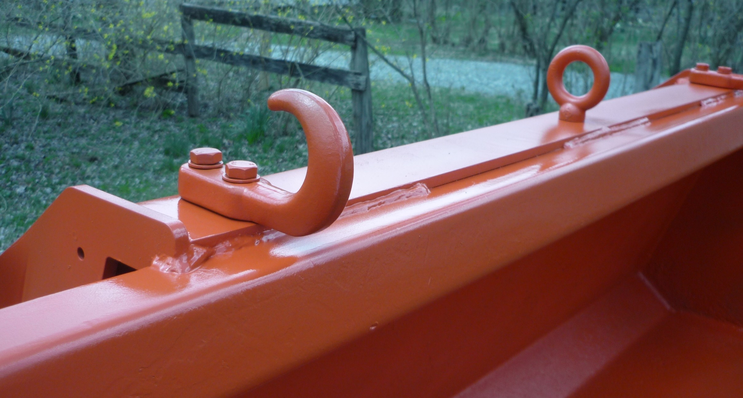

Being "thrifty" I opted for HF $5 forged hooks. They are bolted onto some thick steel, with lots of reinforcement bracing built into the bucket by Kubota, and I figure their "10,000 lb" rating will be adequate for whatever lifting force they are subject to. Grab hooks would be nice, but I use these with nylon load straps for some purposes, and just having secure attachment points for chain is a good start. I have added a 5000 lb "D" ring to the top center inside the bucket since I took this photo, and that has proven very handy when I had to lift heavy stuff.

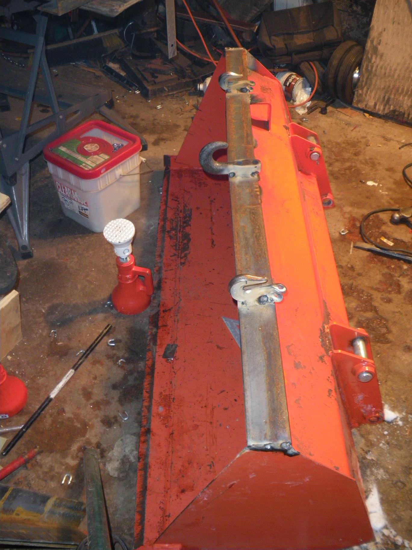

I like a couple hooks for chains and a smooth one for straps. While welding a top brace, you should also weld some material on the bucket side edges.
