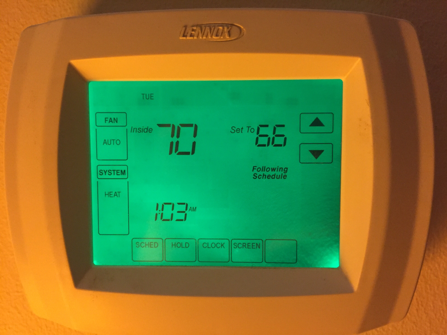

You do want to move your heat temp up gradually so that aux heat doesn't kick on. That will negate your savings.
   / Has your electric bill gone down if you have a lot of LED bulbs? #58
I read awhile back that they make diff stats for heat pumps, mine will do this I'm pretty sure but I will have to check.
I read this specialized stat will delay the heat banks from firing in a schedule for that reason, if you swing too much then it fires off the emergency heating coils thinking the heatpump can't keep up which burns way more electric then just the heatpump.
My stat knows it's controlling a heatpump, past that I forget if there was an option of delaying the emergency heat when it runs the heatpump or not. I remember it can only start a max of 4 times an hour to save the compressor under a short cycle.
But I only swing 2 degrees on my schedule and do not gradually go up.
With a gas furnace it's usually on or off, it's usually firing at 100% or 0% so the idea on that would be less run time overall.
I like the 2 degrees mainly for the comfort reasons, it saves me a little money but even when I'm home when it's lower I'm the winter or hotter in the summer it's not a huge change in temp and most the time isn't really noticeable.
