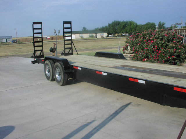

I have just recently purchased a Mahindra Max 28 with a FEL and a backhoe, now I'm in the market for something to haul it with. I was original offered a trailer with 7 thousand pound axels by the person that sold me the tractor but when I came back I was told by another person that that was too light duty of a trailer and the axels would bow eventually and they said I needed a trailer with 10 thousand pound axels. Which would be the best for my needs?

A trailer with 7 thousand lb. axles will give you 14 thousand total capacity. Your equipment weighs less that 4500 lbs. The trailer would have more than enough capacity to transport your equipment.
This is my trailer and it has 8,000 lb. axles under it.

For a Max 28, you can do fine with a 7K gross (i.e. tandem 3500# axles) trailer. I'd get one at least 16' long, if not 18'. That will leave you with approximately 5000-5500# payload capacity, which is way more than the Max weighs even fully equipped.
I have hauled similar and larger tractors on my 16' tandem axle landscape trailer with 7K gross, and have plenty of margin. I use up all the available length in order to balance the load for good tongue weight.
A landscape trailer is probably fine for a Max, but for larger/heavier tractors you would want ramps, as rear gates on landscapers have their limits. So consider going up to an equipment hauler or car hauler with ramps if you see any heavier tractors in your future. A rear gate was fine for my B2920, but I use ramps or drive on directly when loading my heavier L3200.
May also want to factor in your tow vehicle and what it can pull when making a decision.
Good luck!
