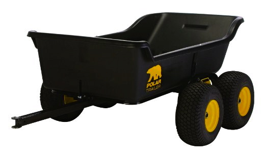

Nice vid, I've been looking into one of those type trailers as I want to be able to use an atv or compact tractor to pull it. I like the winch/cable lift system for simplicity and versatility but I'd prefer an electric winch over the hand one, not so sure about the walking tandem axle for yard use though it seems to me it would tend to tear up the turf making shaper turns?
MUTS trailers are the Gold Standard. I have one of the first generation MUTS models with a single axle, no longer available new.

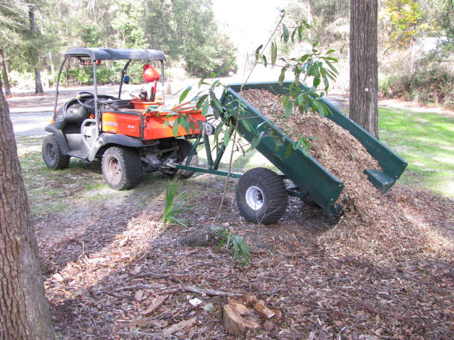

I have used my fifteen horsepower Kubota RTV500/HST to pull my MUTS loaded with dirt on level Florida ground and roads. The nominally 15.8-horsepower Utility Vehicle with HST pulls it OK, although acceleration is slow. Slowing is hazardous. The load wants to jack-knife. For hauling dirt a tractor is safer motive power better matched to weight of trailer load.
Most of what I carry in the MUTS is brush and wood debris and water in big pails. For this the MUTS is superb and the hand winch entirely adequate for me at age seventy-one. RTV500 is entirely adequate motive and stopping power.
A Polar Trailer is much cheaper and even simpler but does not dump completely. Shop Lowes and HD via the web for Polar prices, single and dual axle models. Polar videos on U-Tube.

LINKS: MUTS - Multi-Use Trailer System for your ATV, Quad and 4 Wheeler
Kubota RTV500 + MUTS Trailer + Kubota B3300SU + Wallenstein Chipper

I think the DR Versa is made over seas. There’s a number of companies that offer same Trailer with their name on it around the world. If I’m not mistaken they are copies and then expansions of the original MUTS design.

Box shape on trailer is fine. As you realize, dropped bottom makes MUTS trailer very stable empty and very stable under full load. I need the trailer to go everywhere my Kubota RTV500 goes, which is everywhere.
