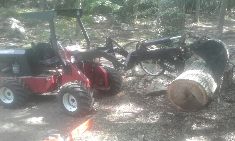

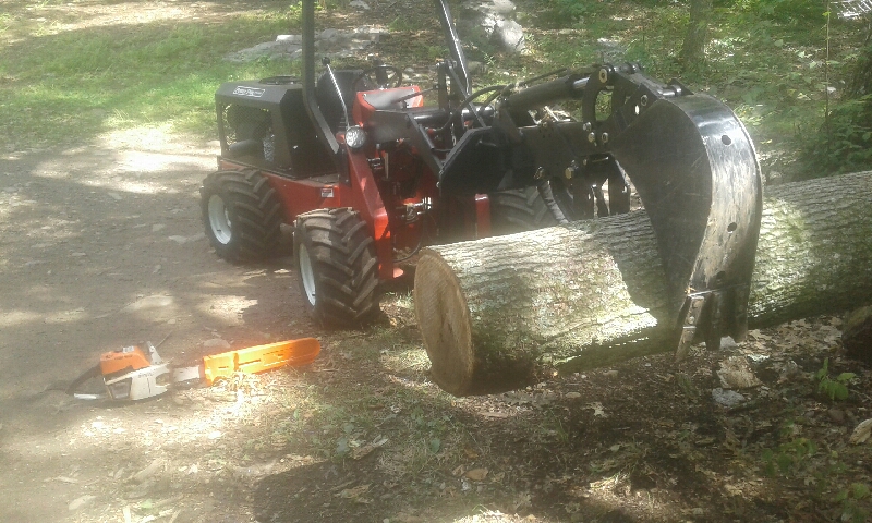

Had a large oak kill by the caterpillars on a hillside boxed in by a lot of other trees. Cut it down and needed a way to carry the larger the better pieces out. I have a Kubota L2850 with 2400 lbs lift at the 3pt and 1800 lbs 24" out from lift ends. So I figure the Kubota has better/even traction and technically more lift. So I put a 3pt adapter on, then fork lift forks. Slid them under a portion of the tree and after a big fight, tractor can barely lift it, front end coming up, steering with brakes etc. Well I tried the Power Trac, with only 1200 lbs lift. Had the front hoe attachment with a thumb, so now lifting 36" away from quick attach plate. What do you know, the PT lifted and carried the log out better then the Kubota even know the specs for the Kubota exceeded the PT. Guess they rate the PT very conservatively. Wish the drive system was a little more even, if I start out slow and easy the front wheels spins. If I start out aggressively, they all spin but very little, go figure. Guess it is the way the tram pump controls the flow.

Me too, maybe the pressure is low as it could only lift it about 1/2 way up, but just the same the front of the tractor was up in the air so it shows that the rear was real heavy. I was going to add weights but then it still had trouble lifting it, so why go through the trouble. At that point I figured to just try the PT, and as it has done many times, it impressed me.

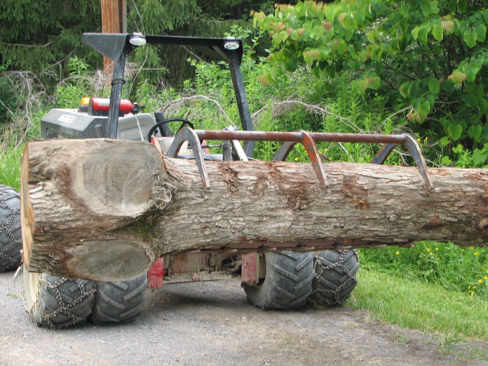

Mine certainly comes in handy for carrying logs either in a mini hoe or grapple.

I thought the forks would work better too, but the L2850 would only get it about a foot off the ground and then there was the front end lift that was problematic, end up dragging the log anyway. All logic aside, even with 1/2 the rated capacity, the Power Trac lifted the log and climbed out of the work area.
It is difficult to cut on the hill because after the log is cut off it tends to roll down the hill and they end up all over the place. And even if it didn't roll away, I can't fit that many cutoffs in the bucket as I can carry in one long piece.
