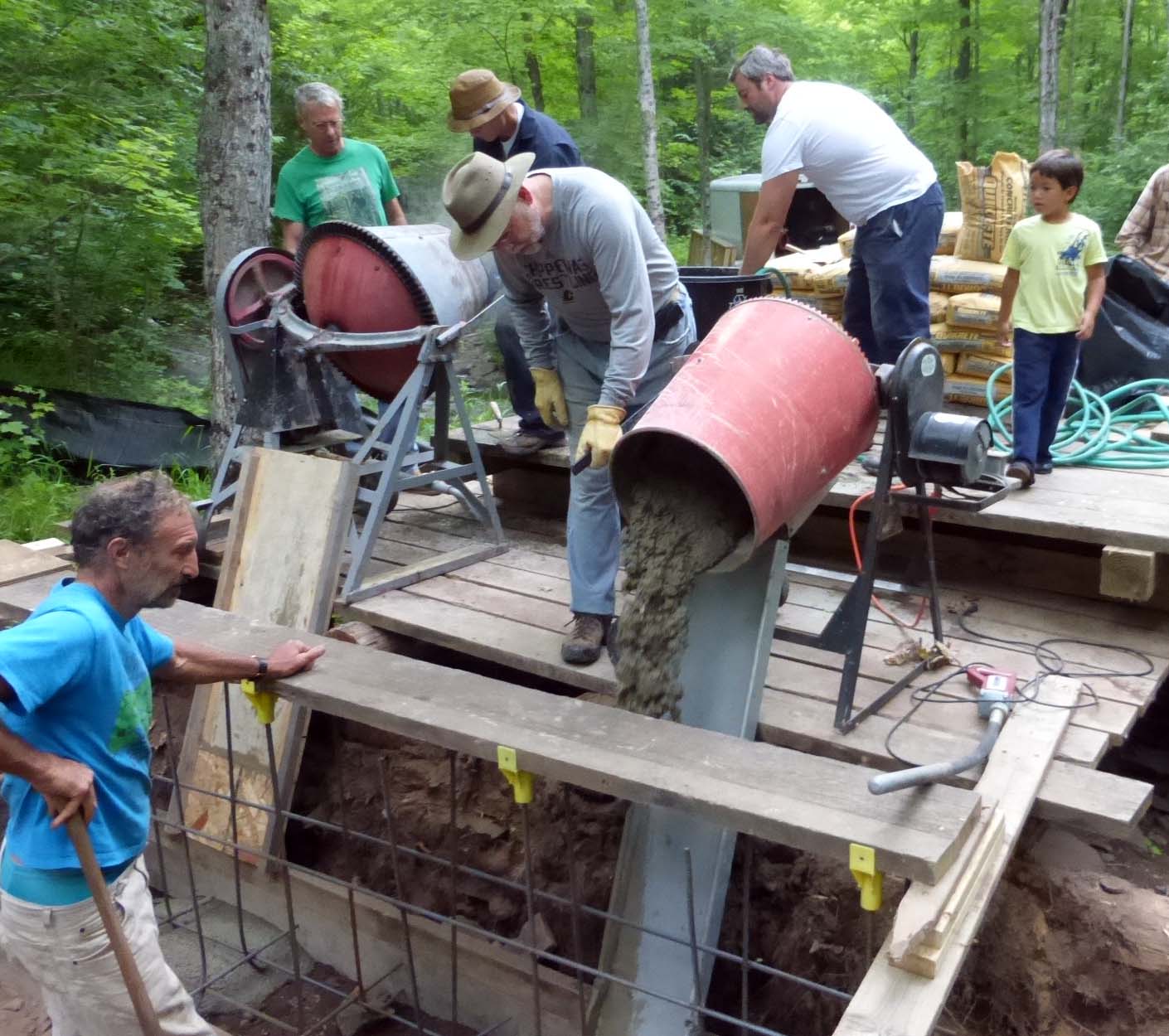

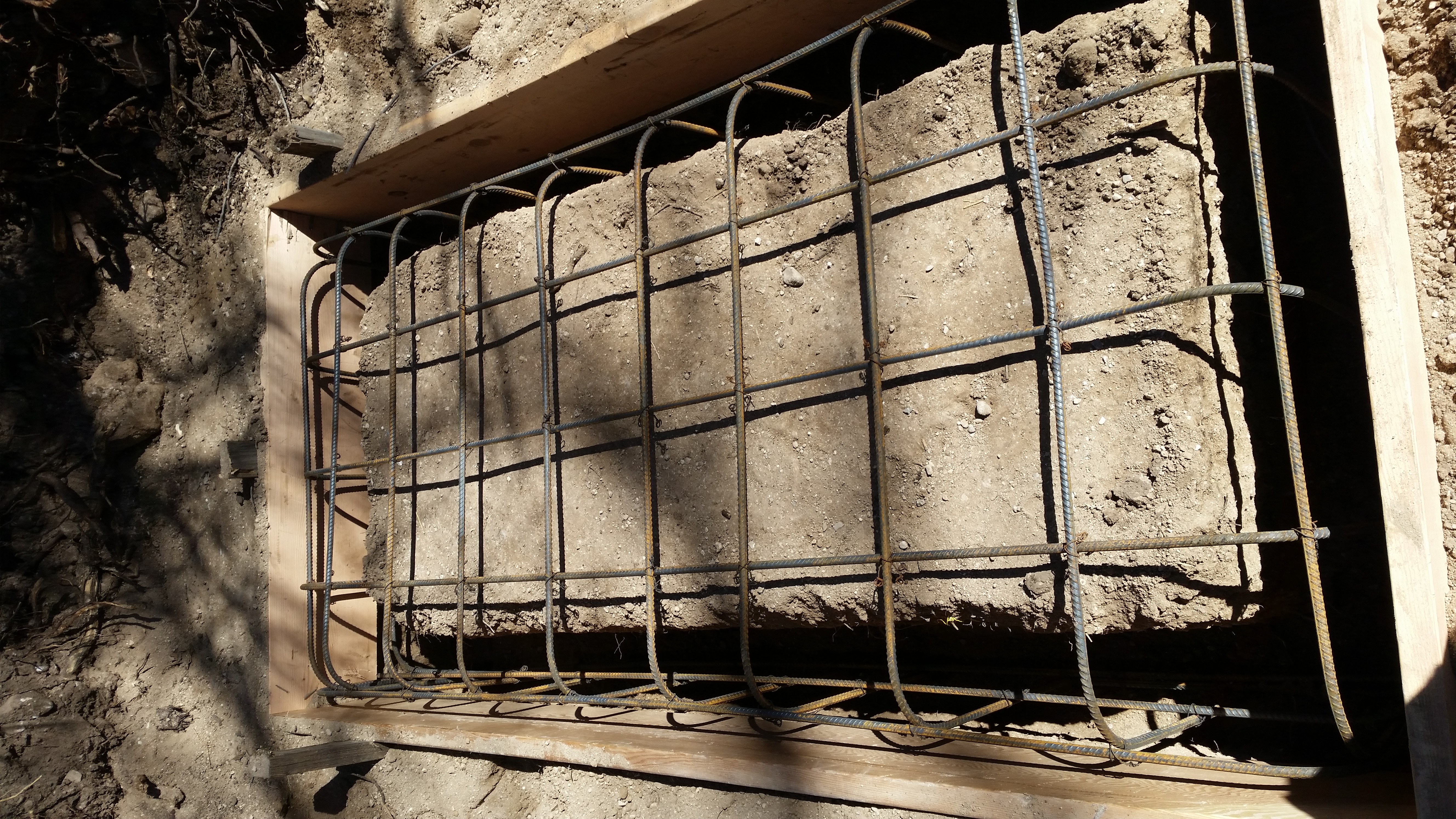

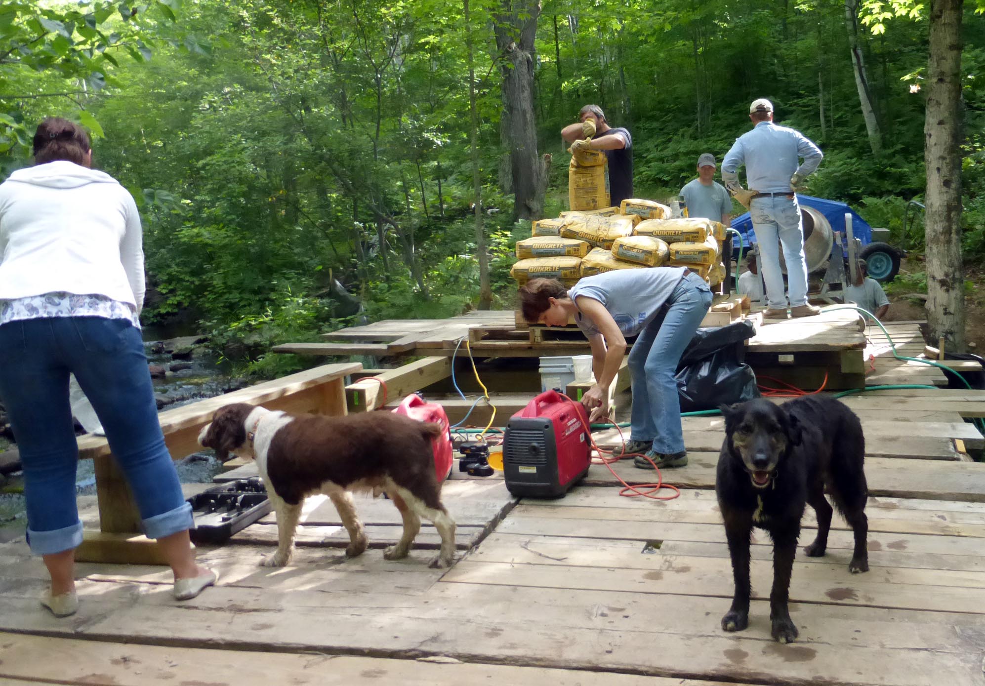

We have a bit of experience at mixing concrete. (sorry if someone has already mention the following) The problem with moving mixed material, is the aggregate settles to the bottom as you drive to the job and its very, very hard to get it mixed back in, that is to make it correct/consistent. We had an bridge abutment pour and did it on site using 100, 80lb bags since we could not get a truck to the job site.. Attached is some photos. This was setup with the bags being somewhat higher than the mixers and doing that, reduced the labor, lots!. This worked like a dream and with 2 mixers running, we had them poured in less than 4 hours.. As another fellow mentioned, most people add waaaaay to much water to the mix.

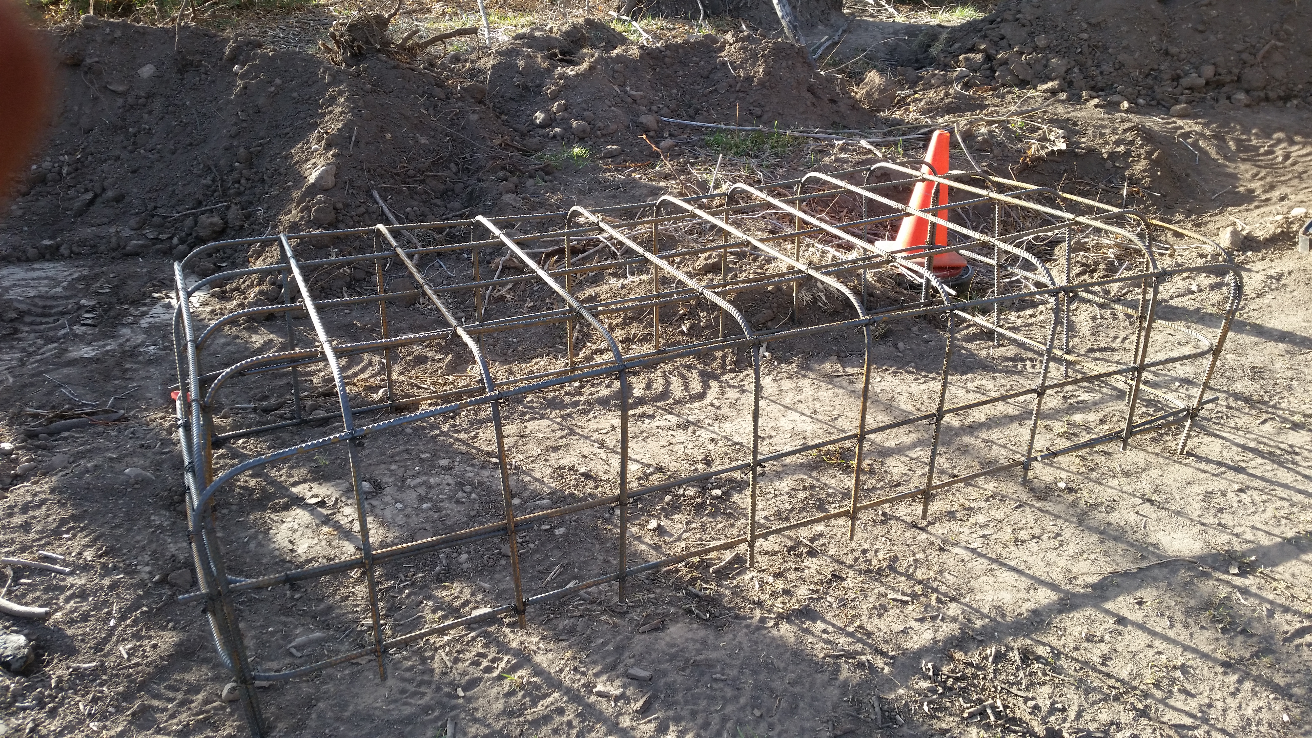

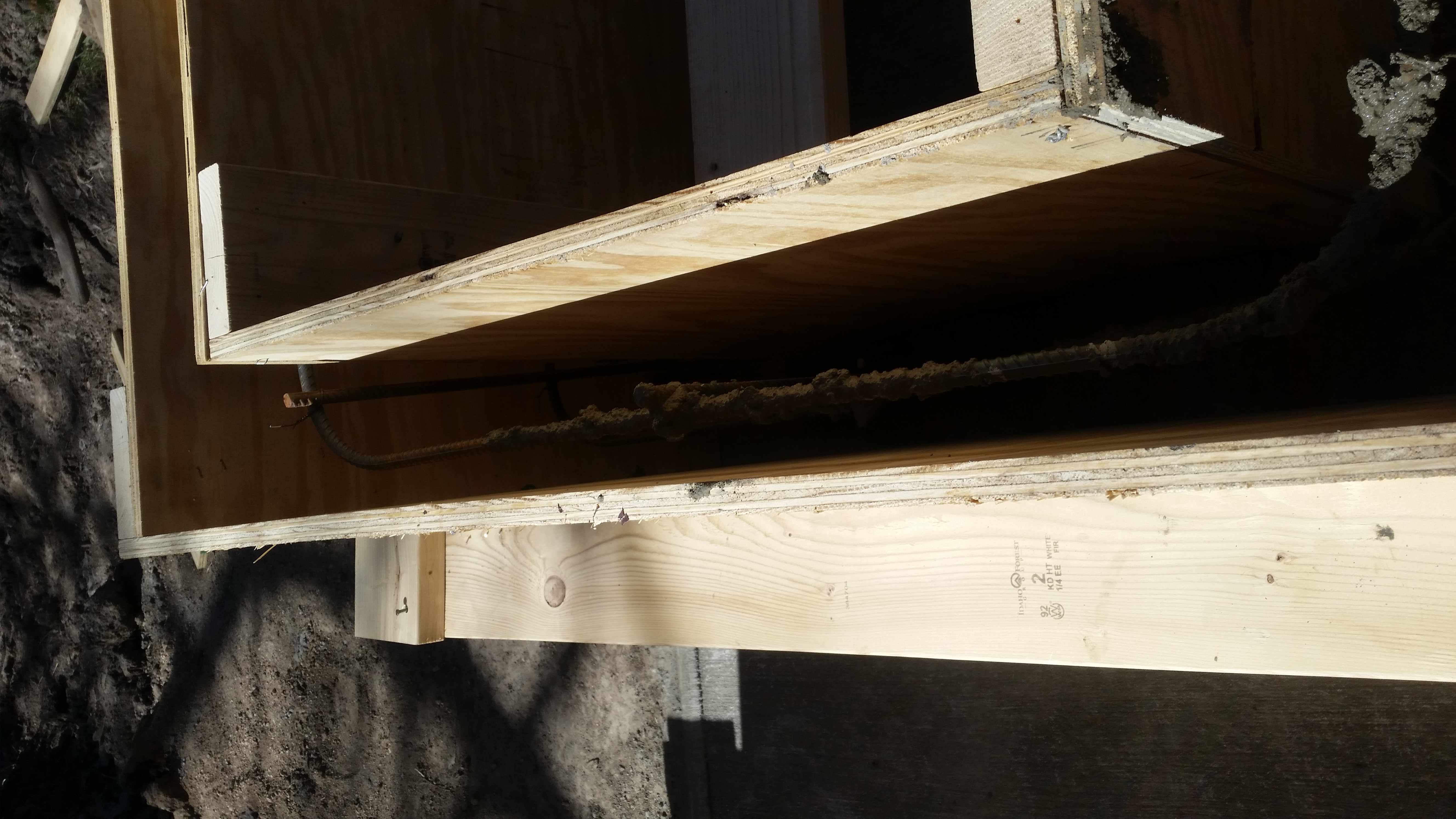

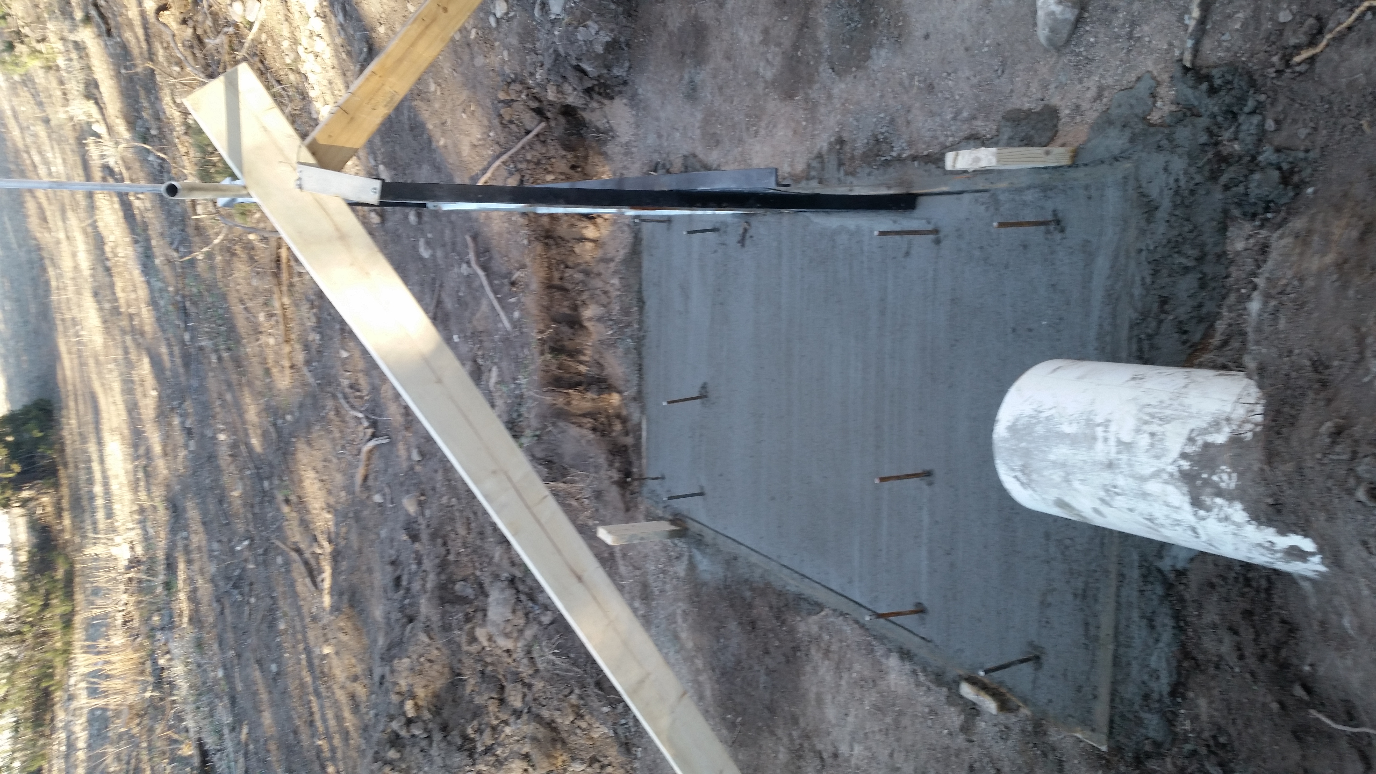

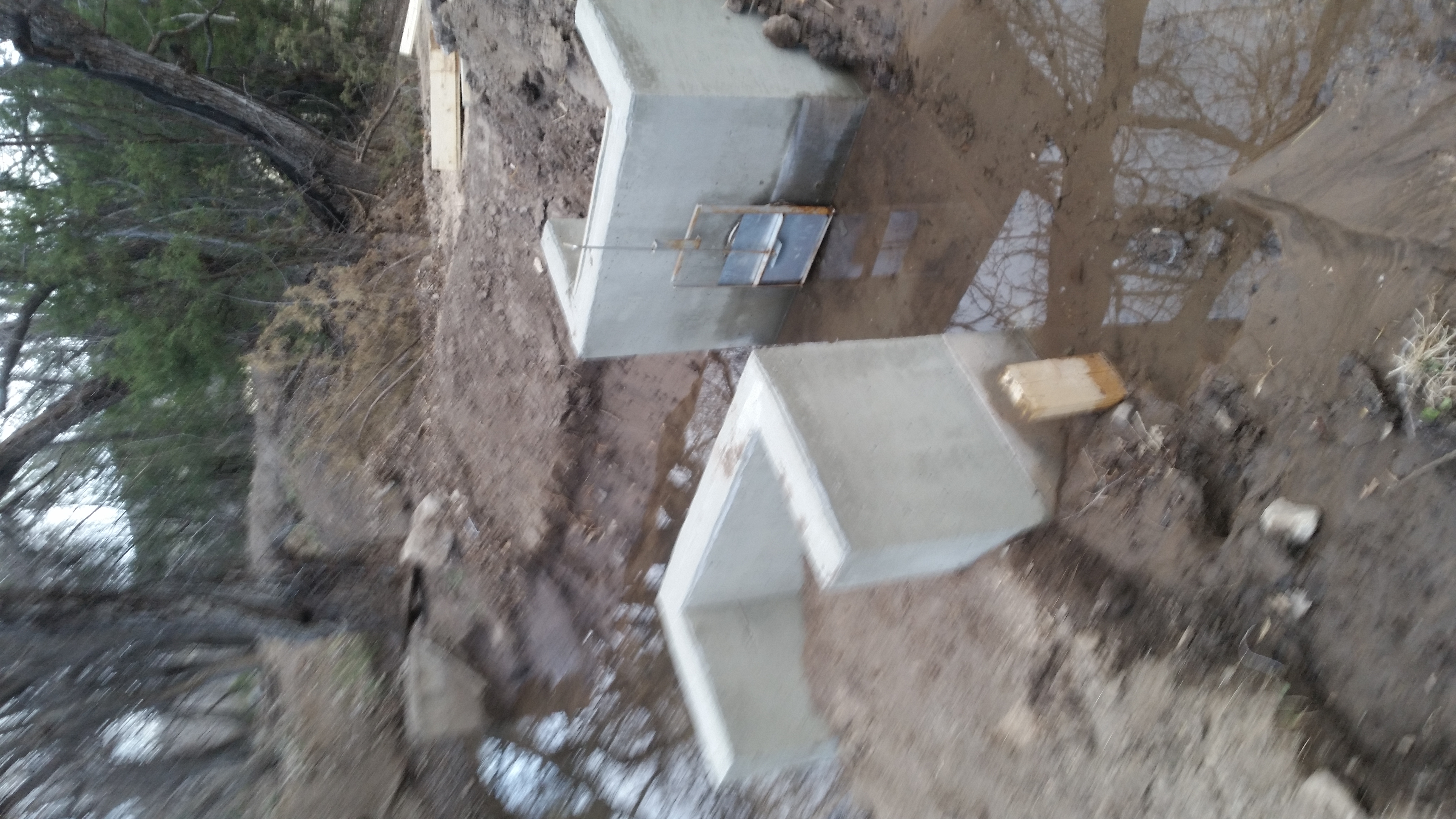

When building boxes on the irrigation ditches where I can not get a mixer truck I use this set up. An F550 service truck with generator and water tank in bed, run water hose and extension cord to form location. Use the 110 to carry two thirds of a pallet of sackrete and adjust height for easy transfer to the mixer. Use a wheel barrow mixer within a couple of feet from the form. Nobody has to work very hard to do this and can mix about 1 pallet an hour (rough guess).
For the formed walls it helps to have a second person to help dump the concrete into a bucket to pour in the walls. The slabs I can do by myself.

All you guys have good stories. The last picture of the bridge pour was interesting. If I had all thise volunteers, i would have used my mixer!
