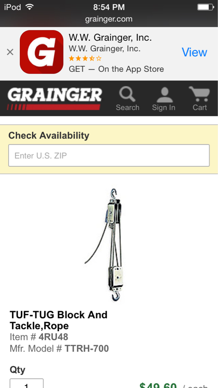

Compress it and lock it down. Run a rope from front corner to other front corner, enough slack so it will loop up to the top of the load. Another between back corners.
Get a block and tackle and pull the two loops towards each other at the top of the load image-4014311773.jpg
