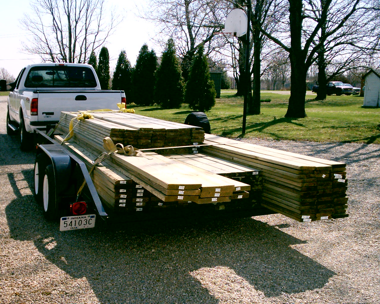

Yep, that is basically what I have but with a wood deck. Its a 7,000# 18' by 76" wide trailer with a rail. I have hauled a Suburban and 20 other cars. The longest haul was a Lincoln Aviator 250 miles from Detroit Auction. Its fitted with a winch and a strap box on the tongue so everything is always right there. It also has a spare tire on the opposite side.
It has hauled everything listed above and then some.
Chris
