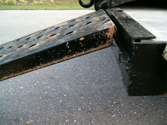

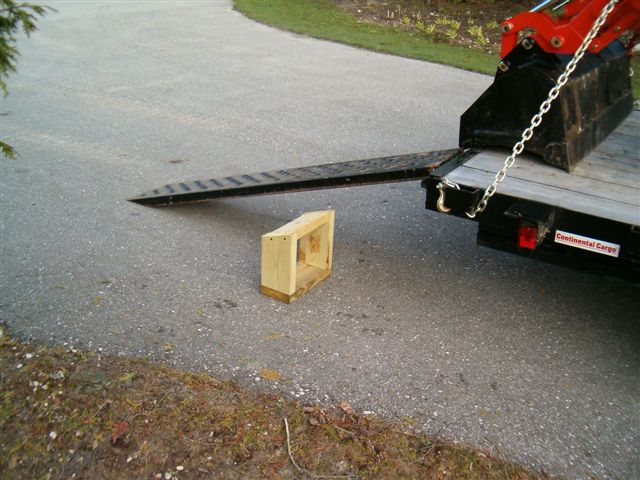

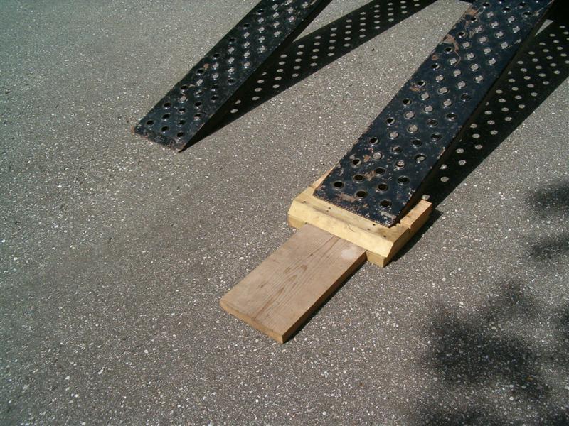

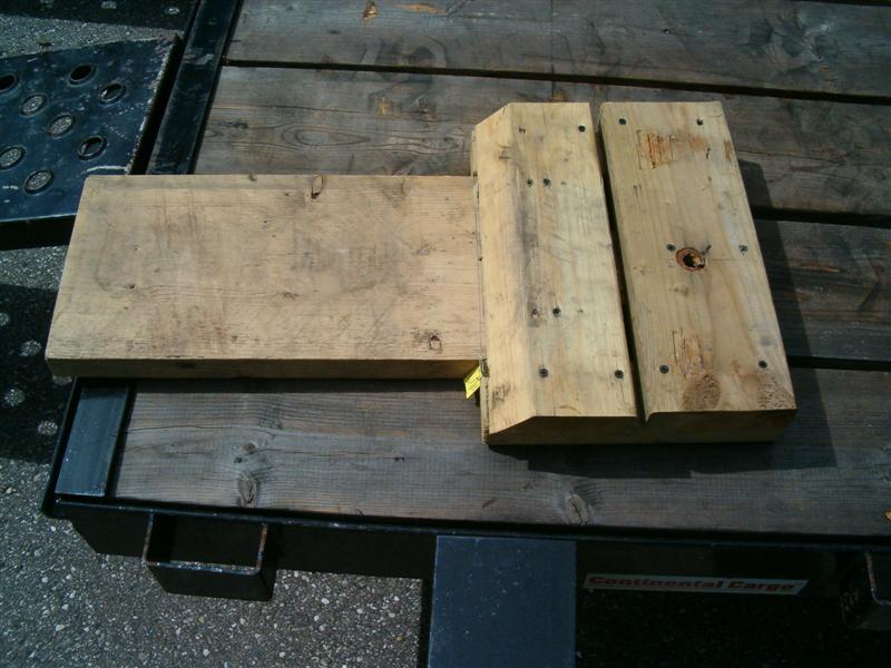

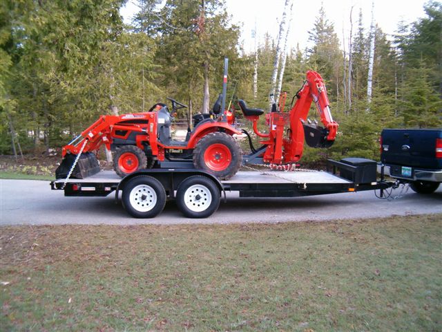

A picture is worth a thousand words:

What length trailer is that and who is the manufacturer of it?
16' long and it's made by continental cargo

well, maybe so but you have to remember my tractor has a backhoe and with that attached the
CK20 with backhoe and front end loader weighs in at 4000 lbs. But you are probably thinking what makes that different than a car. The difference is the entire weight of the tractor is solely on the ramp as it has a much shorter wheel base then most cars that only usually accomodate one axle at a time unless maybe it gets compared with a YUGO. The trailer gross rating is 7000 lbs. and is adequate for the tractor.
All 4 tires of your tractor can fit on the ramps at one time ?, doesn't 'look' that short/long.

My TLB manages to drag a bit also but I made some wood plates that space the bottom of the ramp up 3" lowering the angle. That took care of the drag. So far as lifting the front of the truck I always try and prevent that by slipping in a couple of jack stands beneath rear frame of trailer and I even chock the front of tires to keep from pushing the rig ahead as I load the trailer.

now I see why his ramps bend. I wouldn't load anything latrger than a scut or rider mower with them.
I use heavy 2" angle for most of my ramps.. my '3rd' ramp for my trikes is 3" angle, as it gets a huge portion of the tractor weight till the rears get to the other ramps
i think that wood block arangement will be dangerous. at least the way it is mocked up.
solid timber cribbing.. maybee.. beter ramps.. deffinately.
my life is worth way to much to use 'just barely-maybee' ramps loading LARGE pieces of iron...
