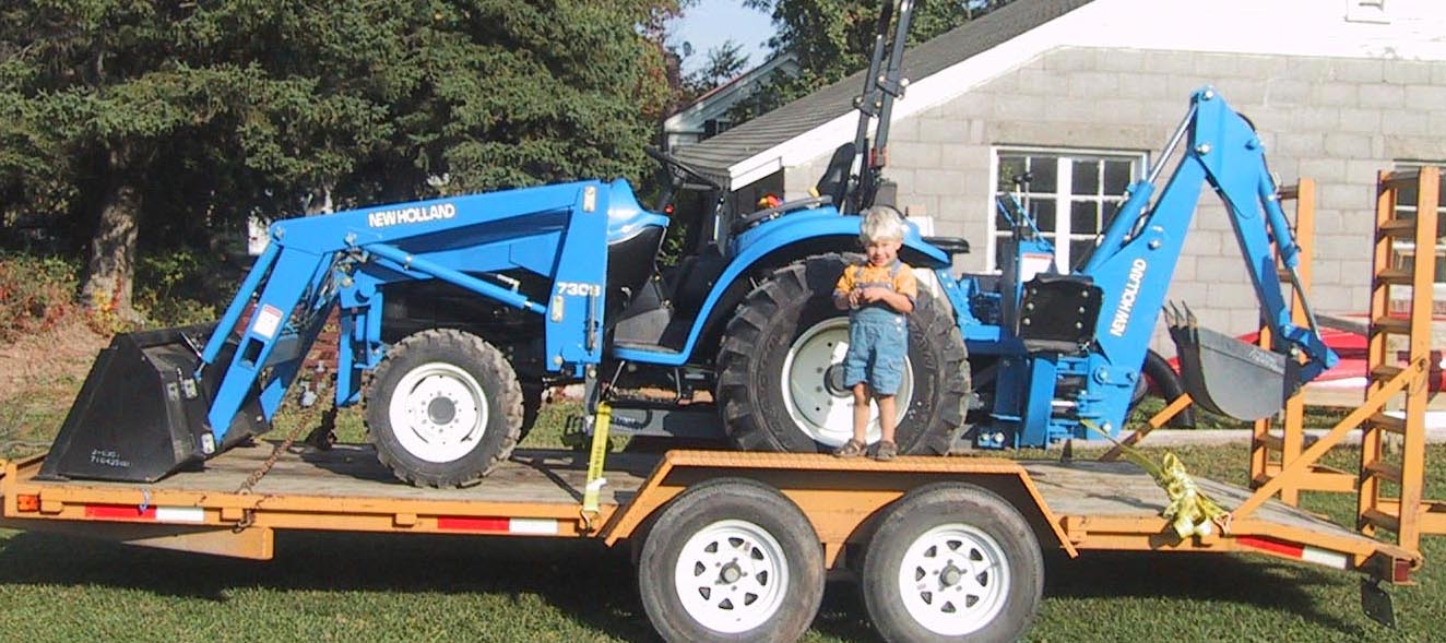

Brandon, I don't have a photo of my tractor on a trailer with my rotary cutter, but here is a photo of my TC45D the day I went to pick it up from my dealer. My trailer is 18' and you can see that a cutter would hang out about 3' to 4' if you count the trailing wheel (you could take it off). If you take the cutter off and put it in front, you just might end up with more weight in the rear of the trailer than the front and that is not good. Anyhow, I hope the picture gives you some idea of what you are up against. The TC45D with loader and rotary cutter is at the maximum weight you can carry on a 7,000lb trailer. If your tires are loaded, you will be overweight. You should consider going to a trailer with axles rated heavier than 3,500lb each. A 24 foot gooseneck would be just perfect, but they are pretty expensive unless you haul your tractor a lot. Good luck. /w3tcompact/icons/smile.gif

Jim,
Great picture, very helpful!

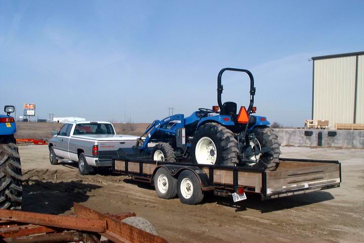

I only have a medium size boomer but mine seems to fit well on an 18' trailer with an 8000 lb rating pulled by a K2500 Suburban. I was glad to hear that you had a 12000 lb trailer for your big boomer. So far far I have been loading the tractor facing frontwards with the bucket right up to the lip of the deck since this is how the dealer told me to do it. I do have a problem sometimes with the frame of the backhoe scraping the ground when unloading. Does anyone have any hints to solve this problem. Next time I think I will try loading it backwards to see if I don't get the scraping. When I was shopping for a tractor last year I almost bought a used TC40D with 50hrs. It had a trailer with it that was 10,000 lb and I believe 20' with a pintle hitch setup.

<font color=blue>I will be trailering the tractor about 60 miles several times a month and occasionally 300-350 miles to my other place</font color=blue>
That frequently, and for that distance, I would be very hesitant to trailer it with anything heavy hanging unsupported off the 3 pt hitch. There was a thread here somewhere on TBN about damage to the 3 pt hitch caused by heavy loads bouncing on it (and since the mower hangs way out, that's quite a long lever you're hanging that load on). This was in reference to driving the tractor at high speeds over bumpy terrain/roads. Your probably on smother roads, and have the trailer suspension to help absorb the shock, but you are also at much higher speeds. I forget what the actual damage was (something internal, if memory serves...) if you do have to haul this way, perhaps you could rig up something with chains to the far end of the mower to carry the load?
Removing the mower and putting it under the FEL, as others have suggested, is probably a much better way to haul it long distances.
