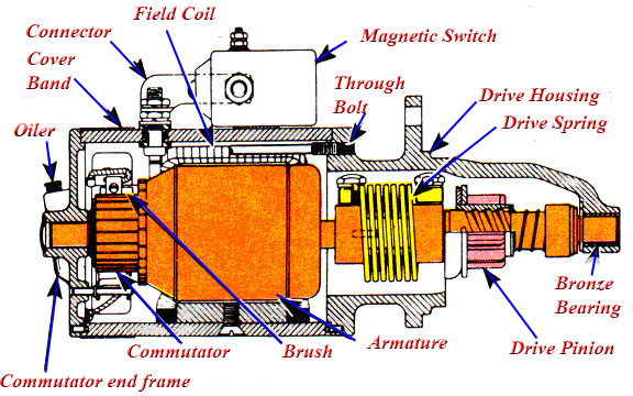

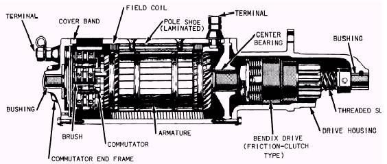

Bendix on the starter could be hanging up next time try tapping the starter and see if it wont kick out
/ Haunted starter ! #11
If it is this style, the bendix needs to be cleaned and lubricated.
If it is this style, you can troubleshoot it with a voltmeter.
