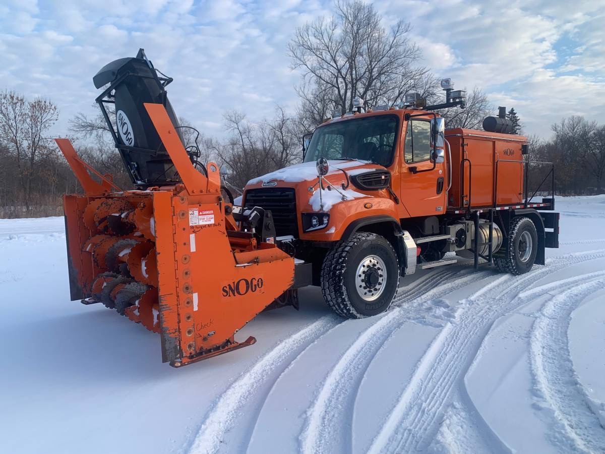

Obviously you need one of theses !
Ironically, I HAD one of those. An older version that I thought I got a good deal on, but it ended up that the fan belts that it used were worn, and there were no replacements ANYWHERE, they were an odd size that no one had, So I sold it to a collector. I think it was an 1952 International.
