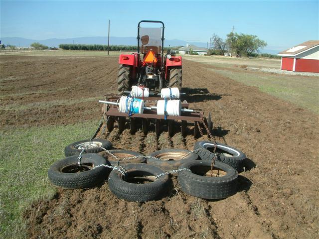

Looking for advise...I have a new property approx 20 ac in size that has been left unattended for several years....I would like to rid myself of the weeds and reestablish the pasture....other than the obvious(bush hog...already done) what should I do to re-establish grasses vs weeds....My first inclination is to run a set of disks then broadcast seed....Im concerned that all of the cut weeds are just going to bind up and the disk would be innafective....has anyone out there been in my shoes??? If so, I'm all ears!
You need a heavy offset disc to cut through the stubble left by the brush hog. Mine is an old 7-ft Towner disc, pretty heavy itself but I add about 500 lb of concrete weights to get it to work better. You need to run a disc like this fast--5 to 6 mph- to get it to work effectively. You only need to till the soil 3-4 inches for grass planting.
I attach a tire drag to the disc to bust up the clods. I disc a 6-acre hayfield (Kanota oats). I got the disc and the tires gratis from several neighbors. Spent about $100 for new disc pans.
Broadcast the grass seed since you're planting pasture instead of a hay crop (I use a 10-ft wide grain drill to plant oats on my hayfield).
