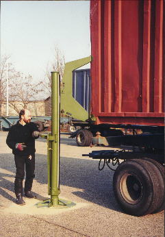

Container jacks:
Jackstand mechanical ISO container handling system
Several kinds here:
High Lift and Leveling Systems

   / Have anyone build or buy a crane or mechanism to load/unload shipping containers? #13
Thats pretty much what I was thinking of, but with a hydrualic ram to make loading and unloading a one person operation (although, you might need a davit crane on your truck to load/unload them).
