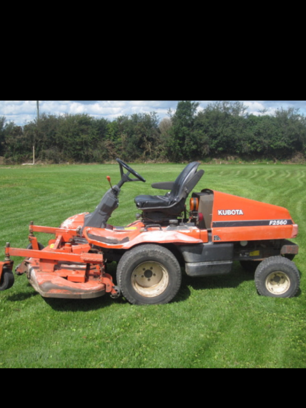

You will be disappointed. I mow for a guy, and use his cheap mower. I hate it, if I had a lawn mower trailer I would take my mower. I also have a Dixie chopper. On smooth flat ground it does good, but on hills I like my 4WD BX better My favorite mower is the F2560. My BX is an old one without power steering. I would like it better with power steering.
   / Have BX2350, considering smaller riding mower for yard #22
image-1387222456.jpg I wish the F2560 was 4WD. It turns super sharp, and mows smooth.
