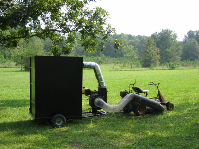

   / Have you built a leaf vacum? #23
Heres a picture of the leaf vac that I built out of mostly parts I had laying around the barn. The trailer frame is made from an old steel shipping crate. The box is made from 2x4's, wallboard and plywood and is 3.5 x 3 x 5 ft. tall. I made the blower housing myself from 1/8" aluminum sheet after looking for 2 yrs. for a suitable one to convert. The 11 hp. motor I picked up on craigslist for 60 bucks and the 7" hose came from grizzly. I had a new 11" steel impeller that was for a sears/craftsman yard machine which I picked up on ebay and the axels are from an old murray riding mower. I mounted the motor on an old van seat pedistral and its welded to 2 steel supports that unbolt from the frame so as to make it more versatile. The hose from the blower to the box is plain old 7" furnace duct and the vent on top (not shown) is an old floor heater vent. The door raises up and down and runs on slotted rails and is held open with a tractor linch pin (an old bolt works just as good). I pull this rolling outhouse with my trusty 1968 snapper mower with a high vac blade.

   / Have you built a leaf vacum? #26
I built a leaf vacuum last fall and agree with what amashinga is saying.
Some things I learned along the build:
-The inlet to the impeller unit should be approx. 1" larger than the output.
Mine is 8" going in, and 7" discharge.
-You need to have enough vent area (screen) to allow free air to move out of the container. This causes a sudden pressure/velocity drop so the particulates "fall out". Well most of them. ;)
-Use a wider wheel base and/or weights to keep cart from being tippy when getting full. I'm using a standard craftsman tow behind cart, it had a 32" 5/8" axle. I bought a 36" peice of 5/8" stock and replaced the axle to gain a little wider track, which lowers the center of gravity and stabilizes the side-to-side play. I have thought about using weights, bolting to the bottom of the cart, or maybe makeshift wheel weights. Weights would be especially good if you are traversing inclines.
