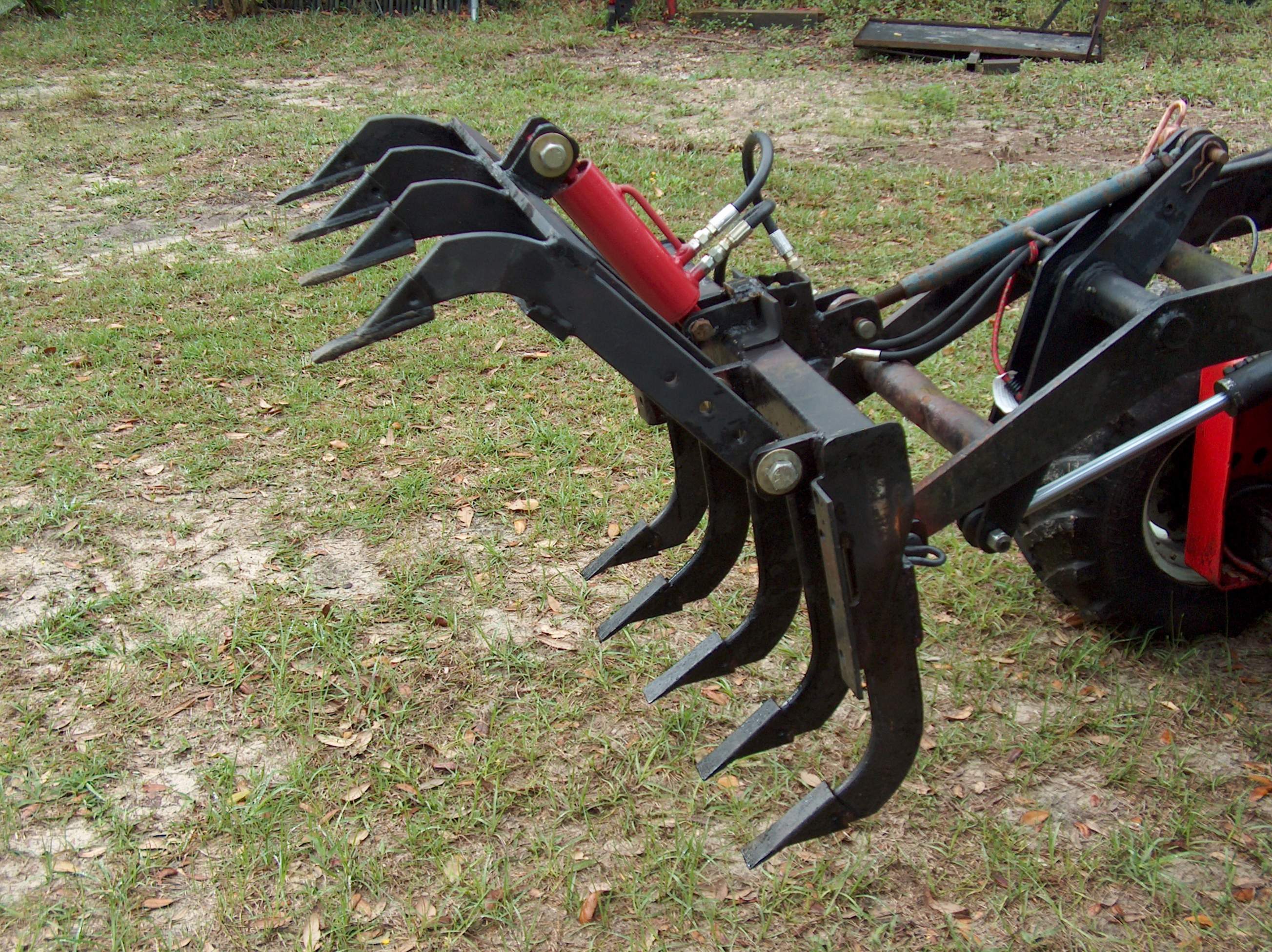

Here is a small grapple I built using the ripper shanks.
JJ,
How well does that grapple work with the short bottom teeth compaired to one with longer bottom teeth?
   / Have you tried the HF metal cutting Circ Saw? #56
Since the longer shanks are a little higher, the points touch well, and actually go past to close tighter.
I use the bottom shanks as a root rake.
Thanks for the explaination JJ,
I was wondering if you lost much for carrying things with the shorter bottom length. However, I imagine that the shorter length is probably less likely to bend when digging with them. Probably less cost and weight than the other style of rake/grapple as well. All-in-all, I like your design. Thanks again.
JJ, That little grapple looks cool. I'm going to have to keep that one in mind for a future project. Good work!
