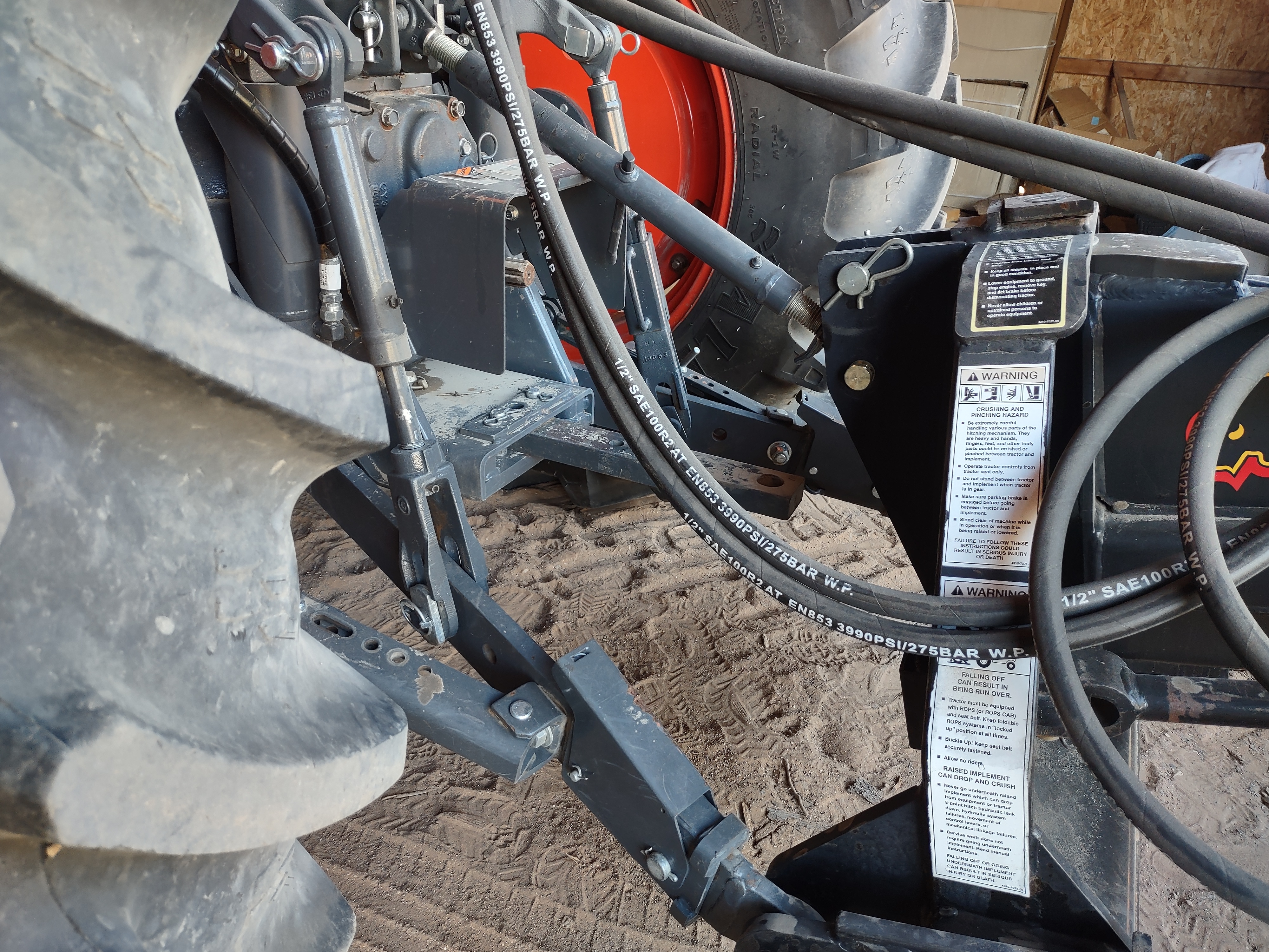

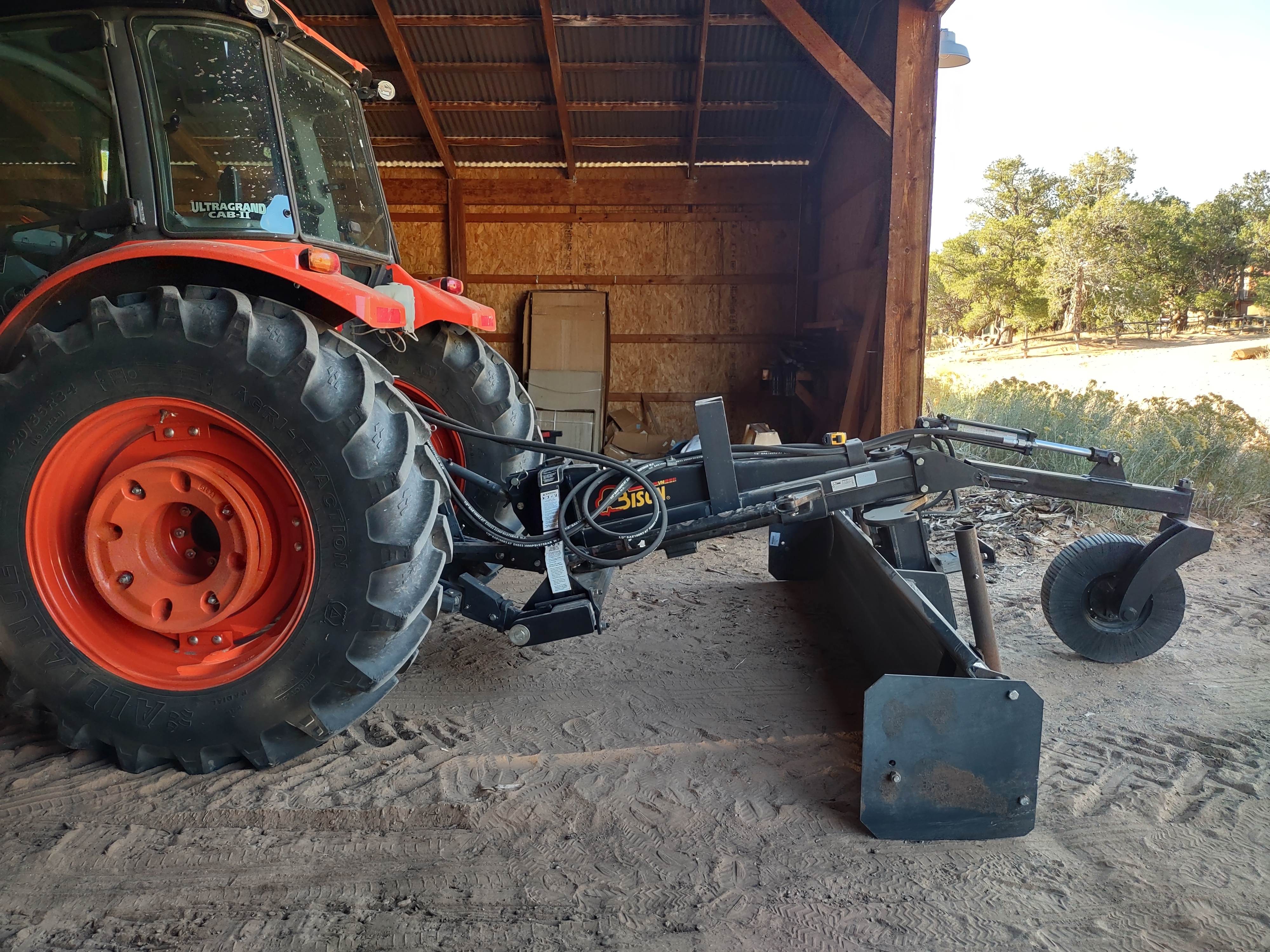

First let me say I'm new to tractors, so I might be doing something stupid, but I'm having a great deal of trouble removing/adjusting the rear blade I bought for my tractor.
Right now it's on the 3pt, but it's not adjusted right. When raising the 3pt it doesn't start picking up the blade off the ground until the 3pt is hitch has already raised 1/2 way. So when hitch is raised as high as it goes, the blade is only off the ground about 6-8 inches and the boom is sloping down towards the ground at about a 15 deg angle (just eye balling it)
So I believe I have to shorten the top link on the 3pt. I was able to shorten it up a little, but then the back of the blade/3pt suddenly gave way and dropped about 8 inches (blade was resting on the ground). From then on I couldn't seem to get tension off the top link to adjust it or to remove the pin to take the blade off the 3pt.
As it stands right now, I can't even get enough tension off the the top link to remove it.
Here are some pics showing the 3pt and blade in the lowered and raised position.

The "tips" of your lower arms are angled down. You are loosing considerable implement height off the ground because of this.
In any case - 6" to 8" should be enough ground clearance for most any implement.

For starters, I would try using the higher toplink mount on the blade (assuming that's what I'm looking at).
Adjust the toplink so that the blade frame is parallel to the ground in the lowered position. There will be some point in the lifting height where the toplink will loosen up allowing removal or adjustment.

I spent about 1/2 an hour this morning trying to find a point where the toplink would loosed up. I could find no where in the range of motion of the 3pt that unloaded the top link.
I had no trouble finding that point when I first installed the blade, but like I said, it shifted when I was adjusting it and now it's seemingly under tension the whole time.
I even tried lowing the boom back onto it's stand so I could remove the toplink pin, but it's bound up in that position too. Even tapping on it with a steel mallet, I can't get the pin to budge... not that I would try to remove it that way, I did it just to see how much tension was on the pin.

I kinda see what I think happened; and the top link at the impliment, kinda went past zero, and hyper extended, so to speed; or it's past top dead center...
So, first, I think it's going to be easier to remove the top link to tractor pin. I know the top link is tight, but you should be able to rotate the adjusting thread enough to get the tractor side out with a drift (a spare pin works well, with a 3# hammer).
If that works, then removing the 3nd of the impliment should be easiy enough. then, I'm 90% sure you need to be in the top hole, and move the other pin into the hole you have the bottom od the top link in.

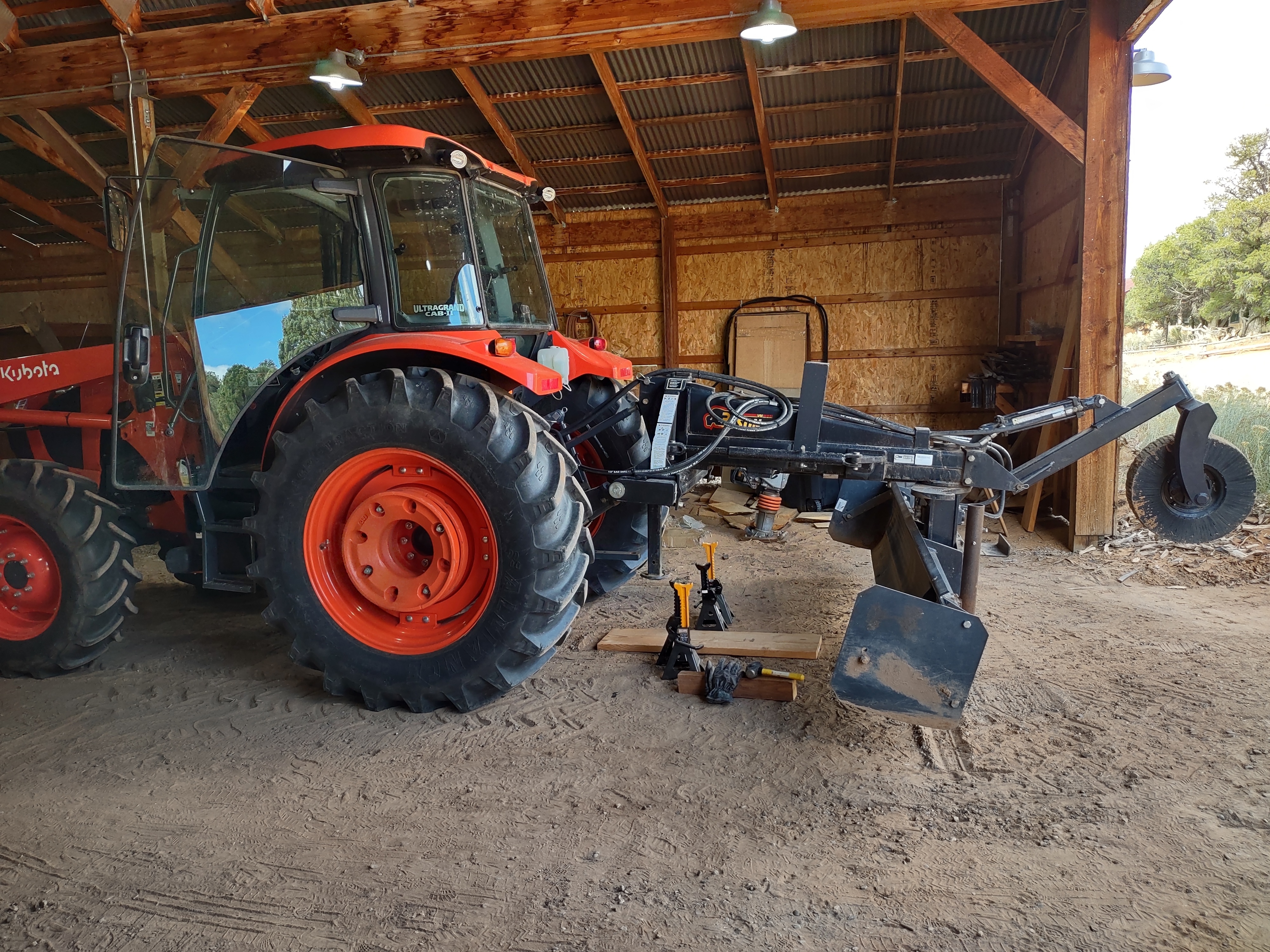

It also looks like (if I'm looking at the pictures right), you can raise everything, and put a jack stand (or a piece of fire wood, or whatever, but something sturdy) under the rear cutting edge, gently set the blade down on it, very slowly, and at the point the top link is in "neutral", it can be removed. at this point, the weight is on your lower lift arms, and you're blocking.

I got it out! I think Paul described the problem with it going past top dead center so to speak.
Basically, when I lowered the blade, the 3pt didn't settle low enough to take pressure off the pin. So I just lowered the tail wheel to apply a rotational force such that it forced the 3pt to lower further. Paul's idea to lower the blade onto a board would have also worked to apply the needed rotational force.
The top hole on the blade is a cat 3 and my 3pt is a cat 2, so I need to buy some sort of reducer. But I did just place the cat 2 pin through the top hole to test the action once I shortened the top link. Now it works much better and the blade starts to raise as soon as the 3pt does. Yay!

I've had the same problem. My solution - move the lower arms to a half-way position. Half way between full up - full down. Lower the tail wheel and use hydraulic pressure on the tail wheel to raise the blade. There will be a point where there is no pressure on the top link.
