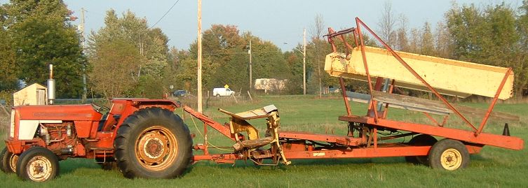

Success!! /forums/images/graemlins/smile.gif
I picked up my balewagon yesterday (9 hour round trip). It's a 1005 model which is similar to a 1000 or 1010 except it only has single bale unload ... it won't stack unload. It's a 2 wide 56 bale model.
Unloaded it today and after doing some raking, baling another field, and hand QTing the bales I baled on Sunday I was ready to give it a go. It worked really well, picked up the bales without any problem. These were 40-45 pound bales**, not too bad (now that I sharpened the knives), but certainly not NH "poster child" bales /forums/images/graemlins/grin.gif. I just had to watch in a few cases as the bales were close together and I could feed them in a bit faster than it could process them. I wasn't running the PTO very fast, and the cross feed chain only has 2 of the 10 feed palls it's supposed to have (will make and weld on some new ones soon ... the dealer wanted $24 each for them /forums/images/graemlins/shocked.gif). I found you had to hit the bales pretty dead center for best feeding but started getting better at swinging the wagon to line it up with the bales better. Anyway, filled it up pretty quick (and fed a few more onto the table as well to maximize capacity), headed back and tried the unload part of the cycle.
It took a bit of jigging to get it working best, but by the end of the load it was going fine. The bales fall onto the table, which you set at a bit of an angle. It's nowhere near as "violent" as it sounds, and the unload feeder then feeds them off so they can drop onto an elevator. My wife came out and ran the unload lever and had no problems dropping them onto the little elevator we have so I could unload them.
I then went out and picked up the rest of the bales and backed it into the shed to keep out of the dew until I get some more in the morning. Another benefit is that it's easy to reverse being a nice long wheelbase trailer (rather than a farm wagon where often my "computer power" can't keep up with the physics and geometry happening with the steering /forums/images/graemlins/grin.gif).
So, based on todays experience I'm a big fan of these things already! I'm thinking in the long run I want to get stack unloading capability, either by adding it to mine (which doesn't look like too big a deal ... especially if I can get a look at either a 1000 or 1010 model) or by "moving up" to a model that'll do it.
I've attached a picture of it before I headed out. I'll add a full one in a follow-up post.
cheers, Andrew
**PS I have the tension cranked all the way on the NH271 baler and these are are dense as it goes. I did make a few 80# ones a week ago when I had the extra chute on, plus I think the grass was slightly damp and wasn't sliding at all. I packed it in since I was then breaking the strings.
PPS. Tried stacking some of these on edge too ... works well ... think I'll switch to doing it that way all the time.
PPPS. Thanks again for all the help /forums/images/graemlins/smile.gif

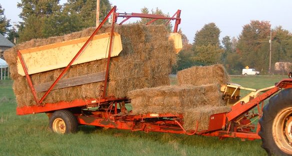

Here's the "after" pic with the wagon loaded with bales (plus the extra ones on the table).
Should also mention that the two wide size sure fits well with the narrow entrances to my fields right now ... and is an easy fit into the driveshed.
Didn't take any unloading pics (getting dark /forums/images/graemlins/wink.gif), but could do so if need be.
Have to weld up that QT chute PDQ ... don't want to hand QT the next few hundred bales /forums/images/graemlins/tongue.gif
