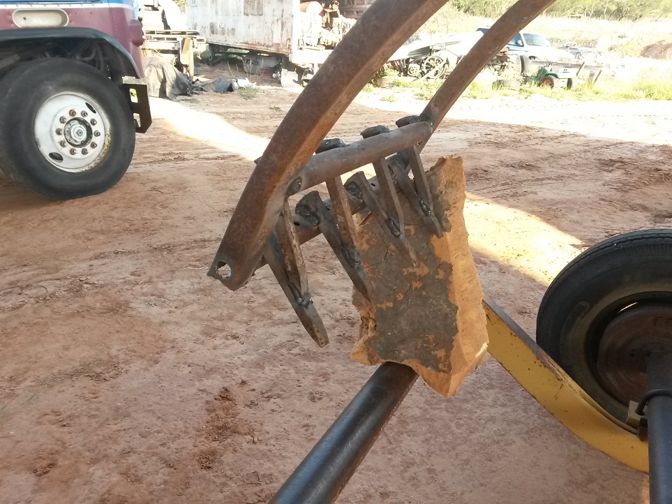

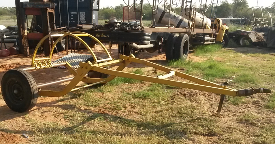

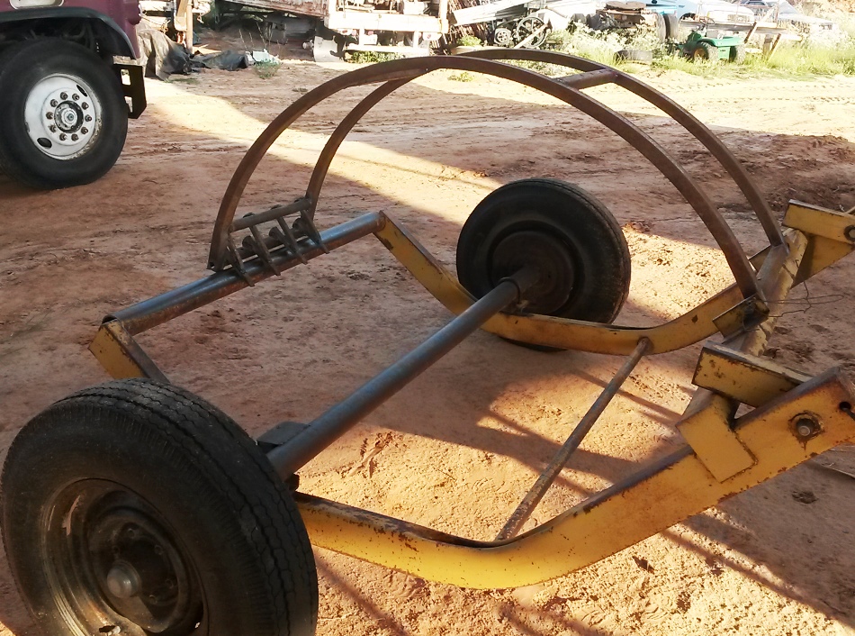

someone borrowed my neighbor's hay dolly and brought it back without the hook
So she dropped it off the other day
I rolled a pair of tubes to match the diameter of the bales then used rr spikes for the points
   / Hay dolly hook
I got it fixed for her just in time because she told me today she was going to have to haul a couple bales tomorrow she has been having the bales loaded for her then she can dump them her self but now maybe she can self load. We'll see if I need to bend the spikes in a little for better hooking
