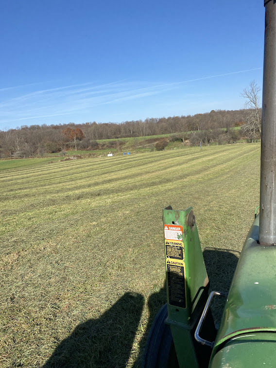

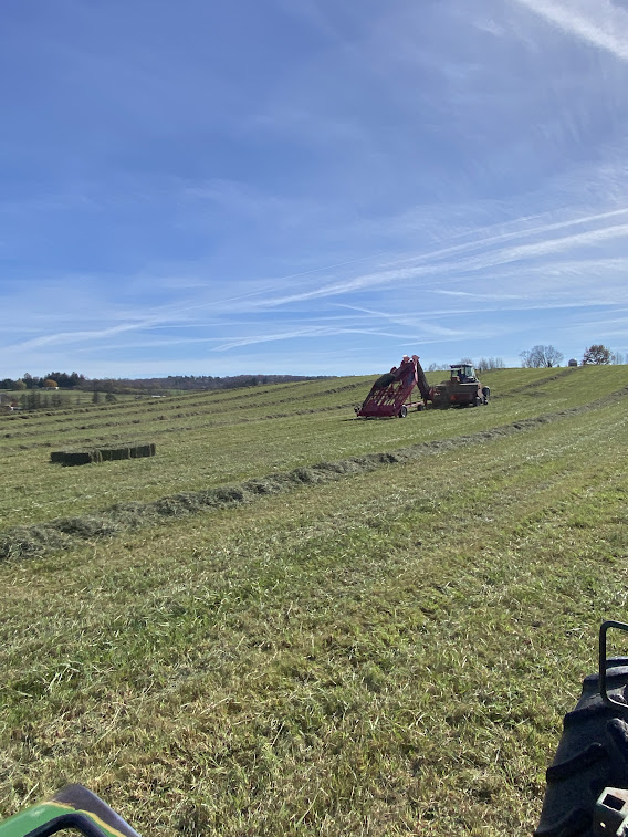

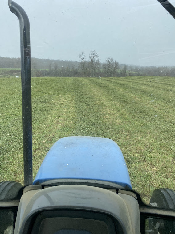

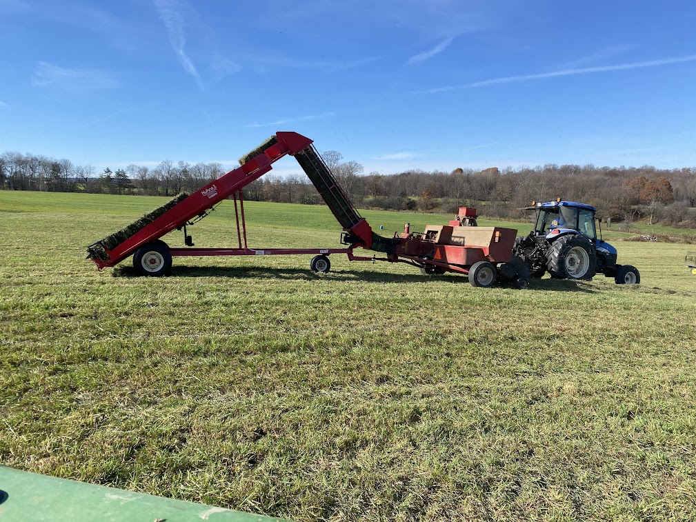

Seemed it was time to start a thread on what I do. We make small squares and round bales on approximately 250 acres. I will periodically update this thread. This past week I pulled off a couple firsts that I was not expecting. Making hay in November is not a first as we did it in 2021 and try to make it a regular event just because nobody does it and a lot of people say it can't be done. I find November hay to be some of the easiest and greenest hay to make but you have to be patient. This year's was no exception. It started with mowing and tedding in the snow on Wednesday. The goal was to get a couple freeze drying events to assist in the drying of the hay. We never really got those. Low temps were low 30's. The plan was Sunday to make a decision whether to attempt dry or make baleage. Friday at 830 in the morning tedding it for the 2nd time and the dust was coming off from it. 1030 I was raking and 1pm we started baling. If you had told me I was going to make dry hay in 2 days in November I would say your crazy but everything came together in an unusual way.

Great pictures!!!
I didn't know that you can cut hay when there is frost on it. How do you dry it out before baling?

That was snow on it. What I was hoping for was freeze drying to assist in the drying process. What I got instead was low humidity and 10mph breeze for 2 nights allowing the hay to dry down in record time.

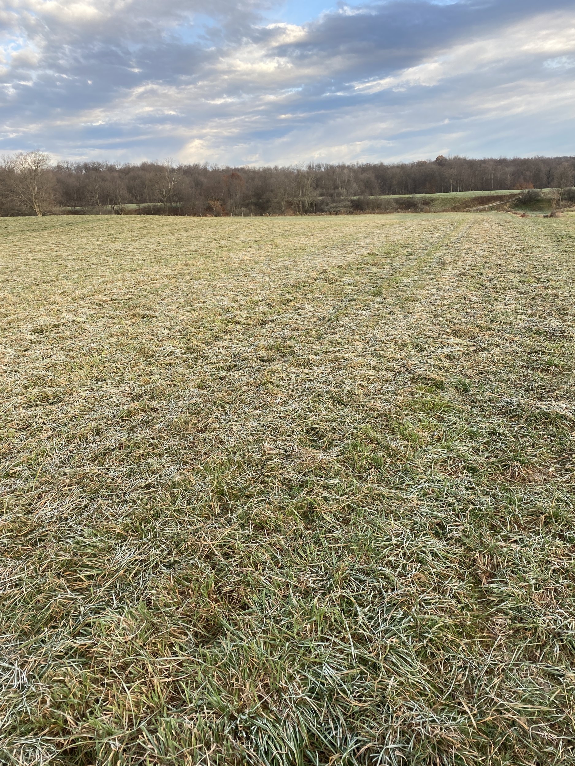

Another 11 acres down. If we bale it dry today it will make a new record. Here is a picture of freeze drying. Had temperature into the 20’s yesterday and today.

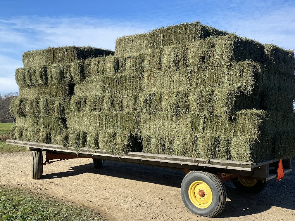

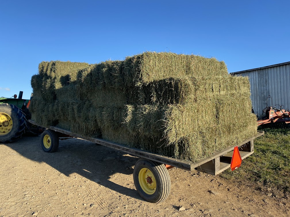

And this brings my season to an official close. 116 bales. 11/13 is now the latest I have baled dry. Had 2 days of freeze drying that I got to take advantage of. Probably the first time taking 4 cuttings dry
