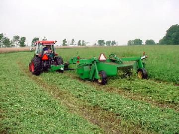

Hooked up the mower on Saturday and tried her out. Mowed a very thick timothy field in less than 20 minutes. That same field on a much less thick condition used to take me about an hour or more with my sickle bar mower. I couldn't even cut it this year with the sicklebar mower...too thick and twisted. But the disk didn't have any problems at all. So far so good!!

Now that you have the capacity to mow at faster speeds it is very important not to mow in fields that you do not know. A property marker spike, rock or just any obstacle 2" high will do damage to your mower. Do not use a disc mower to clip your pasture, use a brush hog for this. Now what are you going to do with the extra time? LOL
