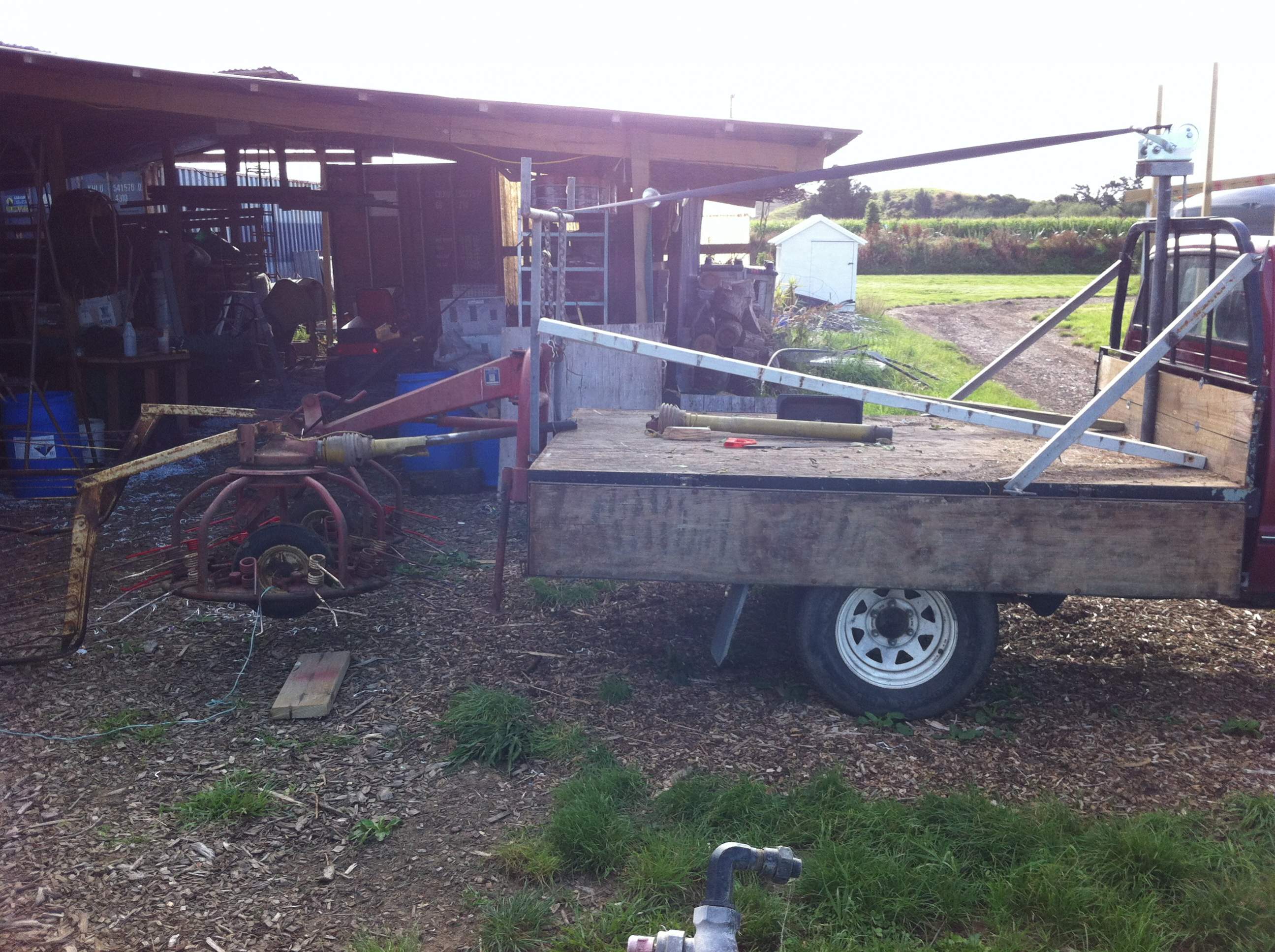

I make small bale hay for various people around the neighbourhood. It's a real hassle driving to a farm, mowing then driving back home to get my rake so I started thinking about how to be more efficient.
I thought if I could transport my rake on my ute (farm truck) then I can save on tractor travel time (save on diesel, tires, time).
The first photo shows my failed experiment to hang the rake off the back of the ute by winching it up and chaining it on. Failed miserably.

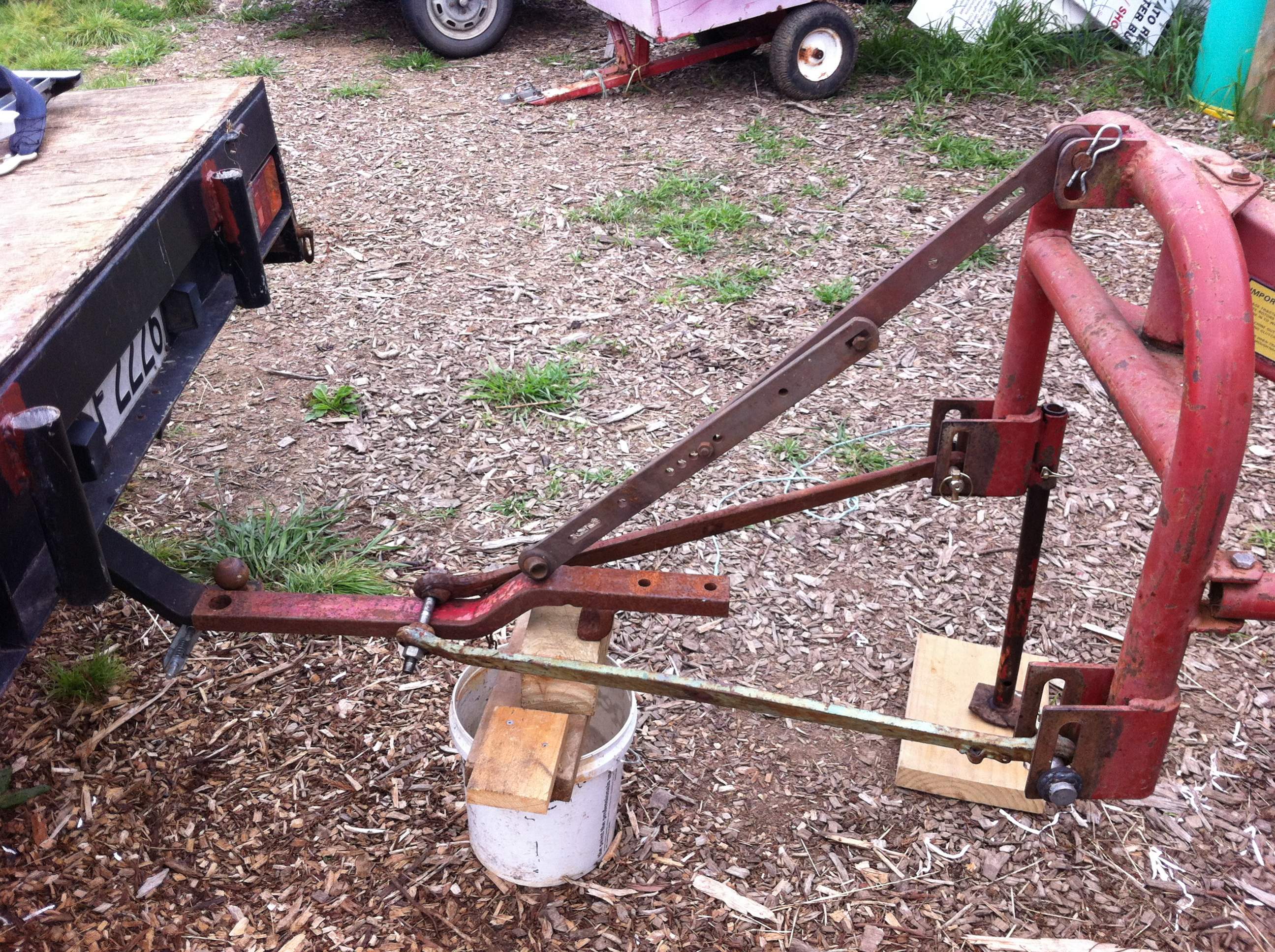

So, how about I make a rigid drawbar so I can hook the rake onto the ute tow bar and just tow it there.

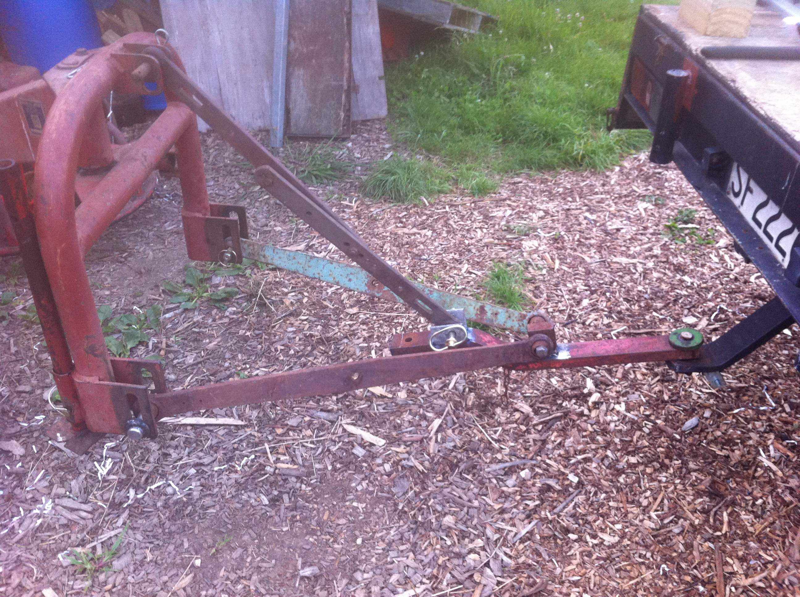

Next few photos show the mock up, the tack welded version (still a bit floppy and it was putting a lot of upward pressure on the ute drawbar which is bad for the pin holding it in place).

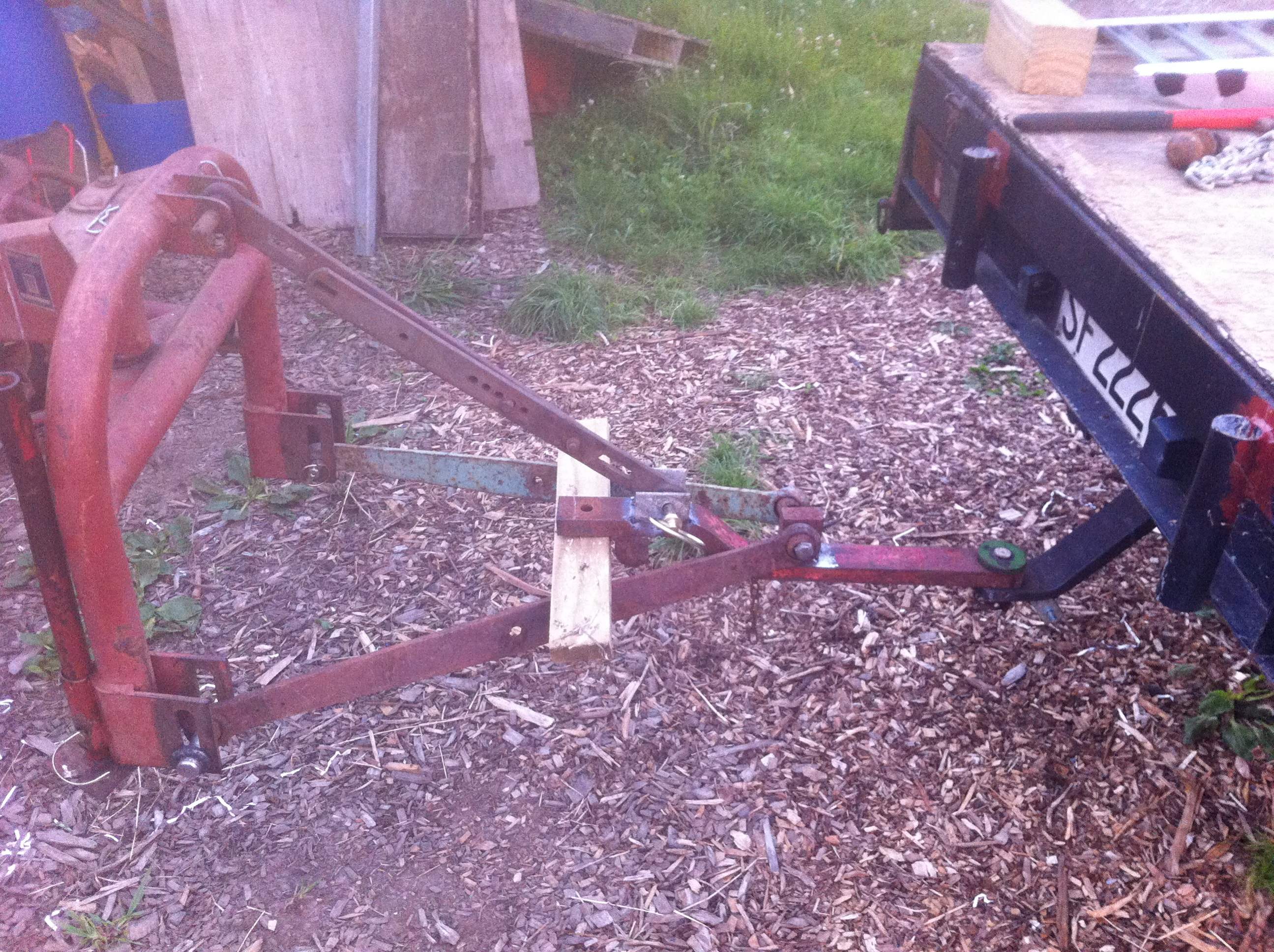

Last photo shows the additional of a piece of wood that makes the whole thing more rigid and it's now putting downward pressure on the ute drawbar.
Tomorrow I'll weld it properly, replace the wood with something better and take it for a test drive in the paddock.

Forgot to mention, it's made from 2 x plough arms off an old Fergy, a scrounged top link and an old drawbar off an International 434. The small piece of vertical steel the plough arms fit to was chopped off the end of the drawbar and the two small pieces of galvanized steel that the top link fits to were chopped off the end of some old power pylon steel angle sections.
I didn't have to drill a single hole !!
