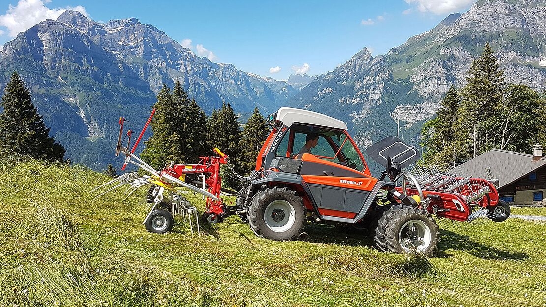

Having spent a lot of summers in the Austrian mountains these rakes are used a lot still by hillside farmers often in a setup used like the picture attached! They’re ideal for this use as when they are trying to rake every scrap of grass they’ve cut they get right right into every corner!
