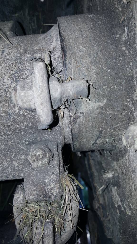

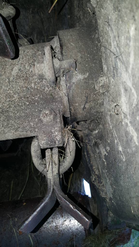

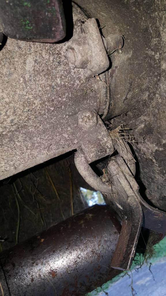

I am still brainstorming about a mechanical solution. I guess the only thing that is practical and that I would have clearance for is to weld on a spur as Thibodeau suggested. But I have changed so much, in terms of the larger knives, larger cotter pins, new bearings etc that if I have a weird vibration when I start it back up, I would like to have as few variables as possible to eliminate in terms of diagnosing the vibration. So I think that I will hold off on adding anything to the shaft for the moment. Hopefully the new knives will help a lot in reducing the chance for grass wrap.

Got my AGCO 5670 back in service today. Here are pics of the end of my JD390 rotor shaft. You can see that the end of the rotor is recessed into a collar on the end plate. The spur is simply a bolt through a tab welded to the rotor. In your case I think you could drill through the end counterweight. Since you have increased the blade mass, you will actually need a little more offset weight on the end of the rotor to compensate.
