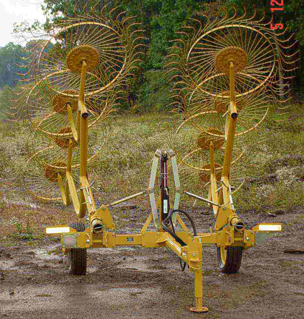

I have limited experince with the 3-point model but they look like they would be a pain to hook up. That is why I have the towed version. Its like any towed ag implement, just drop the pin in place. Its also light enough that I can move the tongue around and do not have to align the tractor up perfectly.
Here is a shot of the whole rake in storage mode.
It will not fit in my shop/garage and its a 9-10' door. If you adjust the arms you can make it just under 10' feet but then you will need to adjust it everytime you use it for the proper width.
Fred

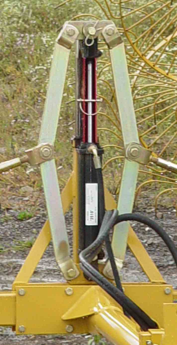

Here is a shot of the lift cylinder.
Note the red metal part. This holds the arms up when the hydraulics are not connected up to the tractor. You pull this off when you want to use it. Then just hit the hydrualic tractor controls to raise and lower as needed.
Fred
