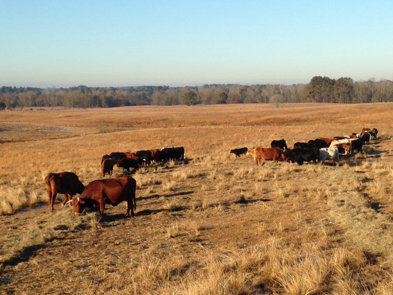

We've used rings in the past but have mostly gone to unrolling to give all the cattle a better chance to feed. The other thing we've changed is to put the bales in the corn stalks in the places that need the soil built up. We've always fed the bales in our pastures till this year, but decided to see if it will help improve the sandy parts of the crop ground.
In our situation we've usually had extra hay, but it was a little close a year ago due to the dry summer when we didn't get as much hay to put up. We also may try using cover crops to help with the soil and for the cattle to eat, but are still early in the discussion phase.
Still, the biggest advantage of unrolling the bales has been that we haven't had cattle fighting each other to feed at the same time.

Above is a link to the one we sell. Unrolling hay has major advantages, If you ever have sick, younger, slower animals in the group or even a Boss female or a Dominate male in a feeding group, You and your livestock will be well served to use a bale unroller. As a extra added benefit to "Fair and Balanced" feeding provided with a bale unroller, there is another just as important benefit from using one. We roll our grass/clover mixed hay out on areas of the fields that don't have a good stand of grass or legumes. As the cattle eat in these places, some seed gets worked back into the soil in these areas and bingo.....next growing season we have new grass. I call it no cost pasture renovation. Ken Sweet
